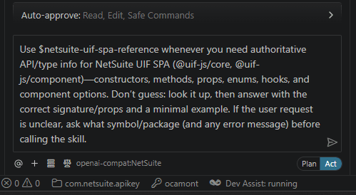

  3. Open your project and invoke your skills normally.
    Cline prompt with the netsuite-uif-spa-reference skill selected.

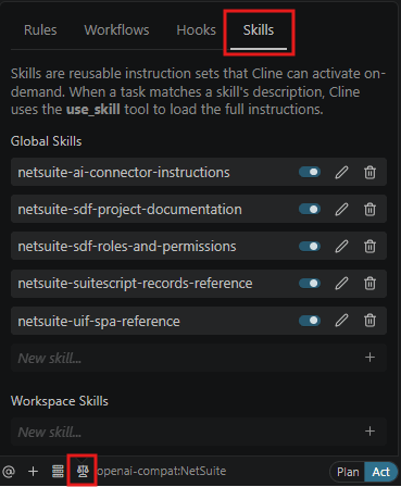

    Tip:
    To see available skills in Cline, in VS Code go to the Cline Extension > Manage Cline Rules and Workflows > Skills.
    Manage Cline Skills and Workflows with the Skills tab open
