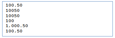

Example
Commands
${formatAmount(-100.50,"dec")}
${formatAmount(100.50,"noDec")}
${formatAmount(100.50,"decLessThan1")}
${formatAmount(-100.50,"truncDec")}
${formatAmount(-1000.50,"currency")}
${formatAmount(100.50,"dec",",")}
${formatAmount(1234.50,"currency",".")}
${formatAmount(0.50,"currency",".")}
${formatAmount(123.45,"currency",".")}
${formatAmount(1234567.89,"currency",".")}
${formatAmount(-1234567.89,"currency",".")}
Output

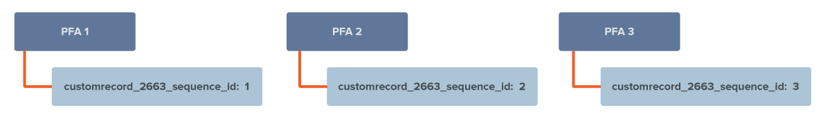

Sample PFA search results for yesterday:

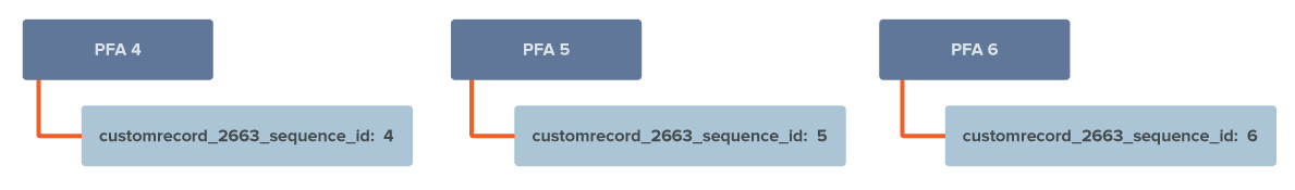

Sample PFA search results for today:
Commands
The first line gets the sequence ID for today only, and the second line gets the sequence ID covering all dates.
${getSequenceId(true)}
${getSequenceId(false)}
Output
