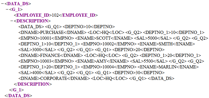

How the Data Is Returned
When you execute the query, if the CLOB column contains well-formed XML, and you select the XML data type, the data engine returns the XML data, structured within the CLOB column tag name.
Example output when data type is XML:
Note the <DESCRIPTION> element contains the XML data stored in the CLOB column, as shown below.
