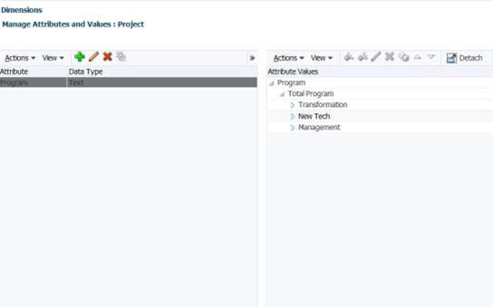

Using attribute dimensions for reporting
Using attribute dimensions for reporting can be useful to meet reporting requirements. The attribute is related to one dimension, and the relationship between the two dimension doesn’t change with time.
Example:
- Define an attribute called Program on the Project dimension.
- You can then create a hierarchy of members in the Program dimension. Top level members in the Program dimension will be automatically aggregated.
- Associate each Project member to a leaf level member in the Program dimension in an Add Project Groovy rule.
- This allows you to filter projects by program.
- Reporting forms can show program level Expenses and Revenue.
Note that using too many attribute dimensions on a form or report may degrade performance. This should be included in the performance and load testing aspects of an implementation.

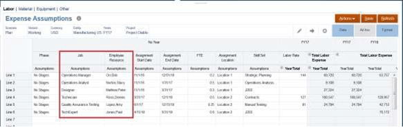

- Employee and Job are dimensions in Workforce and Smart Lists in Project Planning.
- Project Planning uses line items to plan labor expenses at the Job and Employee level.

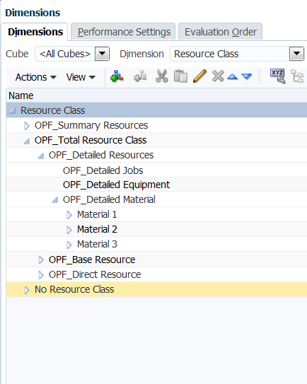

Multiple hierarchies in a dimension
You can use multiple hierarchies in a dimension. Combine two or more unrelated dimensions into a single dimension to avoid inter-dimensional irrelevance.
Example:
- Jobs, Equipment, and Material are unrelated in Projects, so they are combined into a single Resource Class dimension.
- Profit Centers and Cost Centers are unrelated in Financials, so they can be combined into a single Entity dimension.

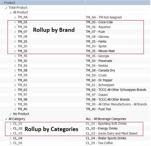

Alternate hierarchies for planning and reporting
Use alternate hierarchies when the same members can be grouped under different parents for top-down allocation or reporting purposes.
Example: Create alternate rollups in the Product dimension for planning and reporting by the Brand and Product categories.
