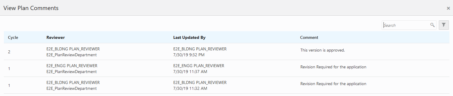

Viewing All Plan Review Comments
Plan coordinators and plan reviewers can view all comments entered for all cycles of a plan review on the Plan Reviews page.
Select Permits on the Agency Springboard.
On the Permits page, select a permit record with a status of Plan Review.
In the navigation panel, select .
On the Plan Reviews page, click the View Plan Comments link.
This example shows the View Plan Comments page for a manual review.
The View Plan Comments page displays all of the comments entered for a plan review by all participants during every review cycle. The comments listed on this page are searchable and filterable.

Adding an Electronic Plan Review Decision
As a plan reviewer, you can add your plan review decision on the Plan Reviewer Decision Details page in the permit details pages. You can modify your decision until the plan review cycle is completed or canceled, but you cannot modify your decision if the plan coordinator overrides your decision.
The system derives the overall plan review status from the individual plan reviewer decisions, and updates the overall plan review with the most severe decision status. The system-defined decision statuses are listed here from most to least severe: Rejected, Revision Required, Approved with Comments, Approved, and Not Required. If plans have one or more rejections, or revisions are required, the plan coordinator may require the applicant to correct the plans and resubmit them for another review cycle.
In the Documents grid, expand the row for the document you want to review.
Click the View More Details button for your row.
On the Plan Reviewer Decision Details page, select a value from the Decision list.
You can select from these system-defined decision statuses:
Approved
Revision Required
Rejected
Not Required
The decision status names in the Decision list may not match the system status names, because displayed statuses can be modified by the agency. For example, if the agency changes the displayed status of Rejected, you might see Declined or Failed. However, the severity of the decision remains the same. Any displayed status associated with the system status Rejected, for example, is always calculated as the most severe status.
Click Add Comments to enter comments for your review.
You can’t edit comments once the plan review cycle or permit is closed or canceled.
Click the Save button.
The system displays the selected decision in the Decision field and populates the Decision Date field with a timestamp. In addition, once all reviewers have entered a decision for a document, the system updates the State field for the document with the most severe decision status selected by the reviewers.
