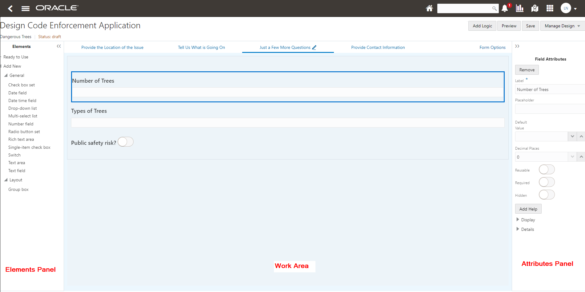

Elements panel
Displays the list of user-defined elements you can add to your form design, such as the fields you can add to your form by dragging and dropping into the drop zone on selected pages.
Note: The elements within the Ready to Use node are not intended to be added to your intake forms manually. They have already been added by way of the underlying template. For Code Enforcement, the Ready to Use node is intended to be used by internal Oracle development teams.
Workspace
This is the main area displaying page tabs and drop zones used for configuring your forms.
Attributes panel
Displays the available attributes that you can configure for the currently selected form element. For example, if you have a field selected, the attributes panel reads "Field Attributes,” and it contains attributes specific to fields. If you have a group box selected, the attributes panel reads "Group Box Attributes,” and it contains attributes specific to group boxes.

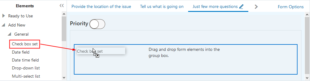

You can drag and drop these form elements into a drop zone:
  • User-defined fields
  • Group boxes
This example illustrates dragging and dropping a user-defined field type from the Elements panel into the drop zone.
Dragging and dropping a field into the drop zone

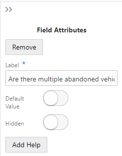

  6. Select the switch, and observe the attributes you can configure for that field in the Field Attributes panel on the right.
  7. Update the Label value.
    For example Are there multiple abandoned vehicles on the property?
    This example illustrates setting the label attribute.
    Example: Updating a user-defined field label attribute

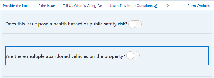

This example illustrates a user-defined field added to the drop zone of an issue subtype form layout.
Example: field added to issue form
