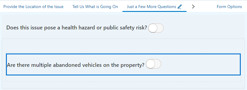

Example: Adding User-Defined Fields to an Intake Form for an Issue Subtype
While the default intake form based on the underlying template is ready to be used without any changes, this section illustrates how you can add user-defined fields to the drop zone if you need to capture additional information.
This example creates an intake form for an issue subtype that enables public users to report an issue for an abandoned vehicle. Assume that the code enforcement organization wants to capture all of the information in the default intake form and also a user-defined field to indicate if there are multiple vehicles on the property.
To create an intake form for an issue subtype:
  1. Ensure a valid issue and issue subtype exist.
    You create issue types and issue subtypes separately.
    For more information see Setting Up Issue Types and Setting Up Issue Subtypes.
  2. While on the Issue Subtype page, make sure your issue subtype is saved and click Design Form.
  3. In the Intake Form Designer, locate the page tab with the drop zone.
    This example illustrates the pencil icon on a page tab, which indicates which tab(s) a drop zone resides where you can add custom fields.
    Pencil icon indicating the tab you can customize for Code Enforcement intake form designer.
  4. Expand the Add New list in the Elements panel.
  5. In the General list, select Switch, and drag and drop it in the drop zone.
    This example illustrates dragging and dropping a field type into the drop zone.
    Example: dropping a user-defined field in the drop zone
  6. Select the switch, and observe the attributes you can configure for that field in the Field Attributes panel on the right.
  7. Update the Label value.
    For example Are there multiple abandoned vehicles on the property?
    This example illustrates setting the label attribute.
    Example: Updating a user-defined field label attribute
  8. Click Save.
Result:
This example illustrates a user-defined field added to the drop zone of an issue subtype form layout.
Example: field added to issue form
