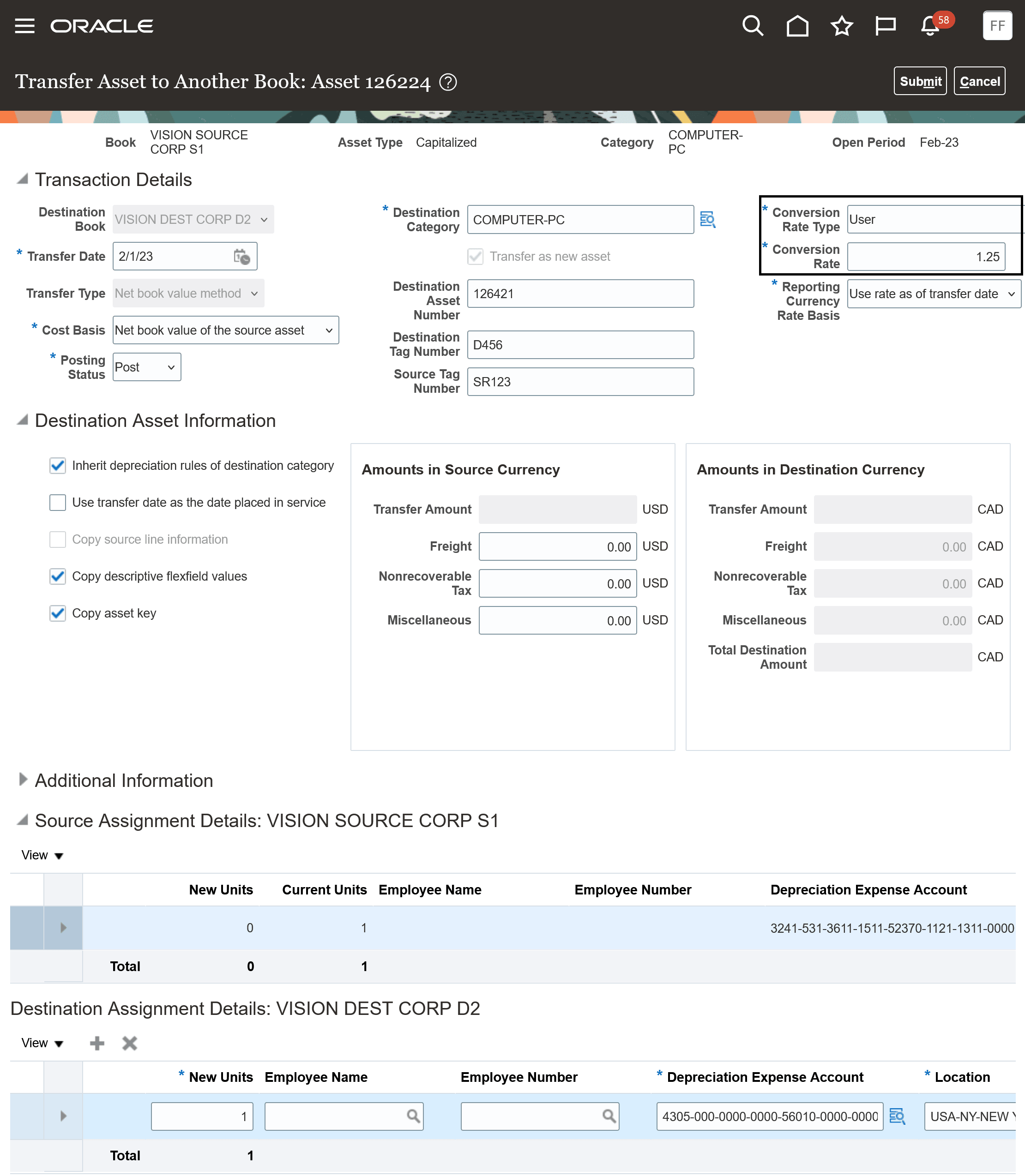

During the transfer, you can use the following cost basis types to determine the cost and accumulated depreciation in the destination book.
  • Cost and reserve of the source asset: The destination asset balances are initialized with the cost and reserve amount of the source asset.
  • Net book value of the source asset: The destination asset cost is initialized with the net book value of the source asset. The depreciation reserve is initialized to zero.
  • Transfer amount: The destination asset cost is initialized with a user-entered transfer amount. The depreciation reserve is initialized to zero.

When transferring an asset between primary books with different currencies, you must provide a currency conversion rate to convert the amount from the source book’s currency to the destination book’s currency.
  •  Conversion Rate Type: Select a rate type defined in General Ledger.
  •  Conversion Rate: Enter a rate if the rate type is User.

Transfer asset to another book

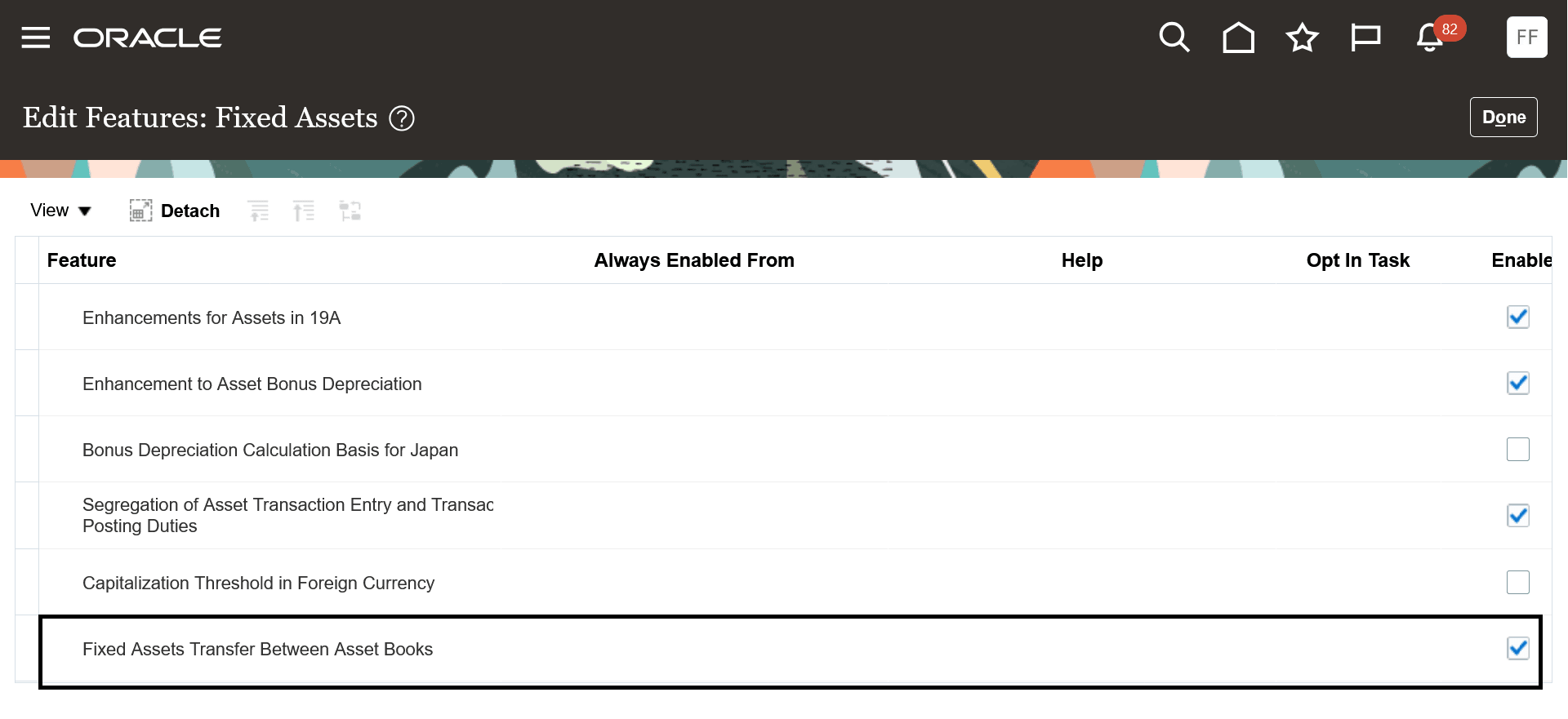

Use the Opt In UI to enable this feature. For instructions, refer to the Optional Uptake of New Features section of this document.
Offering: Financials  No Longer Optional From: Update 26A
Use the opt-in for Fixed Assets Transfer Between Asset Books in Financials to enable this feature. From release 26A the feature will be no longer optional to enable.
  • Use the opt-in for Fixed Assets Transfer Between Asset Books in Financials to enable this feature.
  • Setup and Maintenance > Financials > Change Feature Opt In > Fixed Assets> Edit Feature > Fixed Assets Transfer Between Asset Books feature in Financials.
Opt in

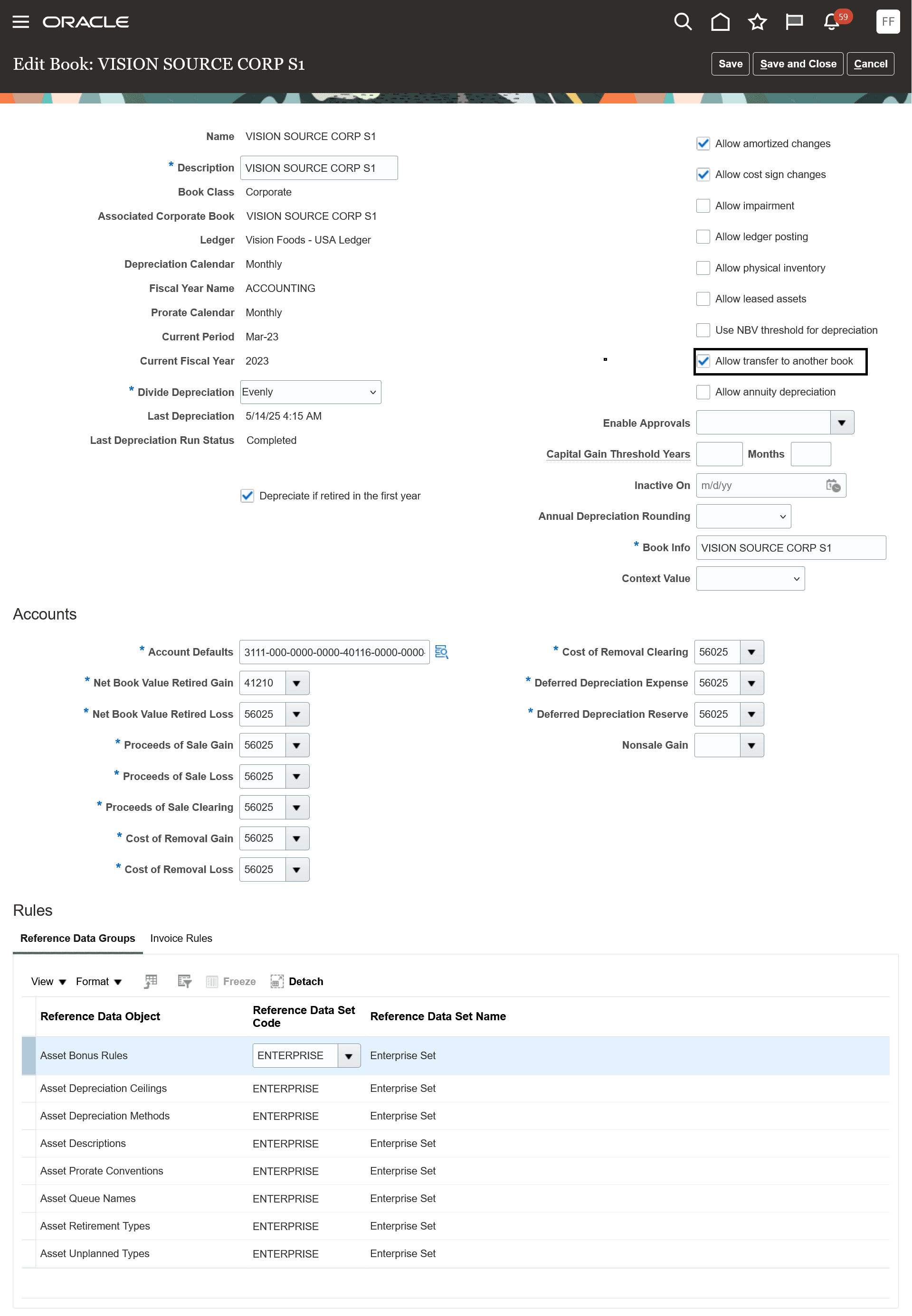

Setup and Maintenance-> Manage Asset Books ->  Enable the ' Allow transfer to another book' option
Asset transfer to another book

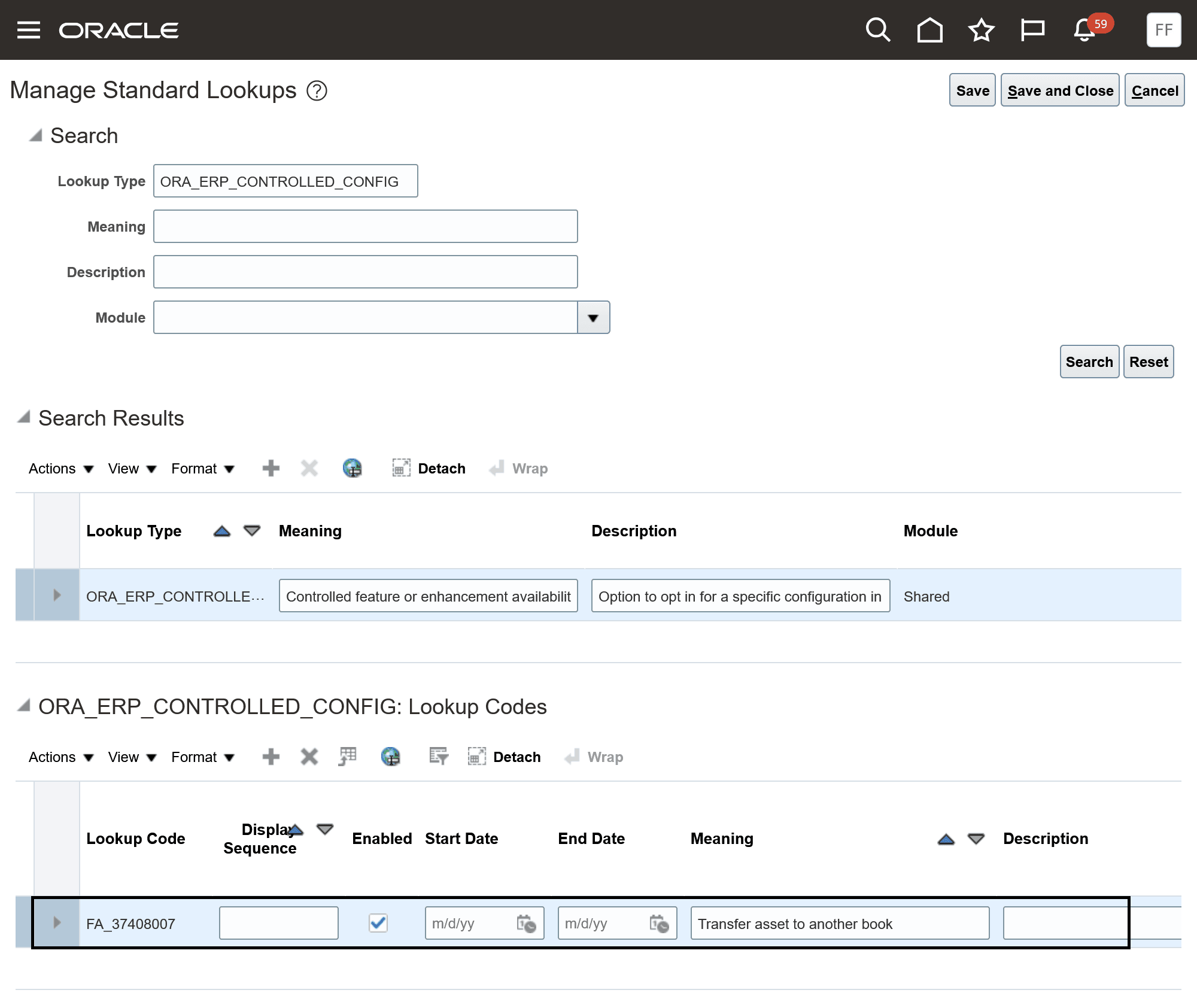

Enable the lookup to transfer asset across ledgers
  • In Setup and Maintenance, search and go to the  "Manage Standard Lookups" task.
  • Search for the lookup type - 'ORA_ERP_CONTROLLED_CONFIG'.
  • Enter "FA_37408007" as the lookup code.
