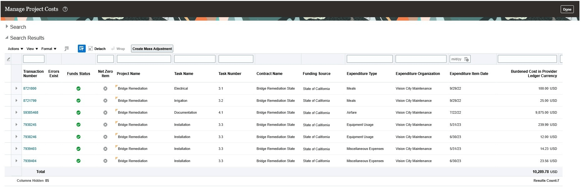

To perform this action, query the costs you want redistributed using the sponsored project funding pattern.
Manage Project Costs

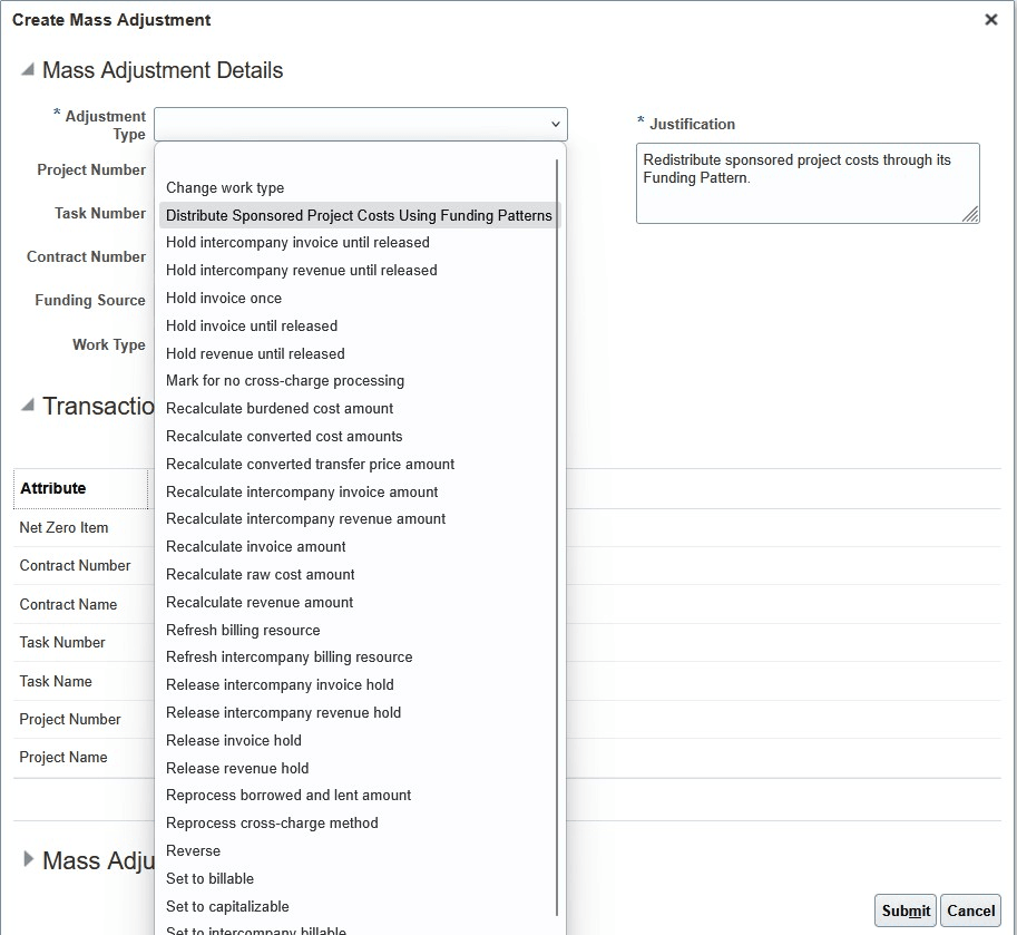

Then select the new adjustment type of Distribute Sponsored Project Costs Using Funding Patterns.
Create Mass Adjustments
The business benefit of this adjustment is that it provides enhanced accuracy and timeliness in processing sponsored project costs. It accommodates updates to business rules or funding conditions that impact funding patterns, thereby removing the need for manual reversals of existing project costs and subsequent new project cost creations.
