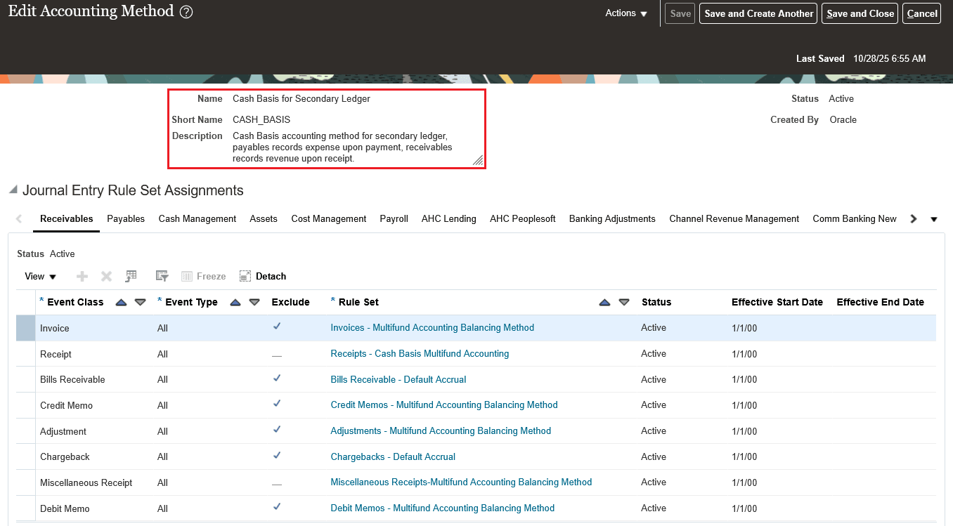

Cash Basis for Secondary Ledger Cash Basis accounting method for secondary ledger, payables records expense upon payment, receivables records revenue upon receipt.
This feature provides a standardized approach to recognizing expenses in Payables upon payment and revenue in Receivables upon receipt, focusing on true cash movement rather than accrual timing. Designed specifically for use with secondary ledgers only, the accounting method ensures that reporting needs for public sector and other applicable customers are met efficiently and accurately. For customers who require cash basis accounting in their primary ledger, the recommended practice is to implement the clearing account approach, as detailed in the updated Cash Basis Accounting White Paper, to maintain compliance and auditability.
NOTE: The Cash Basis for Secondary Ledger accounting method leverages the 25D feature - Accounting Event Exclusion for Adjustment-Only Accounting Method Representation to exclude specific transaction events from accounting based on cash basis accounting conventions. So, enabling this feature is a pre-requisite to uptake cash basis in secondary ledgers, refer the release documentation for steps to enable the feature.
Cash Basis for Secondary Ledger Accounting Method
Cash Basis Accounting Method

  • You must ensure that you associate the Cash Basis for Secondary Ledger accounting method to a secondary ledger only.
  • Associating this accounting method to a primary ledger can have serious downstream impacts. For example, it may create incompatibility with certain subledgers, such as Project Management, especially when Payables Invoice or Cost/Receipt accounting events are excluded from accounting.
