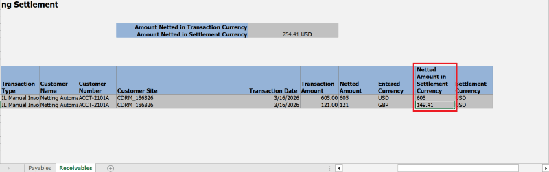

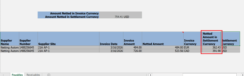

Previously, netting was restricted to Payables and Receivables in the same currency. With this update, you can include transactions with differing currencies in a single netting settlement. All selected Payables and Receivables are converted to a designated settlement currency using defined cross-currency conversion rates.

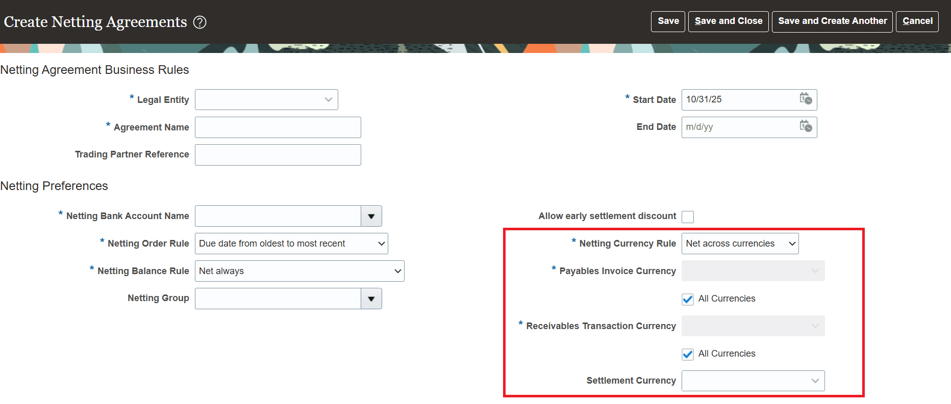

  1. Navigate to the Create Netting Agreements page. Create a netting agreement with the Netting Currency Rule as "Net across currencies".
Netting Agreement Setup

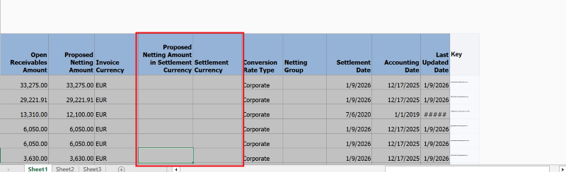

  1. Choose a settlement currency. This is the currency in which the amounts would be settled.
  2. Choose "All Currencies" or a specific currency for the Payables Invoice Currency and Receivables Transaction Currency. This selection determines the invoices and transactions that are selected for netting.
Tips And Considerations
  • The payment currency of the Payables invoices must match the settlement currency of the netting agreement for the invoice to be selected.
  • All the conversion rates must be defined prior to running the netting settlement. These include the cross-currency conversion rates and payment conversion rates.
  • You can't update the amounts for a cross-currency settlement at the review stage.
