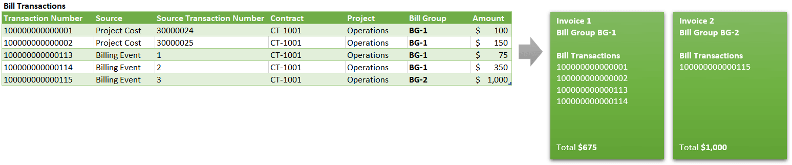

1. Manage the bill group attribute directly on bill transactions:
An example showing bill transactions tagged with the same bill group being invoiced together.

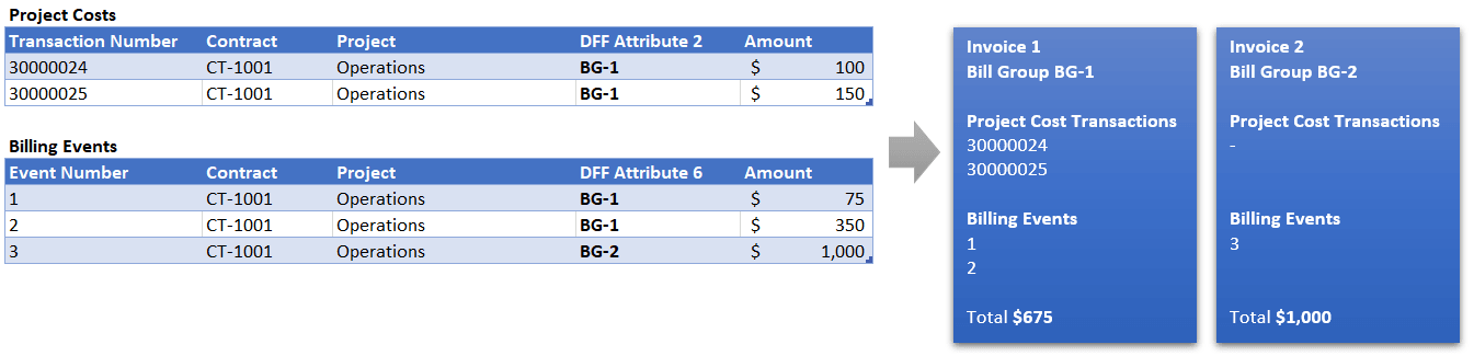

2. Manage the bill group attribute indirectly using nominated descriptive flexfield segments on project costs and/or billing events:
An example showing project costs and billing events tagged with the same flexfield value being invoiced together.

Worked example 1 - Manage the bill group attribute directly on bill transactions
Programmatically set the bill group on bill transactions (arising from billable project costs or billing events) using file-based data import, where business logic outside of Fusion determines the bill group. This approach requires the Bill Transaction Creation on Cost Import feature to be opted in.
High-level steps:
  1. Ensure the Bill Transaction Creation on Cost Import feature is opted in. Please consult the related What's New content for other changes in application behavior when enabling this opt-in, such as the disablement of partial billing when hard limits are reached.
  2. Leverage the new Import Project Contract Bill Transactions file-based data import (FBDI) template to build an integrated solution that updates unbilled transactions with bill groups according to your own business logic.
  3. Run the Generate Invoices process as normal. Invoices will be generated according to existing built-in grouping logic (such as invoicing by contract and bill set) plus the new bill transaction bill group attribute.
  4. Optionally enable the new Bill group required for invoicing contract type option. Use this control if your business process requires the bill group attribute to be set for all bill transactions.
    1. With this option enabled, any transactions which do not have a bill group set will raise an exception during invoice generation.
    2. With this option disabled, any bill transactions without the bill group attribute set will be invoiced together.
  5. Review bill group values using the Project Billing - Bill Transactions Real Time subject area in Oracle Transactional Business Intelligence (OTBI).
  6. Note, this approach only applies to external billing, as the Bill Transaction Creation on Cost Import feature only creates bill transactions for external billing.
Worked example 2 - Manage the bill group attribute indirectly using nominated descriptive flexfield segments on project costs and/or billing events
Define a descriptive flexfield segment on project costs and/or billing events, and nominate them as a proxy for the bill group.
This option assumes that the Bill Transaction Creation on Cost Import feature is not yet opted in, so business process flows are agnostic of the bill transaction business object. This route may be of particular benefit where an existing integrated billing solution has the capacity to determine which billing events and/or project costs should be invoiced together. In such a scenario, tagging source transactions with a proxy for the bill group may be simpler than reconfiguring the integration to update bill transactions.
High-level steps:
  1. Define a descriptive flexfield segment on project costs* and/or billing events to be used as a proxy for bill group. Make a note of the attribute column selected, such as "ATTRIBUTE6" or "USER_DEF_ATTRIBUTE1".
  2. Set the following profile options at site level to instruct the application to use these segments as a proxy for bill group when invoices are generated. Navigate to Setup and Maintenance > Manage Administrator Profile Values. Search for the new profiles by name (or code):
    1. Map Project Costing DFF Column to Bill Transaction Bill Group (ORA_PJB_EI_DFF_BILL_GROUP_MAP)
    2. Map Billing Events DFF Column to Bill Transaction Bill Group (ORA_PJB_EVENT_DFF_BILL_GROUP_MAP)
  3. Prior to invoicing, set the value for the flexfield segments during transaction entry or through subsequent update.
  4. Run the Generate Invoices process as normal. Invoices will be generated according to existing built-in grouping logic (such as invoicing by contract and bill set) plus the value specified in the nominated flexfield segments.
  5. Optionally enable the new Bill group required for invoicing contract type option. Use this control if your business process requires the bill group attribute to be set for all bill transactions.
  6. Note, this approach applies for all billing types; external, intercompany, and interproject.
*Attributes from the Descriptive Flexfield or the Project Standard Cost Collection Flexfield can be used.
