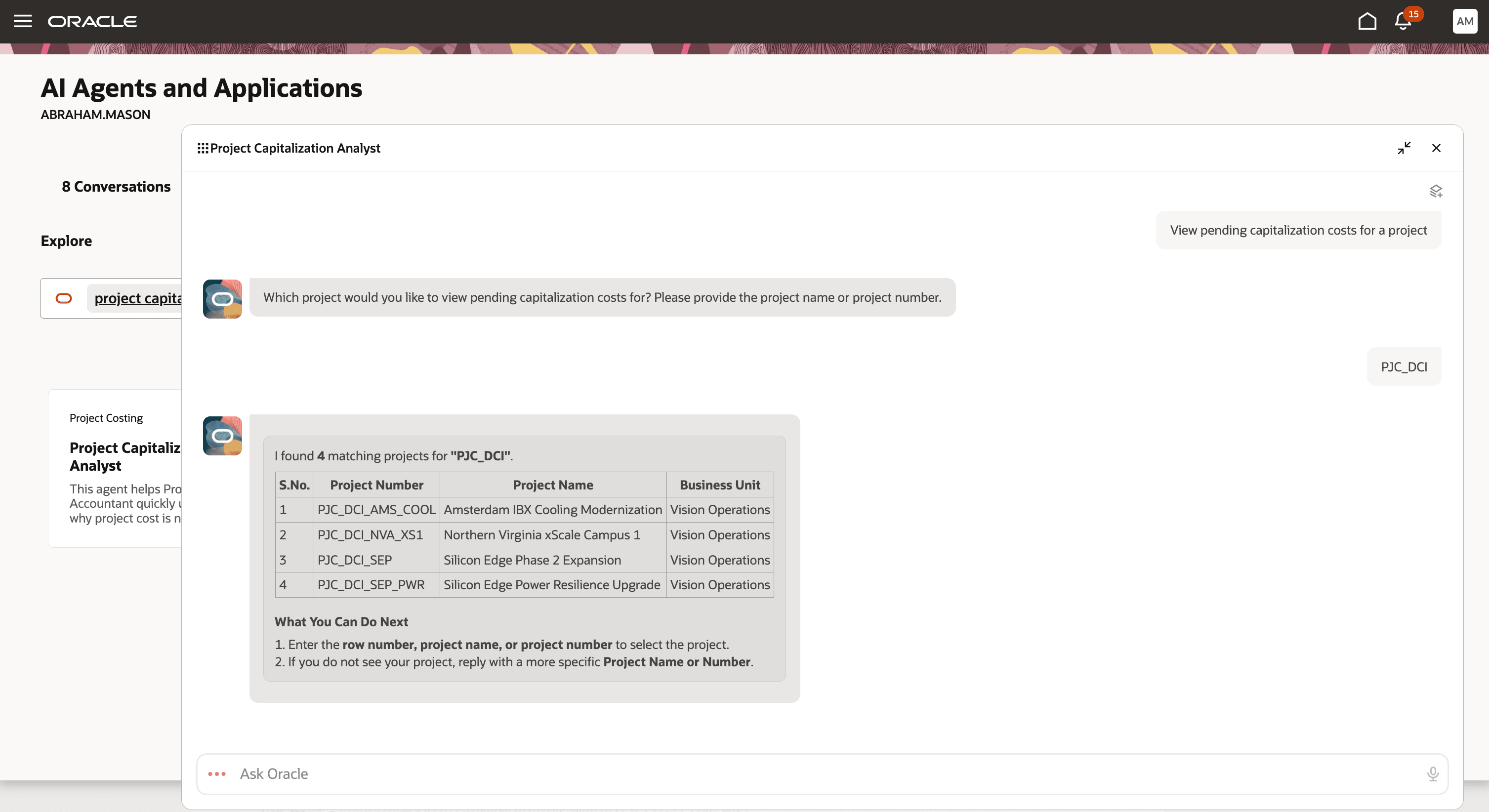

The accountant opens the analyst and asks to see pending capitalization costs for a project. The analyst asks which project to review. The accountant enters a partial project identifier, such as PJC_DCI. The analyst finds matching digital infrastructure projects, and the accountant selects selects PJC_DCI_SEP, Silicon Edge Phase 2 Expansion.
Selecting the correct project from matching results
The analyst asks the project accountant which project they want to review. The accountant enters a partial project identifier, such as PJC_DCI. The analyst finds matching digital infrastructure projects, and the accountant selects Silicon Edge Phase 2 Expansion (project PJC_DCI_SEP).

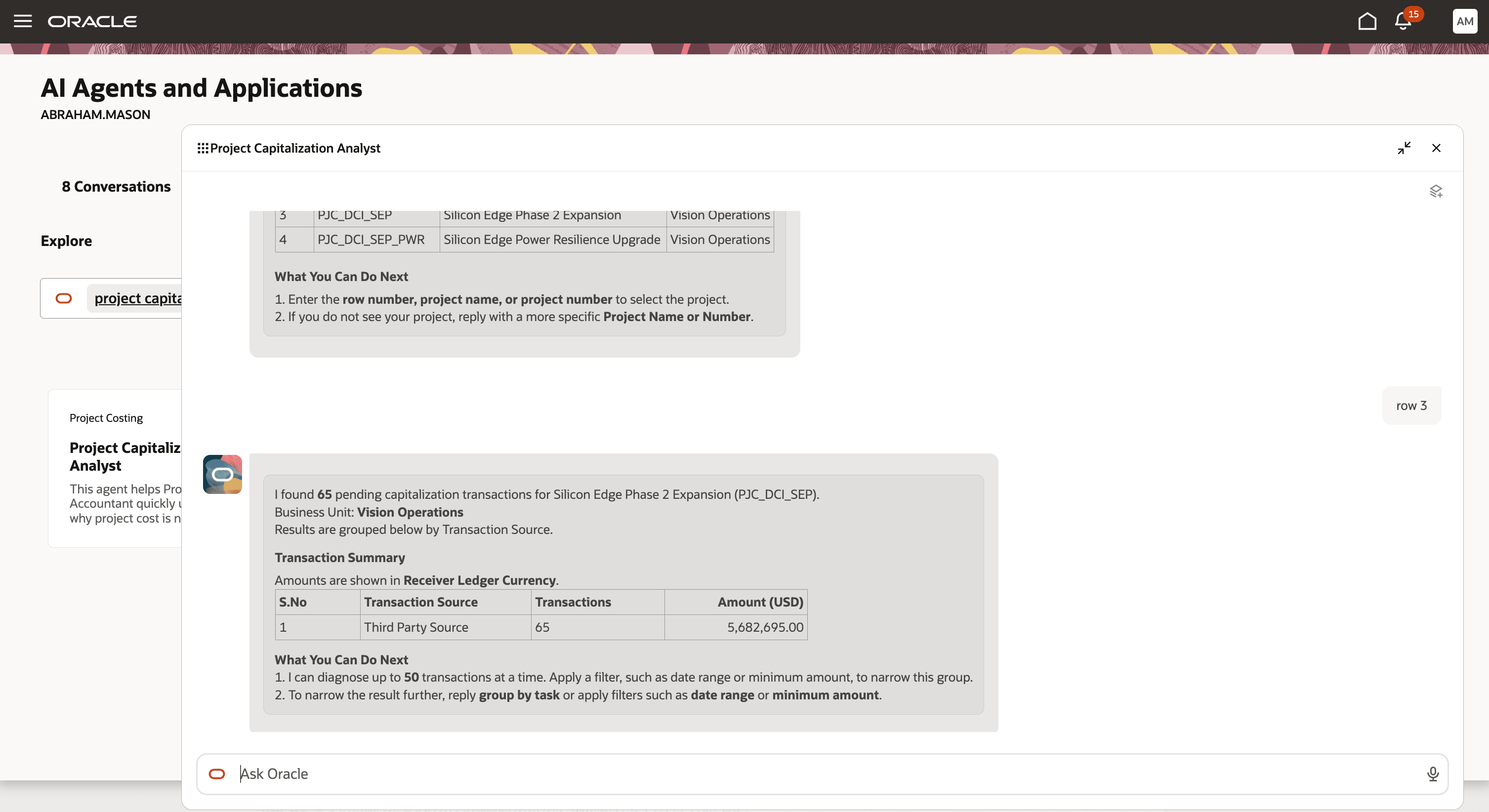

Reviewing pending capitalization costs grouped by transaction source

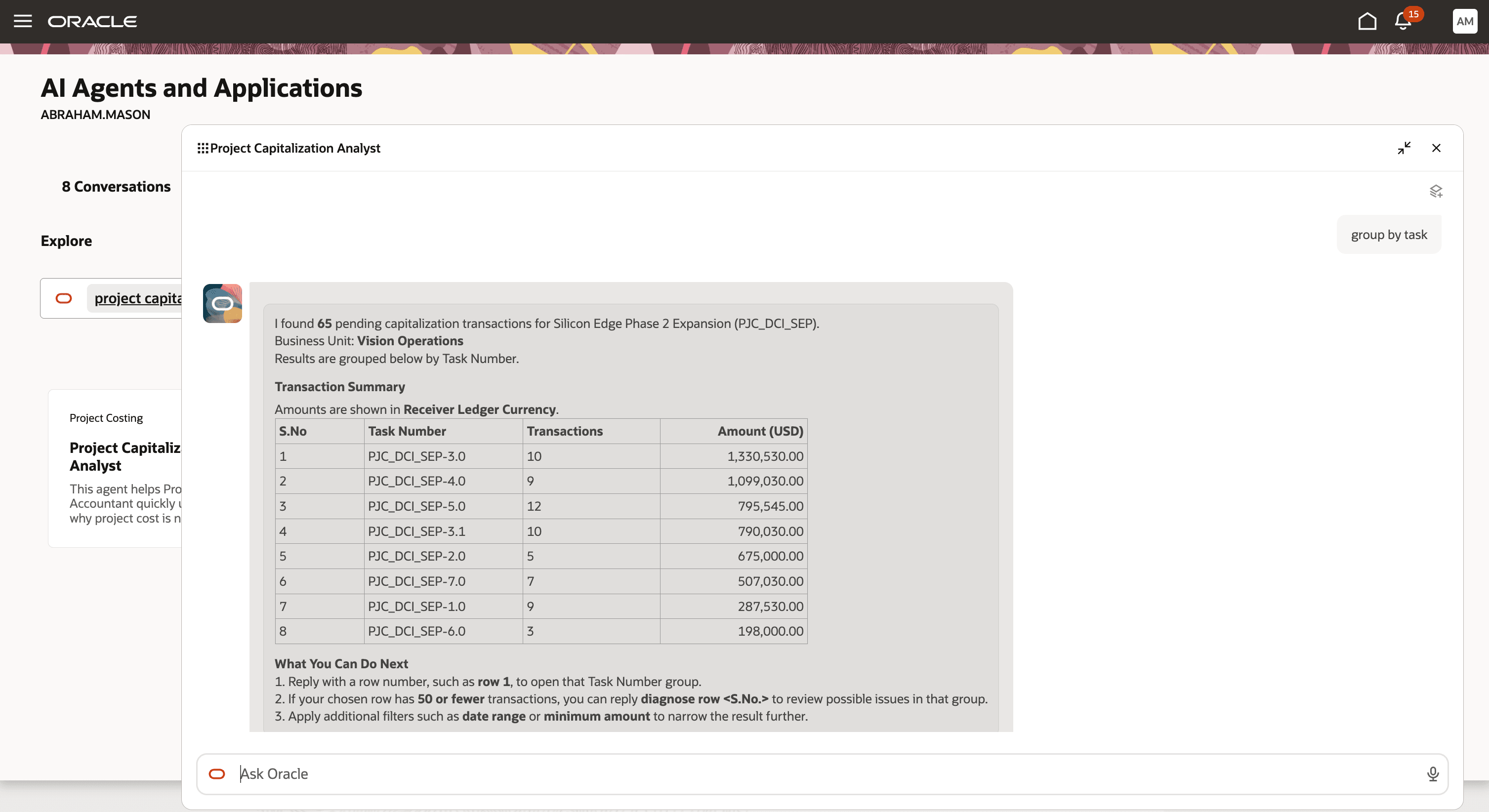

Because the result set has more than 50 transactions, the accountant refines the results by grouping the pending costs by task.
Grouping pending capitalization costs by task

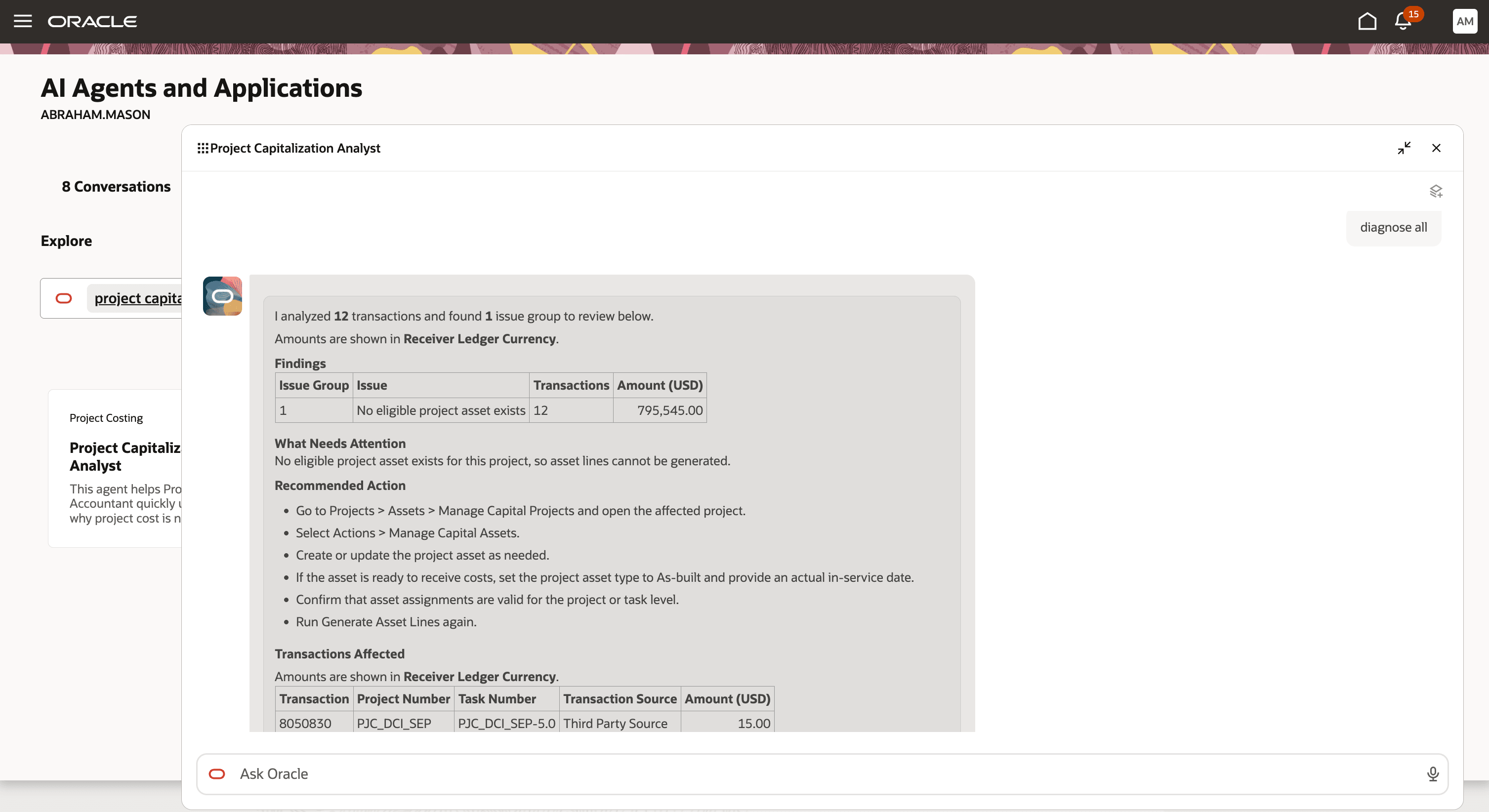

The accountant drills into task PJC_DCI_SEP-5.0, Network and Interconnection Fit-Out, and asks the analyst to diagnose the displayed transactions. The analyst identifies the current blocking reason: No eligible project asset exists. It recommends reviewing the project asset setup and assignment, setting the asset to as-built when ready, providing the in-service date, and running Generate Asset Lines again.
Diagnosing a task group with no eligible project asset
