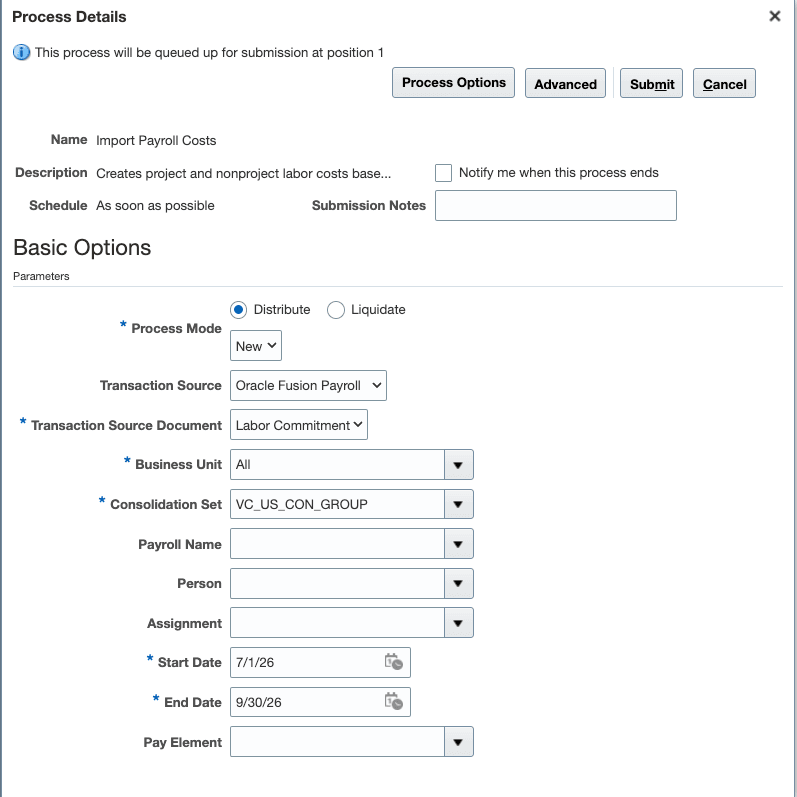

Use the Import Payroll Costs process to import future first-party payroll encumbrances as project labor commitments for a selected payroll period or many periods.

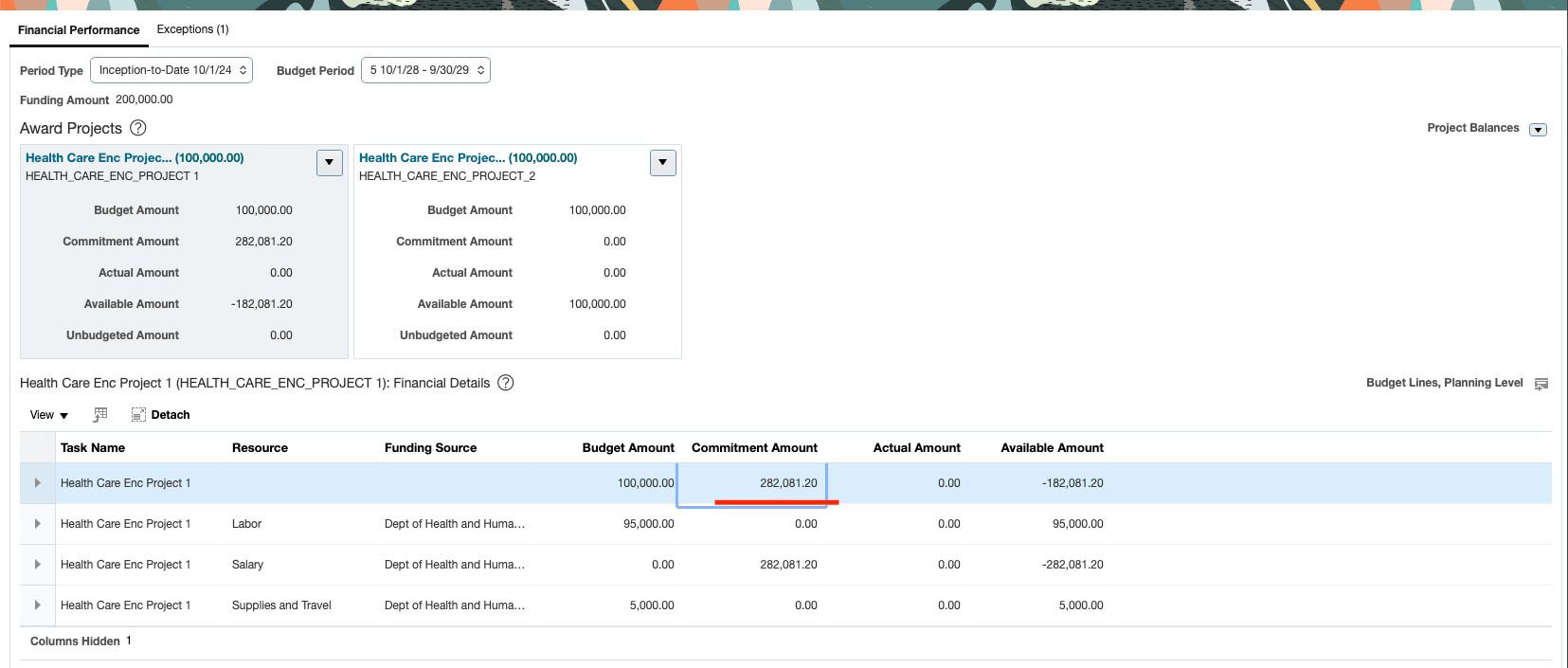

Review the imported commitments in Manage Labor Costs, Manage Project Commitments, and Award Overview.
Award Overview example

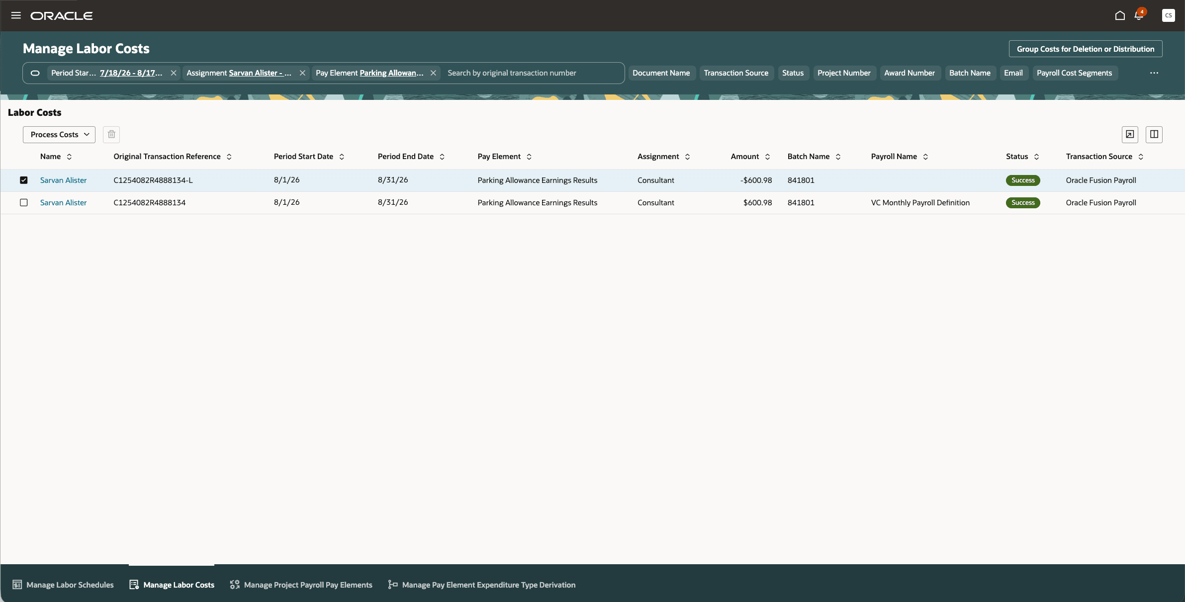

When matching payroll actuals are imported, the existing project commitments are liquidated automatically.
Liquidated labor cost
You can also liquidate commitments manually by period or project when commitments must be removed, such as before a project closes. This is done, by running the Import Payroll Costs process using the Liquidate option.

Run Import Payroll Costs with the applicable transaction source, document, distribution option, and payroll-period dates.
