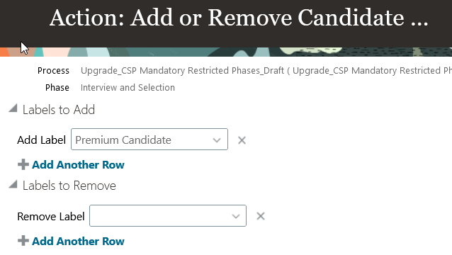

Let’s say you want to add the Premium Candidate label when top candidates leave the Interview and Selection phase.
  1. In the Setup and Maintenance work area, go to:
  • Offering: Recruiting and Candidate Experience
  • Functional Area: Candidate Job Applications
  • Task: Candidate Selection Process Configuration
  1. On the Candidate Selection Process Configuration page, create a candidate selection process or edit an existing one.
  2. Click on the Interview and Selection phase.
  3. In the Phase Actions section, click When Leaving Phase > Add Action > Add or Remove Candidate Labels.
  4. On the Action: Add or Remove Candidate Labels page, in the Labels to Add section, add the label Premium Candidate.
  5. Click Continue.
Image showing the Labels to Add section in a candidate selection process.
Adding a Label to a Candidate Selection Process
