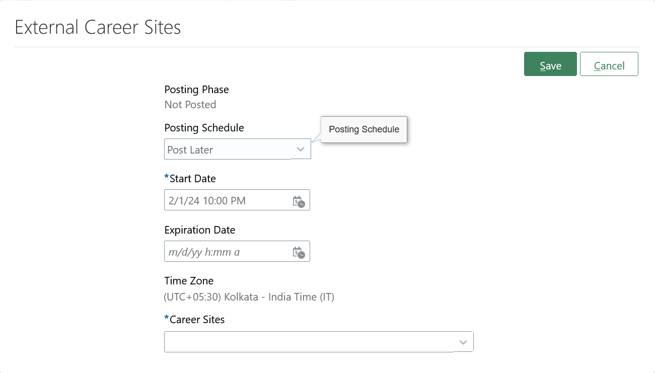

There's a new option in the Posting Schedule drop-down list: Post Later.
Post Later
Post Later
When you select it additional fields display:
  • Start Date - indicates the date you want to post the event.
  • Expiration Date - indicates the date you want to unpost the event.
  • Time Zone (Read only field that contains the Event Time Zone value)
