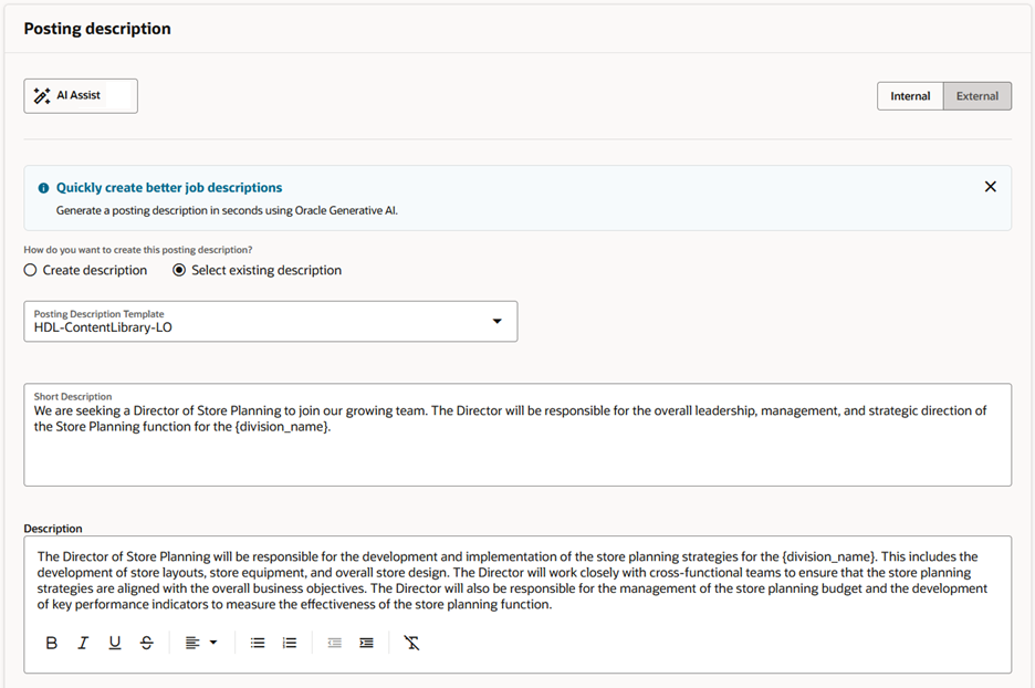

A new feature is introduced in the Redwood requisition details page to help recruiting users create the posting description based on the job requisition title using generative AI capabilities. This capability is available only in the Redwood experience.
  • Users can click the AI Assist button to populate these four posting description fields: Short Description, Description, Responsibilities, Qualifications.
  • Users can regenerate the content of the posting description fields if they’re not satisfied with the content in the first attempt.
  • By default, this feature is disabled. Customers need to access VB Studio to enable this feature.
Image showing the AI Assist button for the Job Requisition Posting Description
AI Assist for the Job Requisition Posting Description
