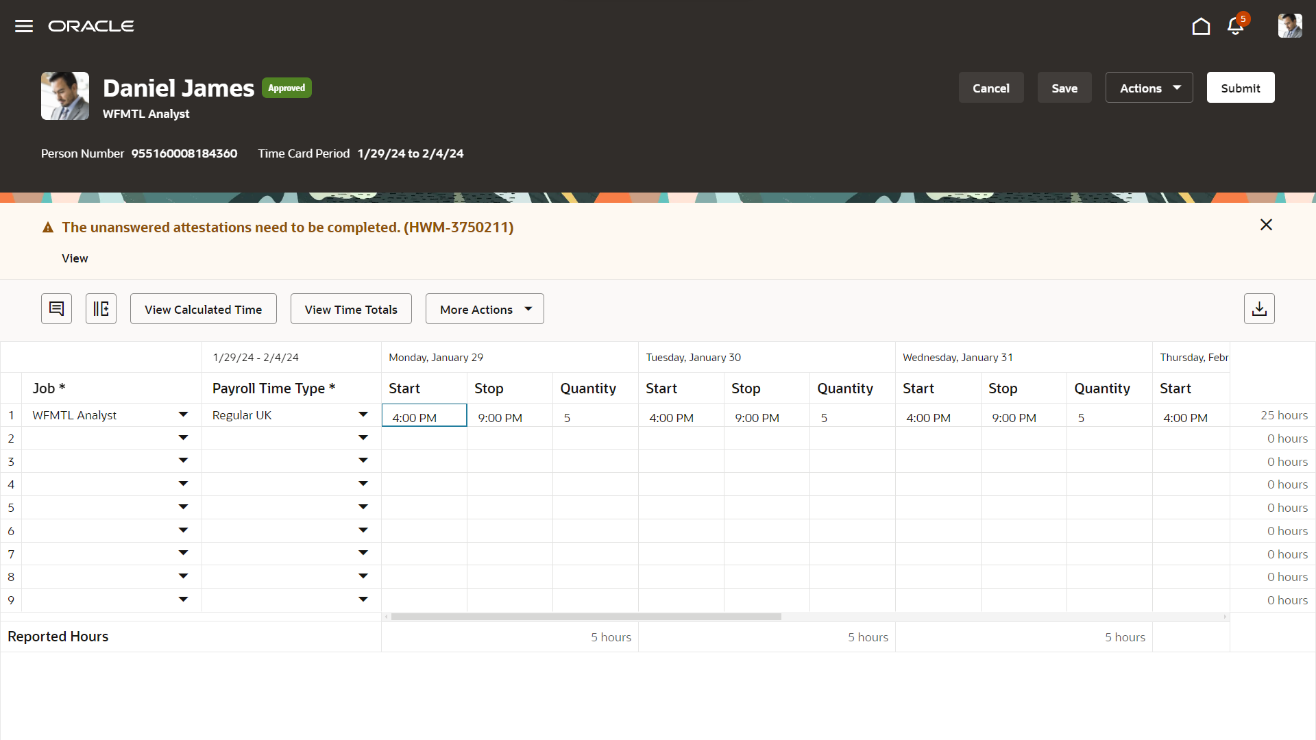

Managers can now save, submit and approve time cards without having to wait for workers to submit pending attestations. Any unanswered attestations remain pending on the time card until the worker submits it. And workers still can't submit time cards with pending attestations.
Time Card That Was Approved with a Pending Attestation
This enhancement improves the time card approval processing.
