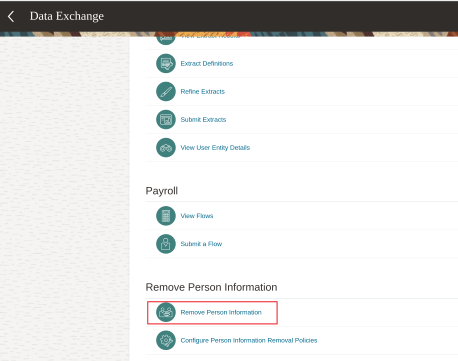

Data Exchange Page Showing the Remove Person Information Task
