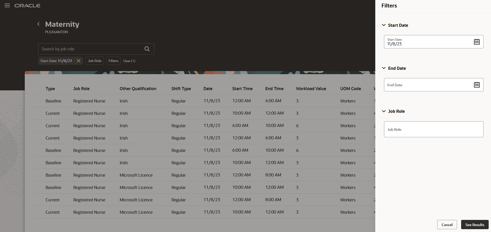

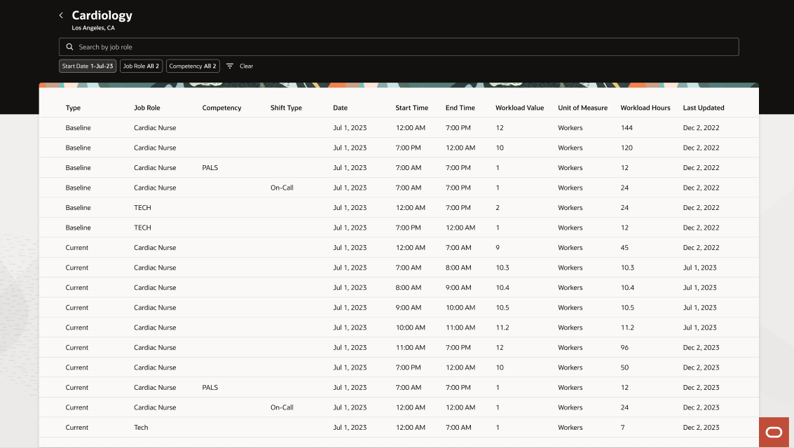

As a schedule manager, you can now review the detailed workload requirements on the new read-only workload management page. You can see the consolidated workload data for the baseline and current real-time workload requirements for each job, competency, and shift type. For more focused review, you can filter by job role.
Example Read-Only Workload Management Page
When you open the workload management page, the date defaults to the current date. You can use Filters and select start and end dates to show up to one week of results.
Example Read-Only Workload Management Page Showing the Filters Panel Drawer
