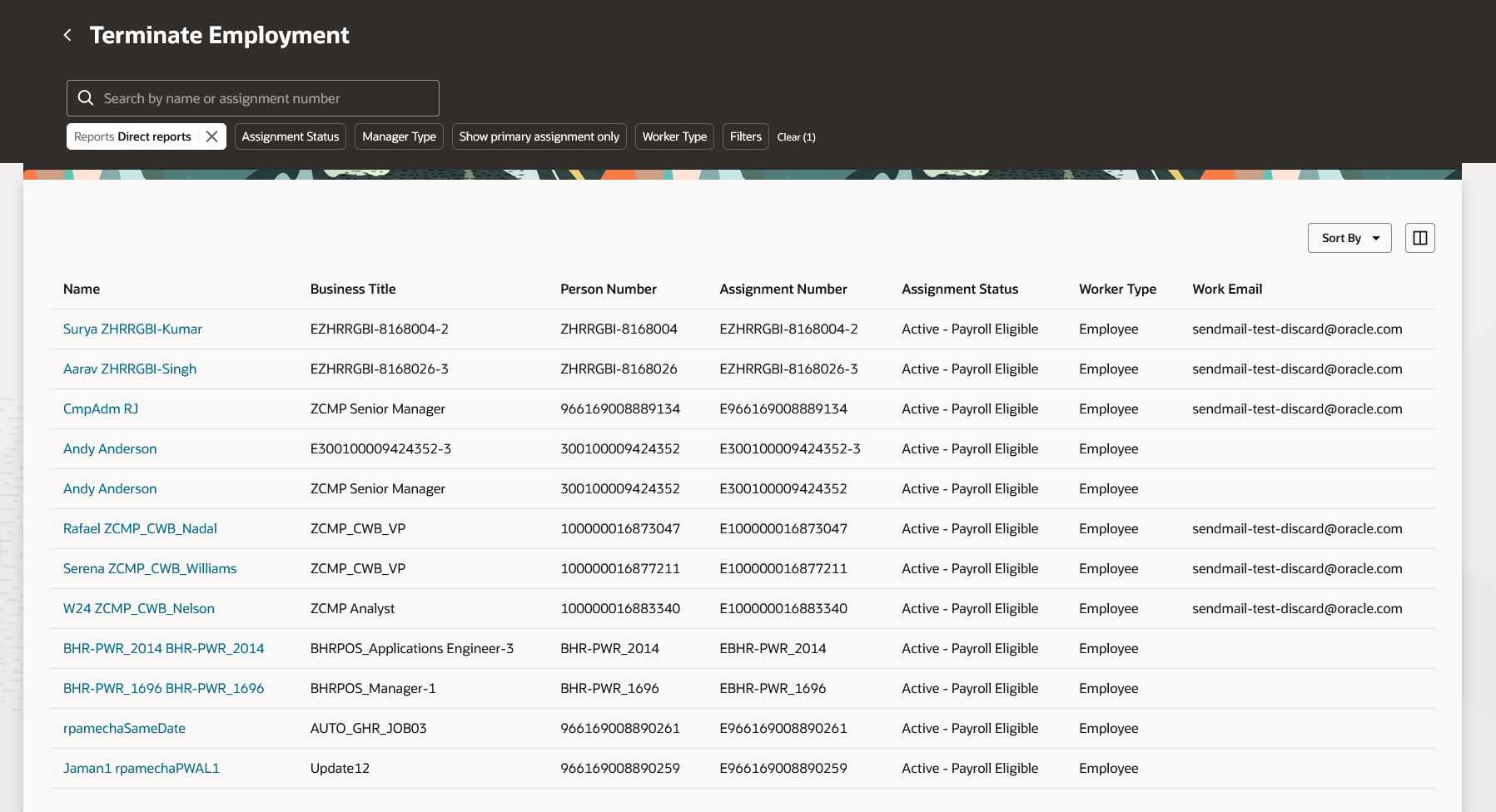

You can navigate to the new Terminate Employment page from these paths:
  • Quick Actions pane under the My Team section, Employment sub-section.
  • Quick Actions pane under the My Client Groups section, Employment sub-section.
You can search for an employee based on the name or assignment number. You can also sort the search results based on relevance and name on the Terminate Employment page.

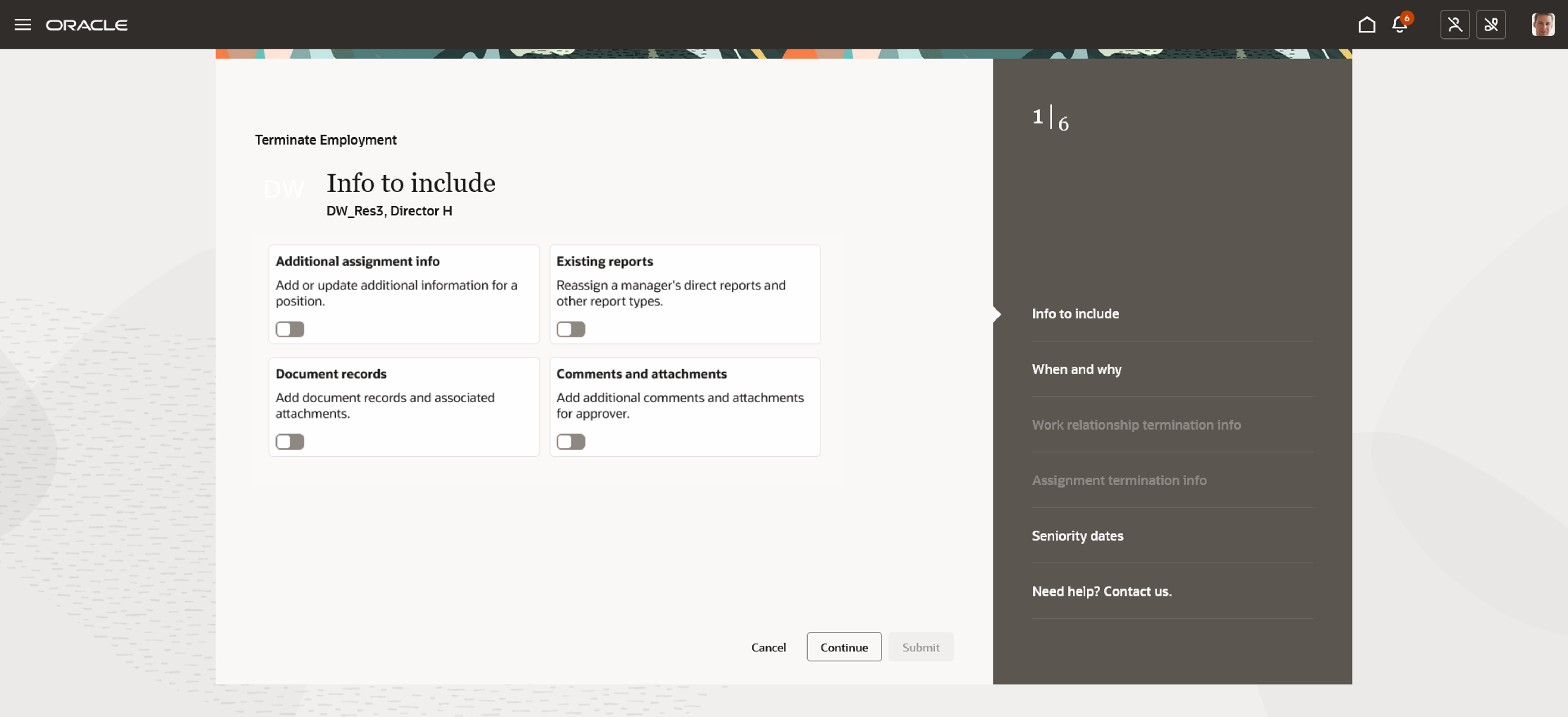

Click a name link to begin the Terminate Employment Journey. On the Terminate Employment Journey step, click Continue.
The Info to include step that includes any additional steps that you want to include in the Terminate Employment Journey. These steps are turned off by default. You have to enable these steps on this page if required. These additional steps are:
  • Additional assignment info
  • Existing reports
  • Document records
  • Comments and attachments
Select the steps you want to include and click Continue.
Note: The Comments and Attachments step is displayed in the Info to include step only when Approvals are enabled.
Note: The selected steps are displayed in the navigation pane.
Info to Include step of the Redwood Terminate Employment Journey

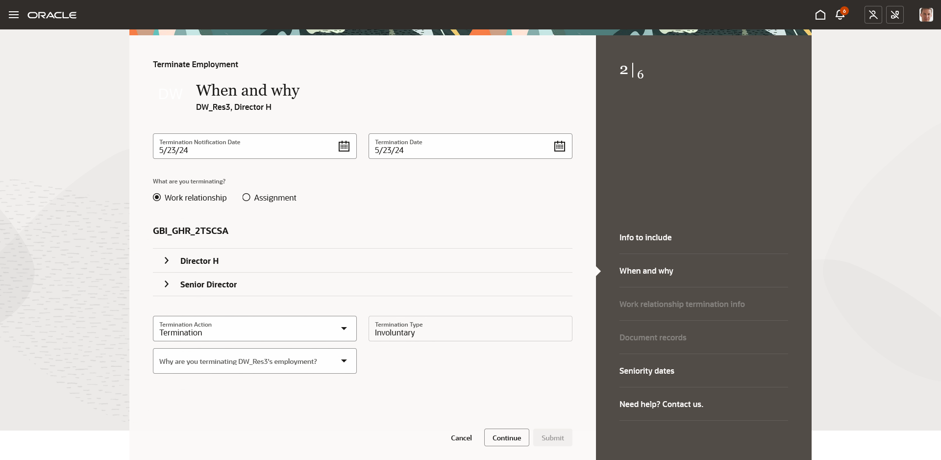

The When and why step is prepopulated with the termination notification date and the date when the termination takes effect. You can modify the dates if required.
Select Work relationship or Assignment depending upon what you need to terminate and then choose appropriate responses for the fields that appear. Once you have made the selection, click Continue.
Note: The When and why step is mandatory.
When and why step of the Redwood Terminate Employment Journey

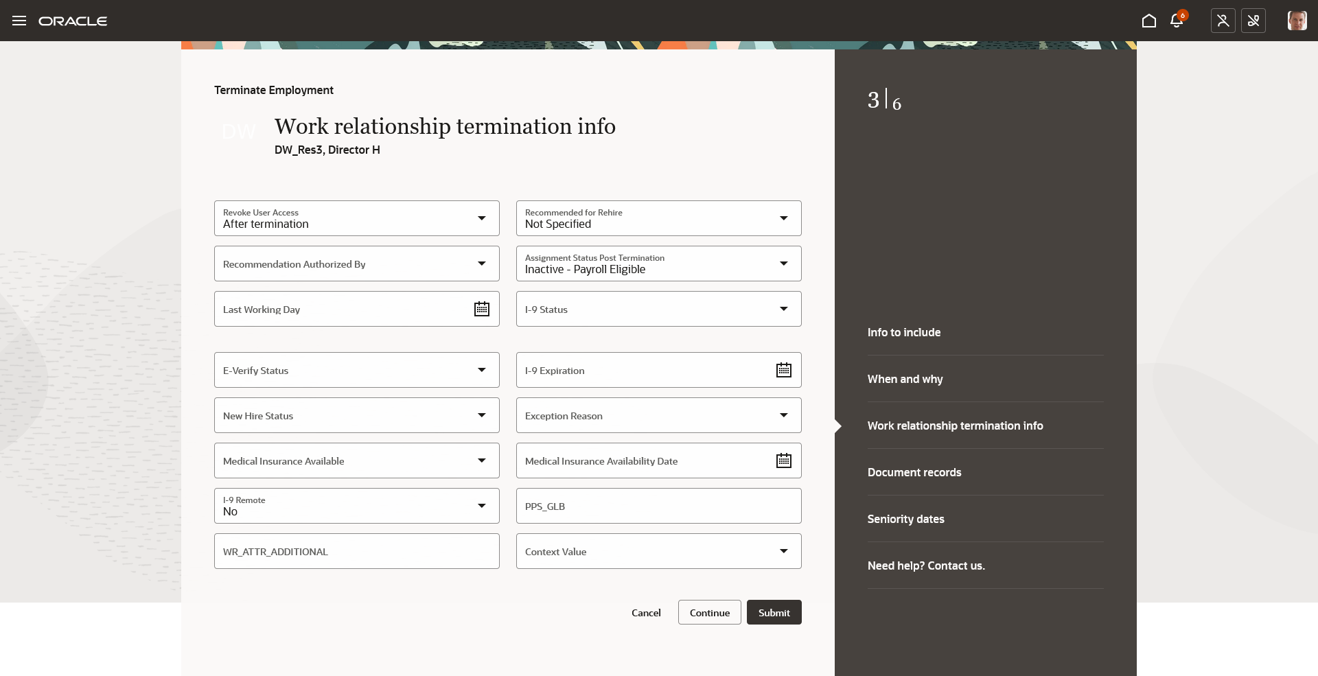

In the Work relationship termination info step, select appropriate responses for the various fields and click Continue.
Work relationship termination info step of the Redwood Terminate Employment Journey

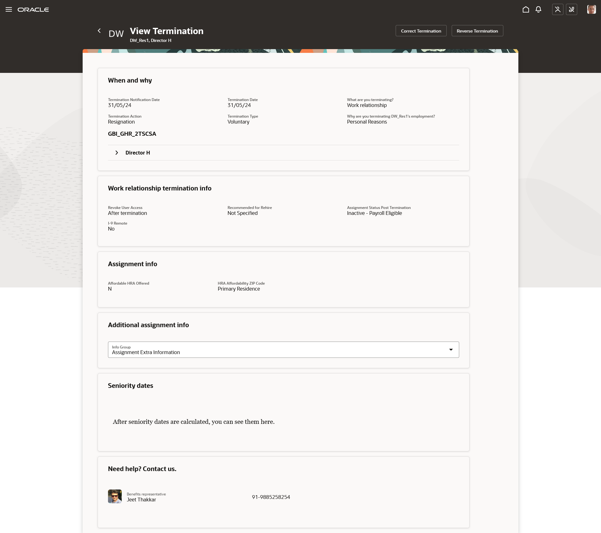

View Termination
After initiating a Termination process for an employee, you can visit the Terminate Employment page and click on their name to view their Termination journey details.
When you click the name or assignment number of the employee, the View Termination page opens.

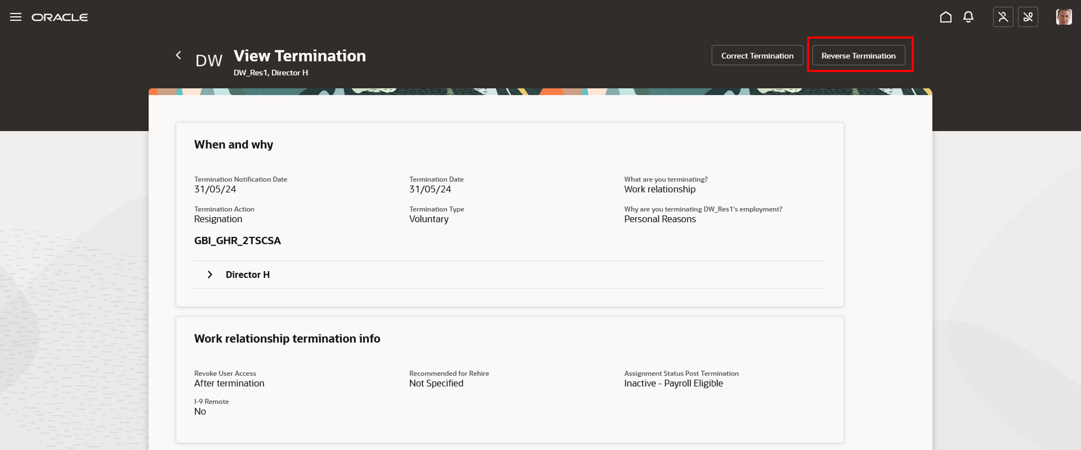

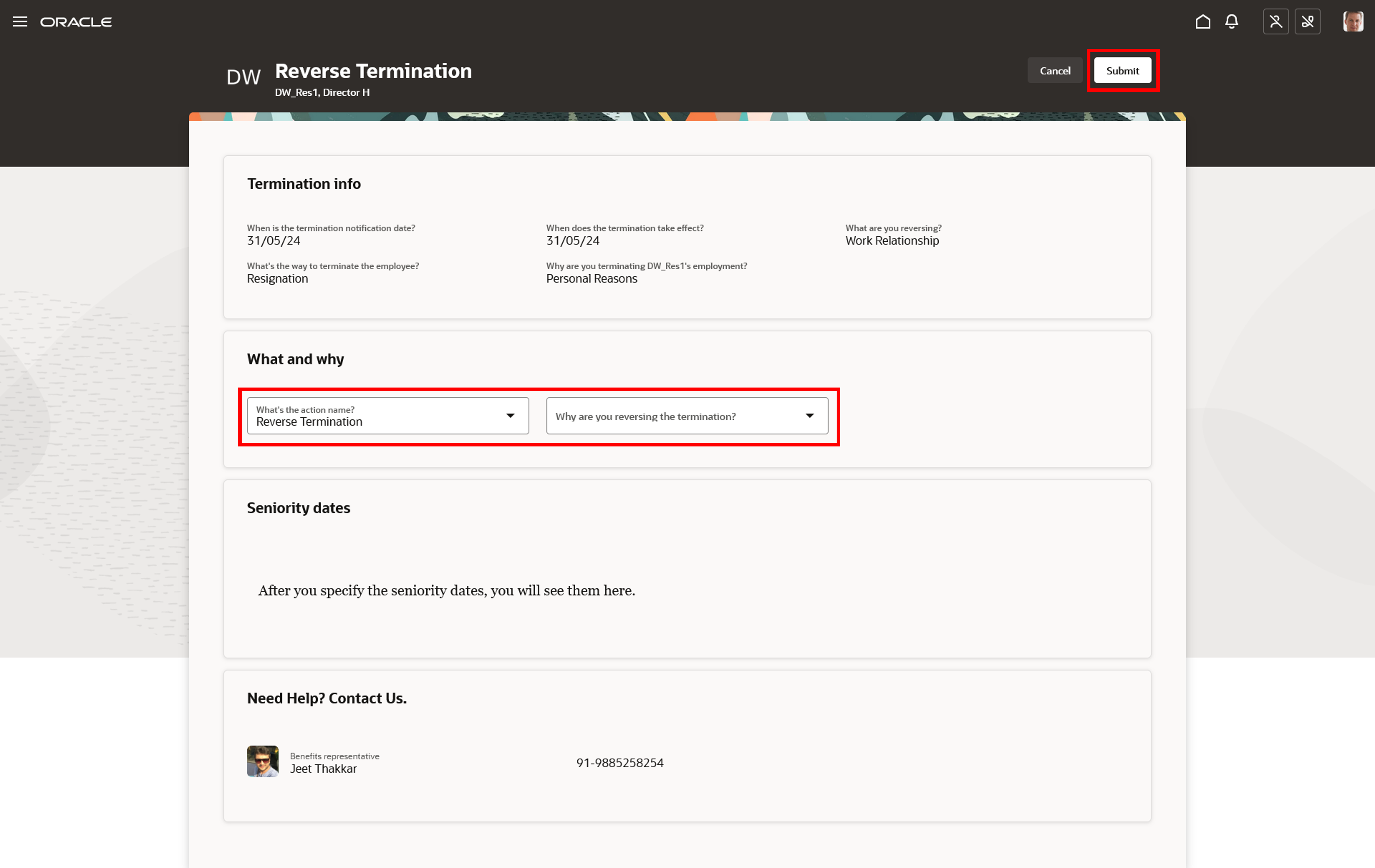

Reverse Termination
If you wish to reverse an employee's termination process, navigate to the Terminate Employment page and click the employee's name or assignment number.
On the View Termination page, click Reverse Termination.
Initiate the reverse termination process
In the Reverse Termination page, What's the action name? field, select Reverse Termination.
In the Why are you reversing the termination? field, select a reason to reverse termination, and click Submit.

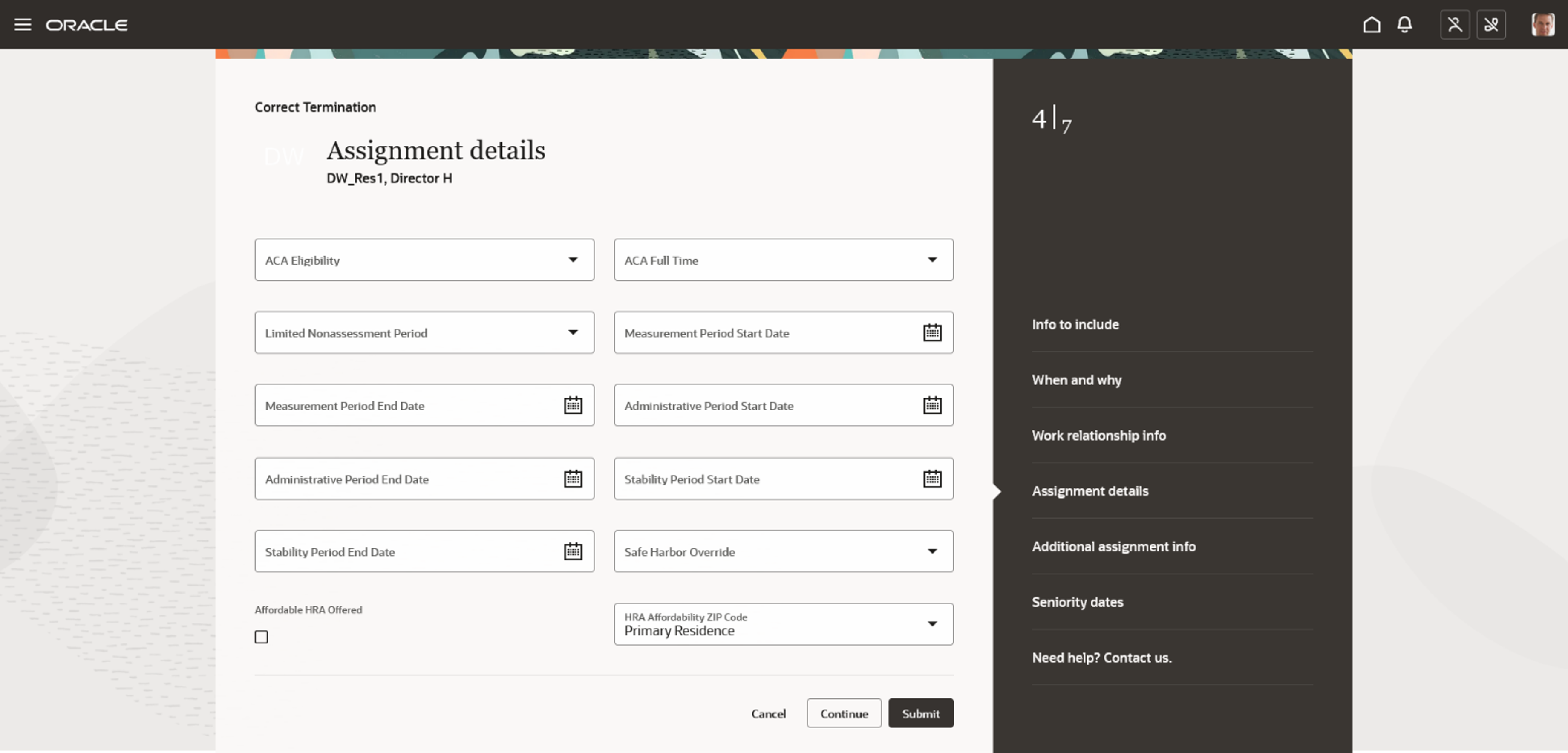

Correct Termination
If you wish to modify an employee's termination process, navigate to the Terminate Employment page and click the employee's name or assignment number.
In the View Termination page, click Correct Termination.
Initiate the correct termination process
This begins the Correct Termination journey which is similar to the Terminate Employment journey. Enter the relevant information in the following steps:
  • Info to include
  • When and why
  • Work relationship info
  • Assignment details
The steps following these steps are optional. Once you specify the details in the required steps, click Submit.
Correct Termination process

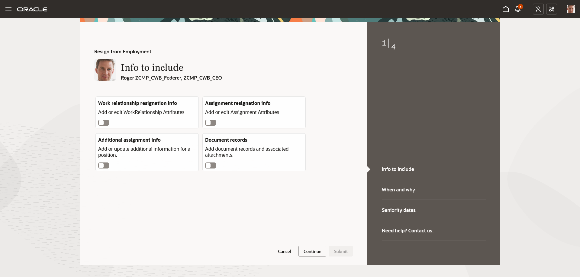

The Resign from Employment process begins with the Resign from Employment Journey step. To initiate the resignation process, click Continue.
The Info to include step includes any additional steps that you want to include in the Resign from Employment. These steps are turned off by default. You have to enable these steps on this page if required. These additional steps are:
  • Work relationship resignation info
  • Assignment resignation info
  • Document records
Info to include step of the Redwood Resign from Employment Journey

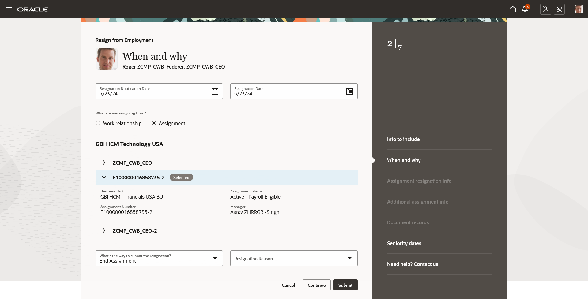

The When and why step is a mandatory step where you select the resignation notification date and the date when the resignation takes effect.
You can select whether you want to resign from the Work relationship or any particular work assignment.
Work relationship and Assignment options will appear if you have multiple assignments. Only the Work relationship option will be displayed if you have a single assignment.
When and why step of the Redwood Resign from Employment journey

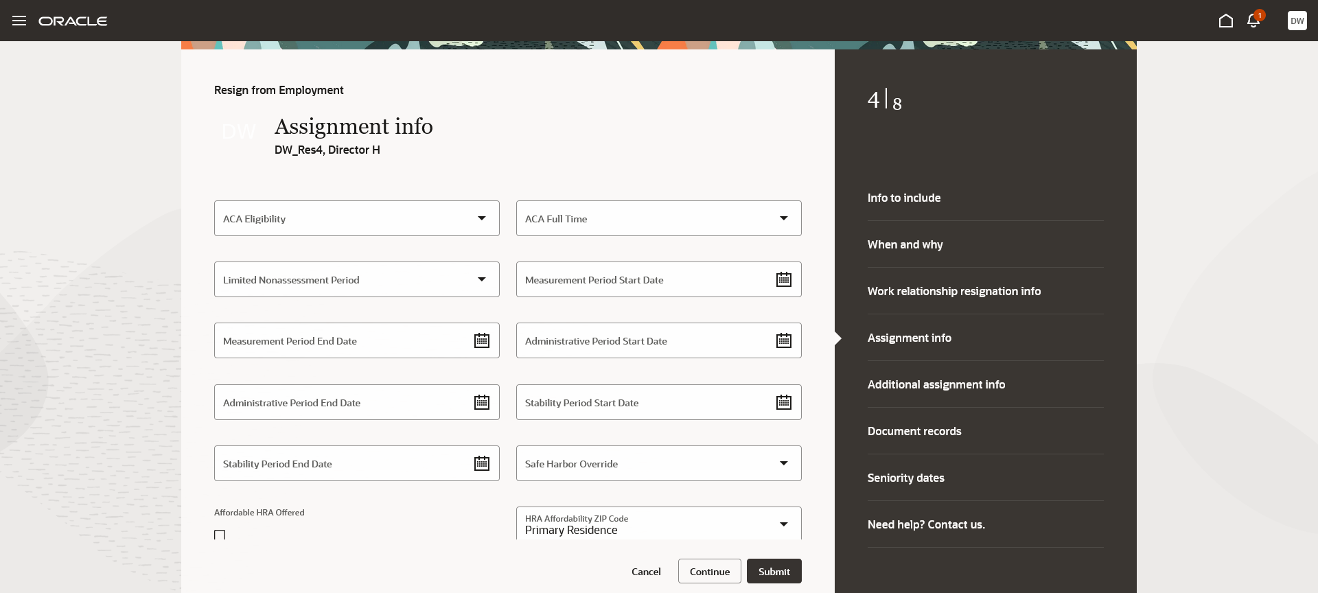

In the Assignment info step, select the appropriate responses for various fields and click Continue.
Assignment info step of the Redwood Resign from Employment journey

Resigning from Assignment
This section is enabled only if you have multiple assignments and you need to resign from one of those assignments.
Select the Assignment radio button if you want to resign from a particular work assignment.
Select the name of the assignment you want to resign from and then select appropriate responses for the fields that appear. Once you have made the selection, click Continue.
When and why step of the Resign from Employment Journey

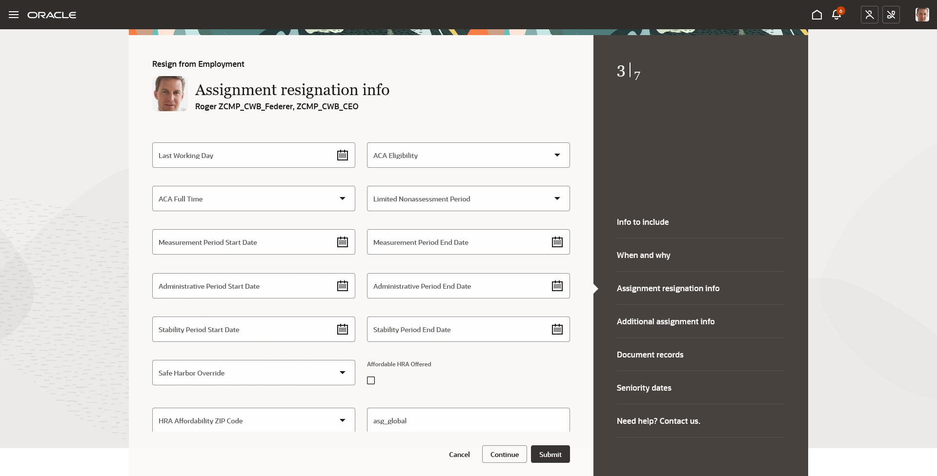

In the Assignment resignation info step, select appropriate responses for the various fields and click Continue.
Assignment resignation info step of the Redwood Resign from Employment journey

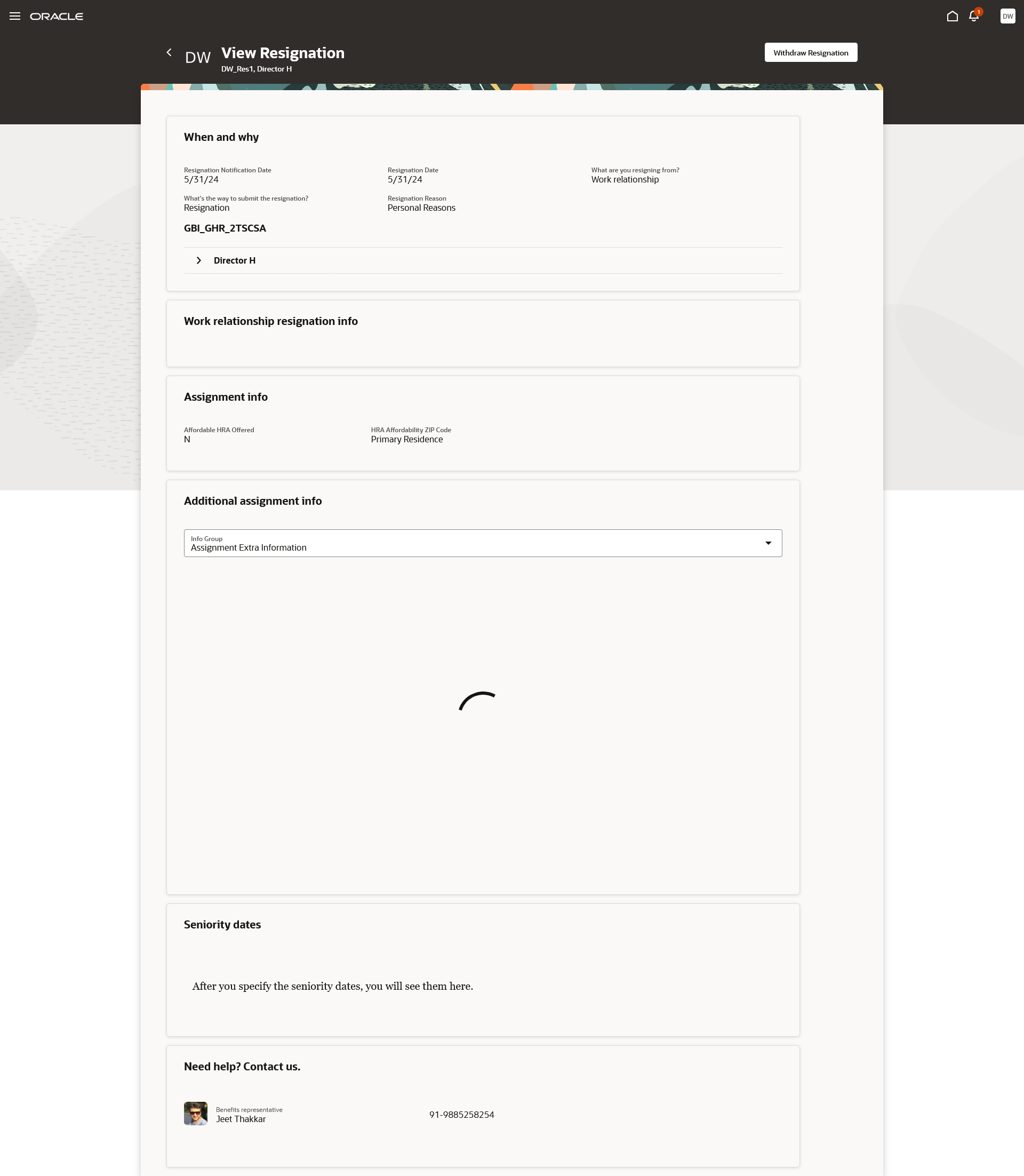

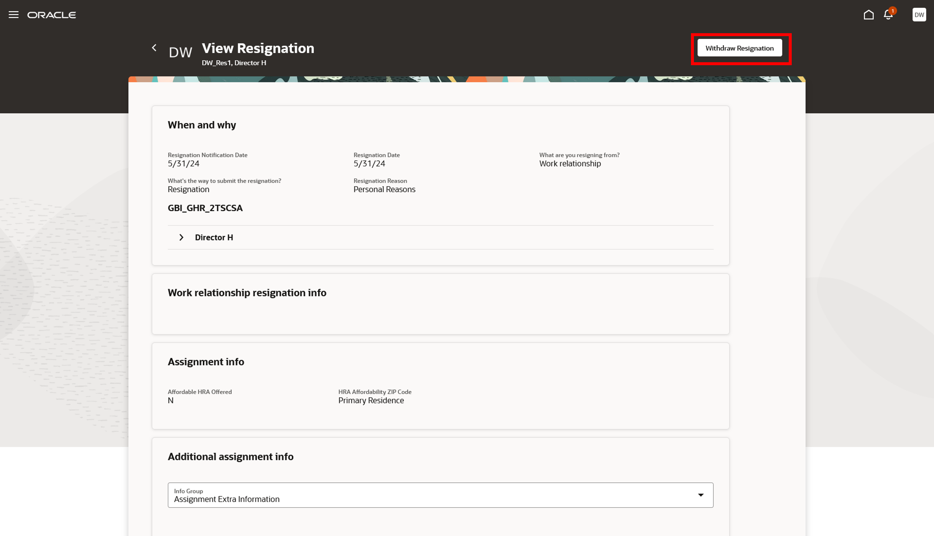

View Resignation
After you've initiated the resignation process, you can view your resignation journey details on the View Resignation page.

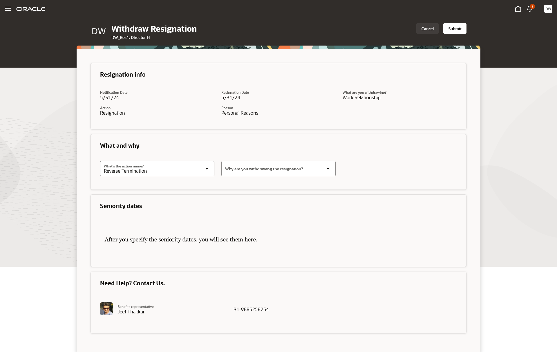

Withdraw Resignation
If you wish to withdraw your resignation from an assignment or organization, navigate to the View Resignation page and click Withdraw Resignation.
Initiate the withdraw resignation process
In the Withdraw Resignation page, What's the action name? field, select Reverse Termination.
In the Why are you withdrawing the resignation? field, select a reason, and click Submit.
