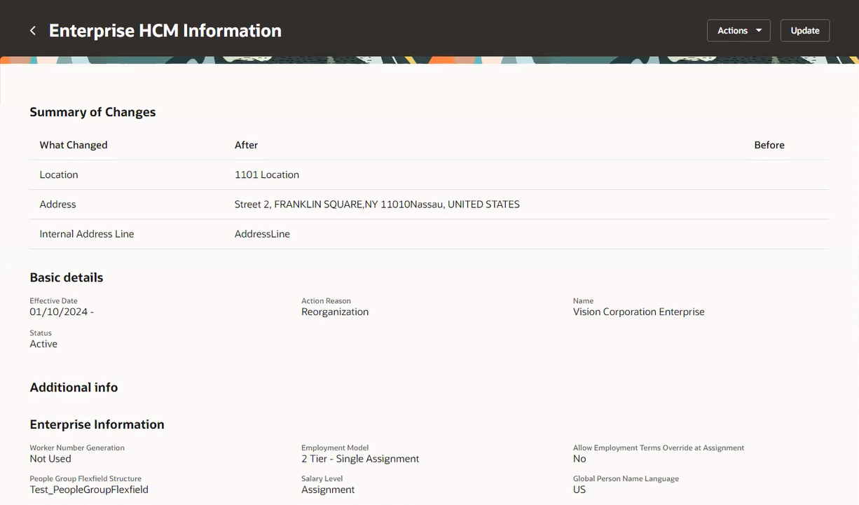

My Client Groups > Show More > Under the Workforce Structures section, click the Enterprise HCM Information option. Because there’s only one enterprise, the enterprise UI doesn’t have a search page. You will see the read-only Enterprise HCM Information page.
HCM Enterprise Information Read-Only Page
NOTE: The internal address line, location, DFF and attachments fields are hidden by default on the Enterprise HCM Information page. You need to enable them using business rules.
The sections on this page are Summary of changes, Basic details, Additional info, and History. The History section shows multiple date-effective changes. You can navigate to any specific date-effective change that you want.

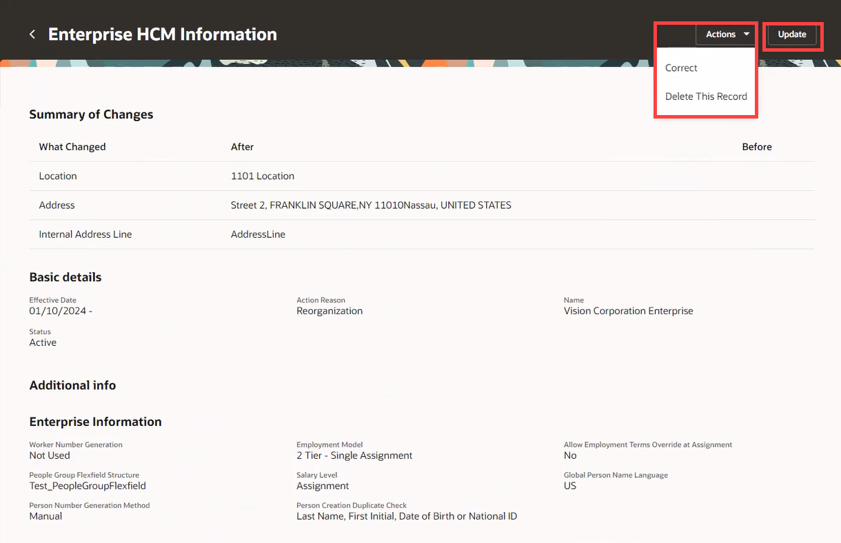

To update the enterprise HCM information record, click the Update button on the Enterprise HCM Information page. Update the Effective Start Date, Action Reason, and any other fields as required.

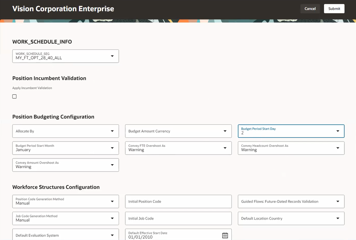

In this example, the WORK_SCHEDULE_INFO and the Budget Period Start Day are being updated in the Additional info section. Click Submit. This will take you back to the Enterprise HCM Information read-only page. The Summary of changes section shows the changes you made

To correct the enterprise HCM information record, click the Correct option in the Actions menu on the Enterprise HCM Information page. Make the required changes and click Submit. The Summary of changes section shows the changes you made.

You can also delete a date-effective row in the enterprise HCM information record. On the Enterprise HCM Information page, in the History section, click the link for the date-effective row that you want to delete. Click the Delete This Record option in the Actions drop-down menu. The date-effective row is deleted and no longer shows up in the History section.
