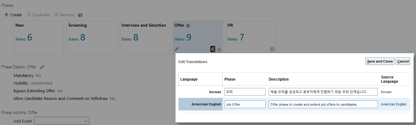

- To modify the name of a default phase, select a phase then click the Translation Editor icon. Enter a name and click Save and Close.
- To modify the name of a default state, click the Translation Editor icon next to a state. Enter a name and click Save and Close.
Modifying the Name of a Default Phase
