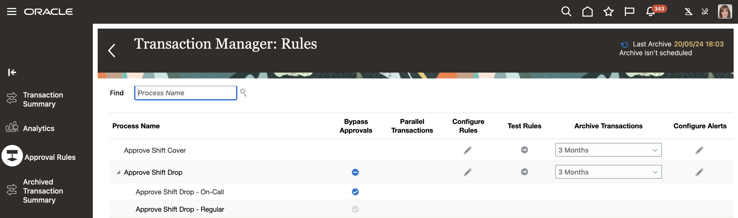

Transaction Manager: Rules Page Showing the Approve Shift Drop Rules

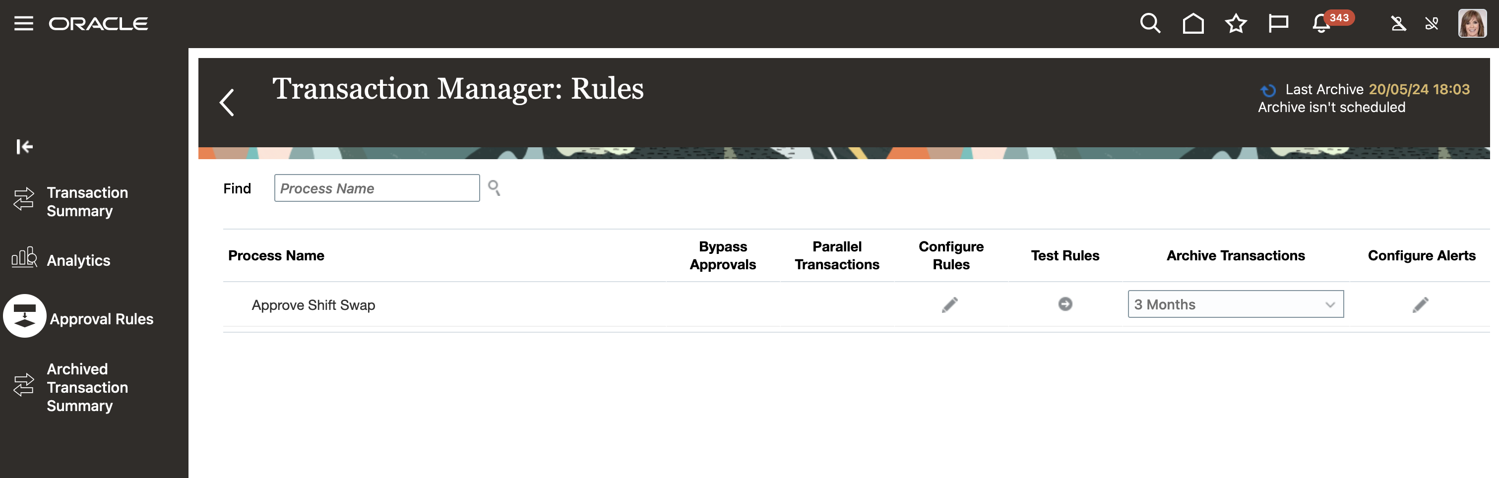

Transaction Manager: Rules Page Showing the Approve Shift Swap Rule
