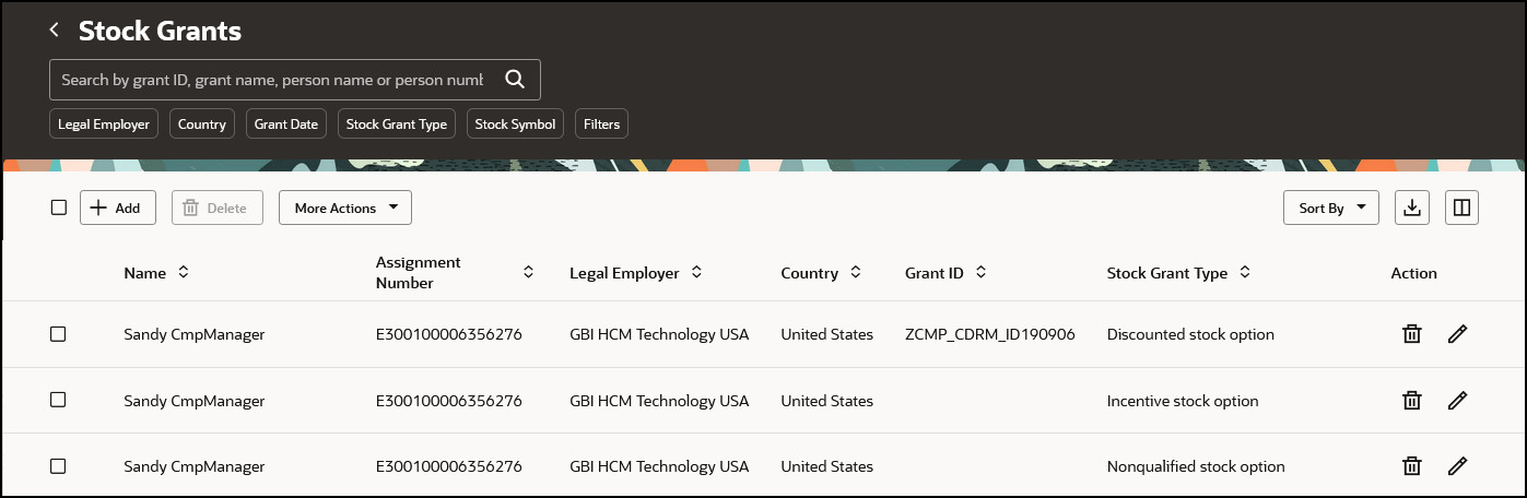

People can use the Stock Grants page re-created with the Redwood tool set Visual Builder Studio. You can enable the page and section along with the Redwood experience.
Stock Grants

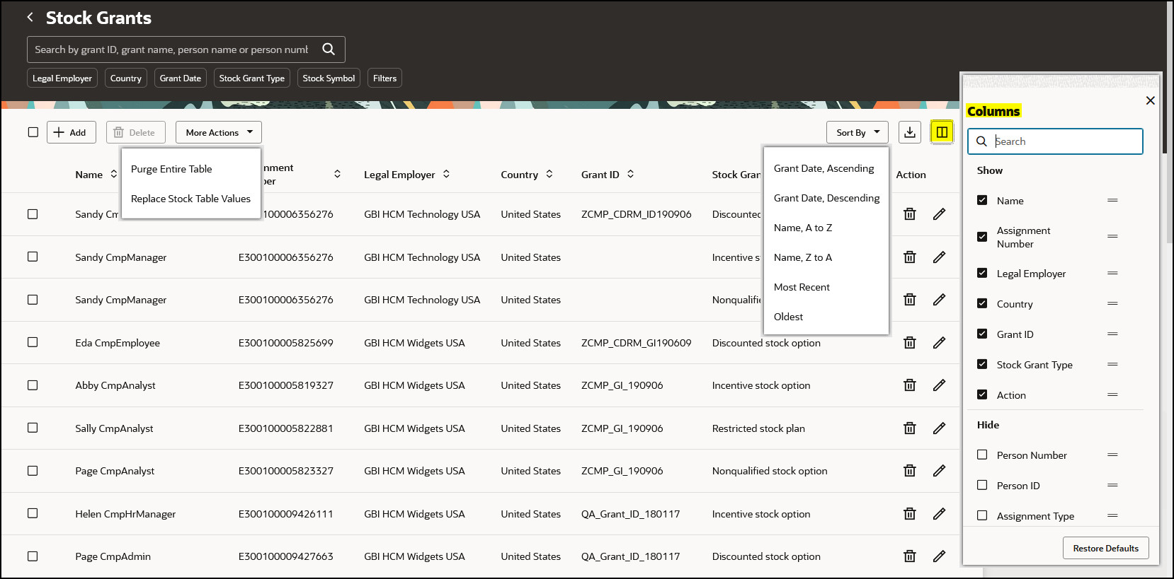

Stock Grants with Drop Downs Displayed
With this re-created Redwood page, you continue your journey into Oracle Redwood solutions.

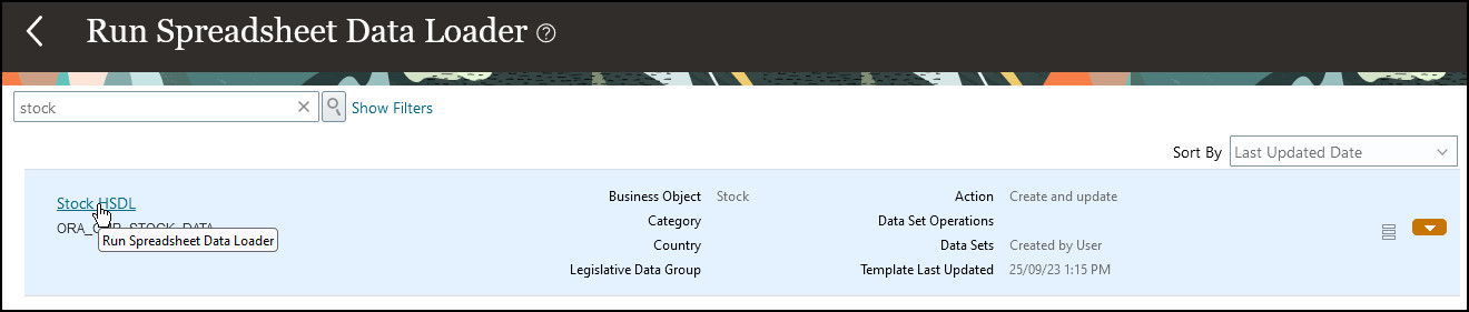

Use Data Exchange in My Client Groups, to load data via HDL or HSDL. The Prepare Import Spreadsheet button that invokes ADFdi, is not yet available in Redwood.
Run Spreadsheet Data Loader
