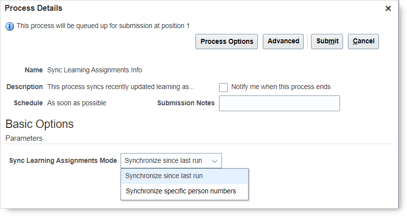

2. Schedule the Sync Learning Assignments Info process to run at regular intervals. If you select the sync learning assignments mode Synchronize specific person numbers, you need to enter a comma-separated list of person numbers.
Sync Learning Assignments Info Process
