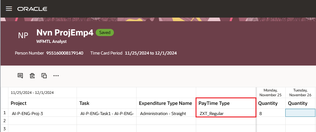

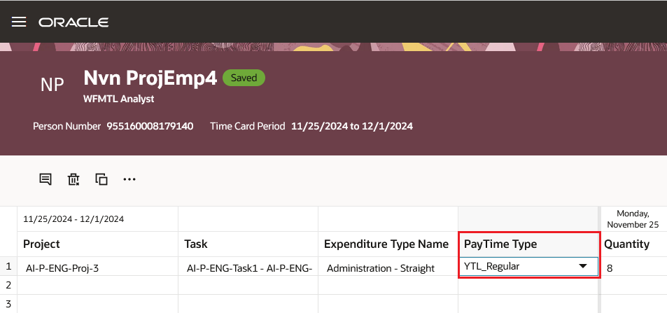

- The time card has separate Project, Task, Expenditure Type Name, and Pay Time Type fields. The original time entry transferred to Project Costing had a Pay Time Type of ZXT_Regular. The value later changed to YTL_Regular. Becaues the Project, Task, and Expenditure Type Name values didn't change, the entry doesn't transfer to Project Costing again.
Time Card with the ZXT_Regular Pay Time Type
Time Card with the YTL_Regular Pay Time Type

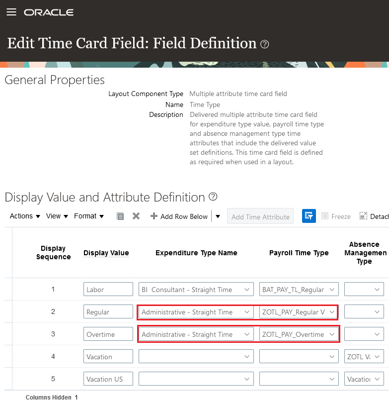

The time card includes the Time Type field with Regular and Overtime options. These options both have the same Expenditure Type value, but different Payroll Time Type values. The original Monday entry transferred to Project Costing with the Overtime attribute values. The entry was later changed to Regular. Because the Expenditure Type value didn't change, the entry doesn't transfer to Project Costing again.
Multiattribute Time Card Field Showing the Regular and Overtime Display Values with the Same Expenditure Type Name Value, but Different Payroll Time Type Values

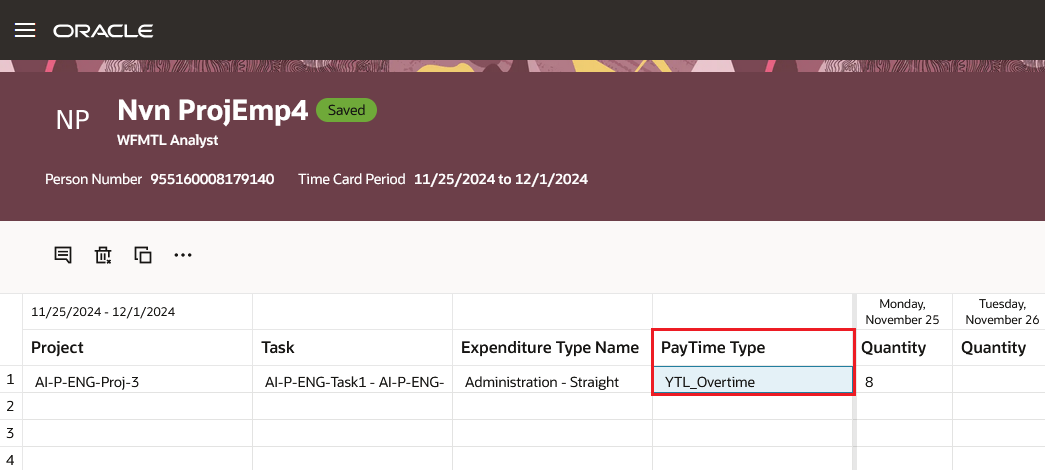

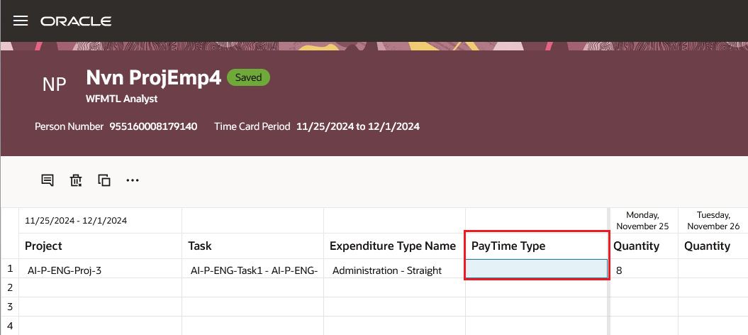

Here's an example of an entry-level classification change that does result in time entry transfer to Project Costing. The time card has separate Project, Task, Expenditure Type Name, and Pay Time Type fields. The original time entry transferred to Project Costing didn't have a Pay Time Type value. The entry was later changed to include the YTL_Overtime pay type type. Even though the project attribute values didn't change, the entry-level classification changed from only Project Costing to Project Costing and Global Payroll, so the time entry change transfers to Project Costing.
Time Card without a Pay Time Type Value
Time Card with the YTL_Regular Pay Time Type Value

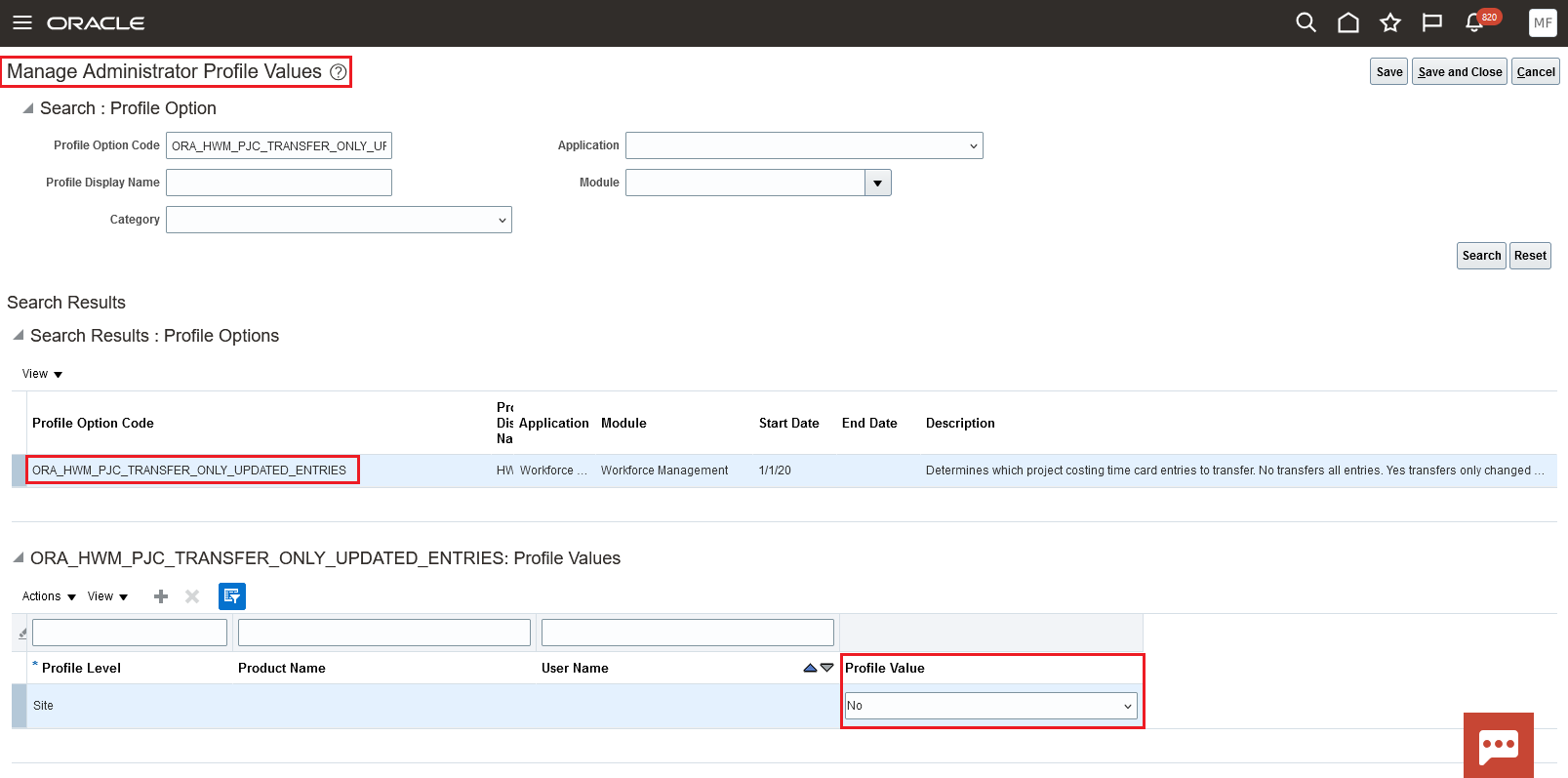

Steps to Enable
You only need to do these steps if you haven't already enabled the ORA_HWM_PJC_TRANSFER_ONLY_UPDATED_ENTRIES profile option.
- Search for and click the Manage Administrator Profile Values task in the Setup and Maintenance work area.
- Search for and select the ORA_HWM_PJC_TRANSFER_ONLY_UPDATED_ENTRIES profile option.
- Set Profile Level to Site.
- In the Profile Value field, select Yes.
Manage Administration Profile Values Page Showing the ORA_HWM_PJC_TRANSFER_ONLY_UPDATED_ENTRIES Profile Option
