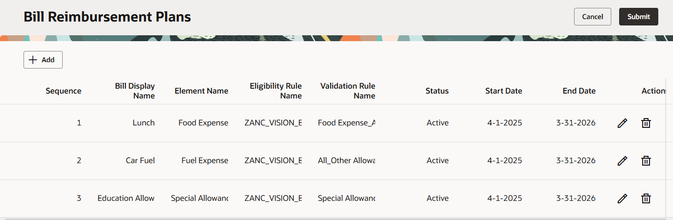

Payroll Administrators can set up the following:
  • Define the payroll allowance elements.
  • Set up the eligibility and validation rules for each bill type.
  • Set up the different bill reimbursement plans that cater to different expense types such as dining and travel expenses, and other allowances.
The Payroll Administrators can also verify and approve the bills submitted by the employees, as well as add bills on behalf of employees.
