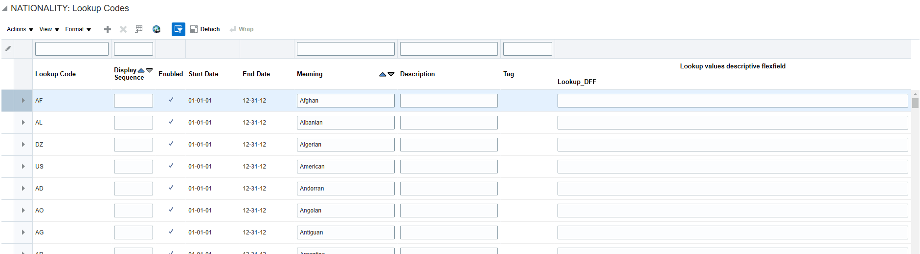

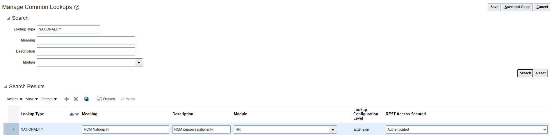

Here's an example of a fast formula to return true if job application citizenship is Canada and Active. Possible values for this database item are the country codes defined in the "NATIONALITY" lookup type.

Nationality Lookup
Nationality Lookup
Nationality Lookup Codes
