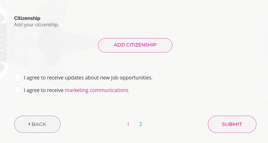

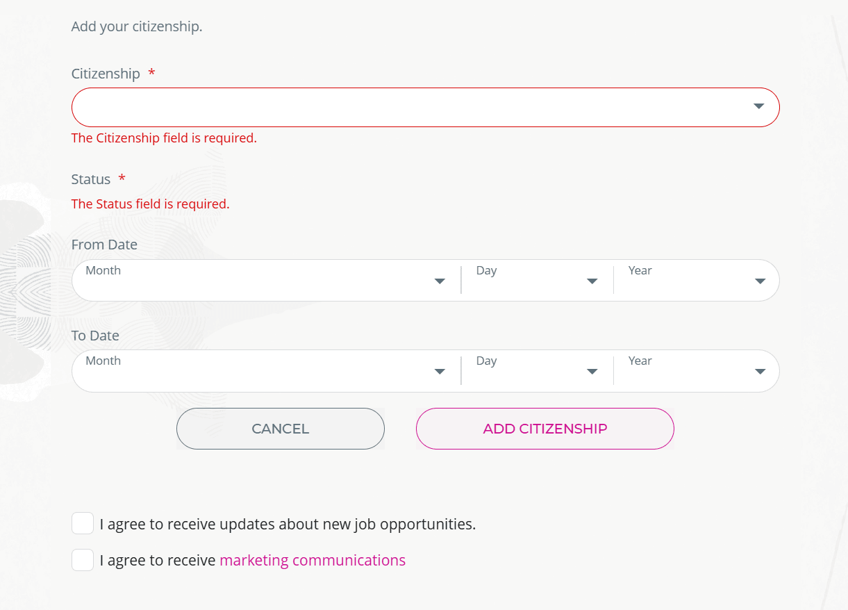

Citizenship Block in the Application Flow
Candidates can add multiple citizenships with different statuses.

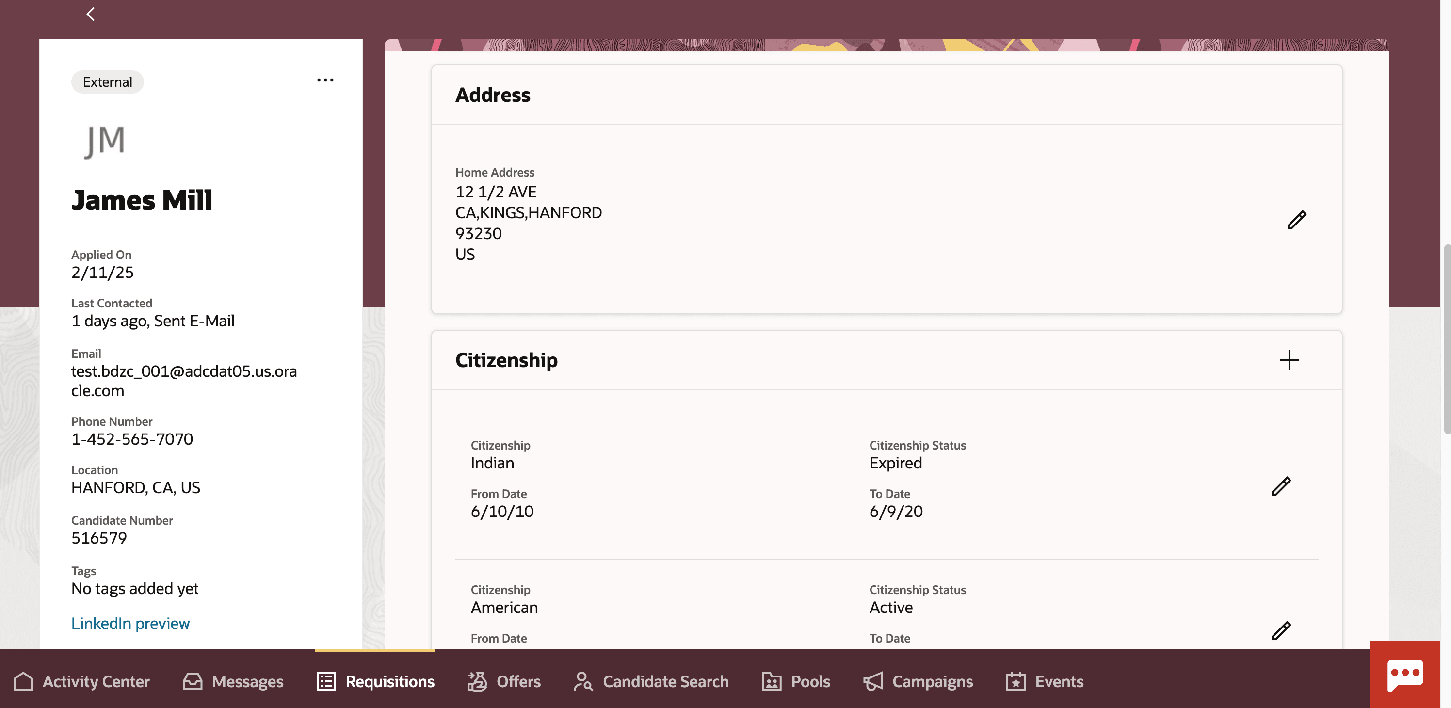

When an application flow has the citizenship block, it also displays to recruiters from the candidate profile. Recruiters can add, edit, or delete citizenship. Recruiters can filter candidates based on citizenship from the candidate list page.
You can optionally enable a profile option that lets recruiters modify the citizenship details for the candidates who are external contingent workers, ex-contingent workers, and ex-employees.
Recruiters can see the citizenship block in candidate profile only when Redwood is enabled. Recruiters can't add or modify the citizenship information for internal candidates.
Recruiter View of Candidate's Citizenship

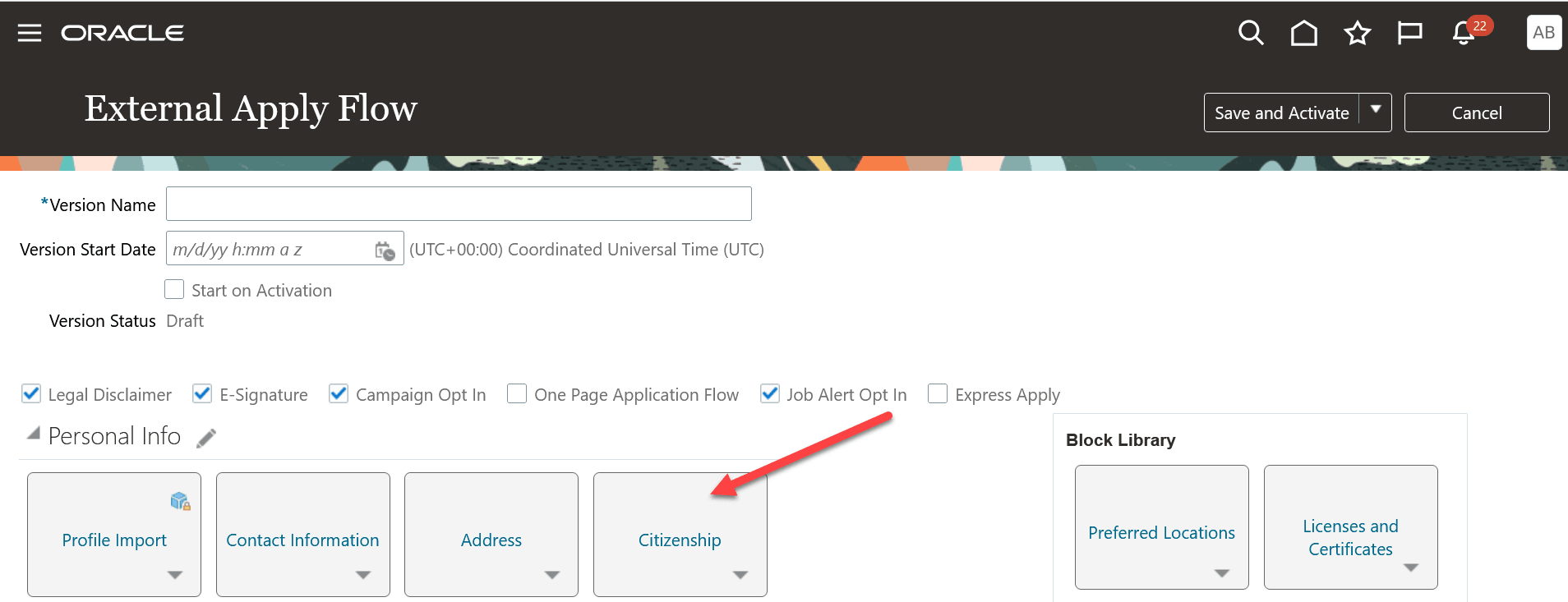

To add the Citizenship block to flows:
- In the Setup and Maintenance work area, go to:
- Offering: Recruiting and Candidate Experience
- Functional Area: Candidate Experience
- Task: Job Application Flow Configuration
- Create a new flow or add a new version to an existing flow.
New Citizenship Block
- You can add the block to any section. You can update the headline, instructions, and block required fields.
Update the Block Details
