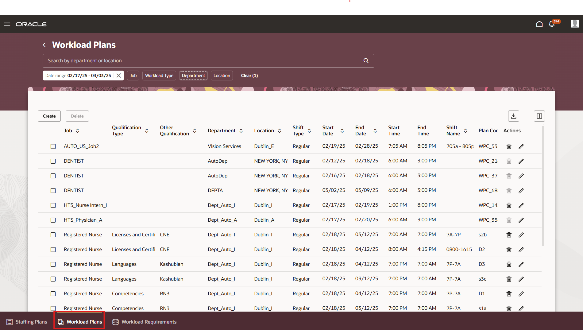

You can filter the workload plans available to you based on your security profile. And you can manage all of the workloads providing staffing requirements to the scheduling processes. Use the new Workload Management app, Workload Plans tab.
Workload Plans page
Workload Plans Page

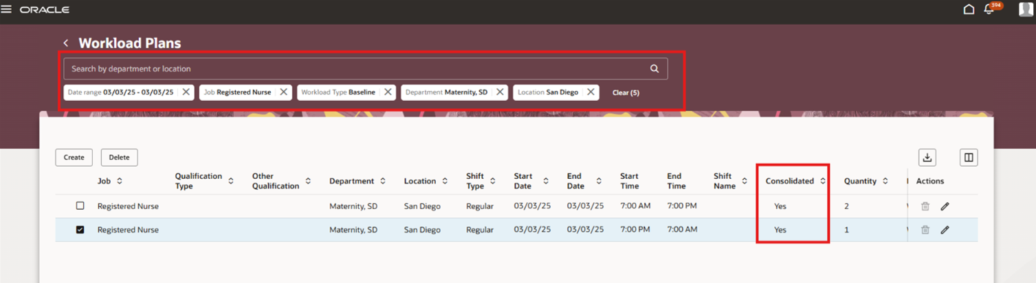

The default date range provided in searches is the current date plus 14 days, which finds any workload plans that intersect the date range. You can change the date range filter to match the precision you need to find the workload you're managing. The workload plan attributes include a Consolidated attribute that indicates the requirement is used in the workload consolidation record. If the workload plan was used in consolidation, you can change only the workload quantity. If new workload requirement attributes are needed for this date and time, we recommend that you create another workload plan, which will update the workload consolidation used for schedule coverage.
Workload Plan Page Filters and Consolidated Attribute

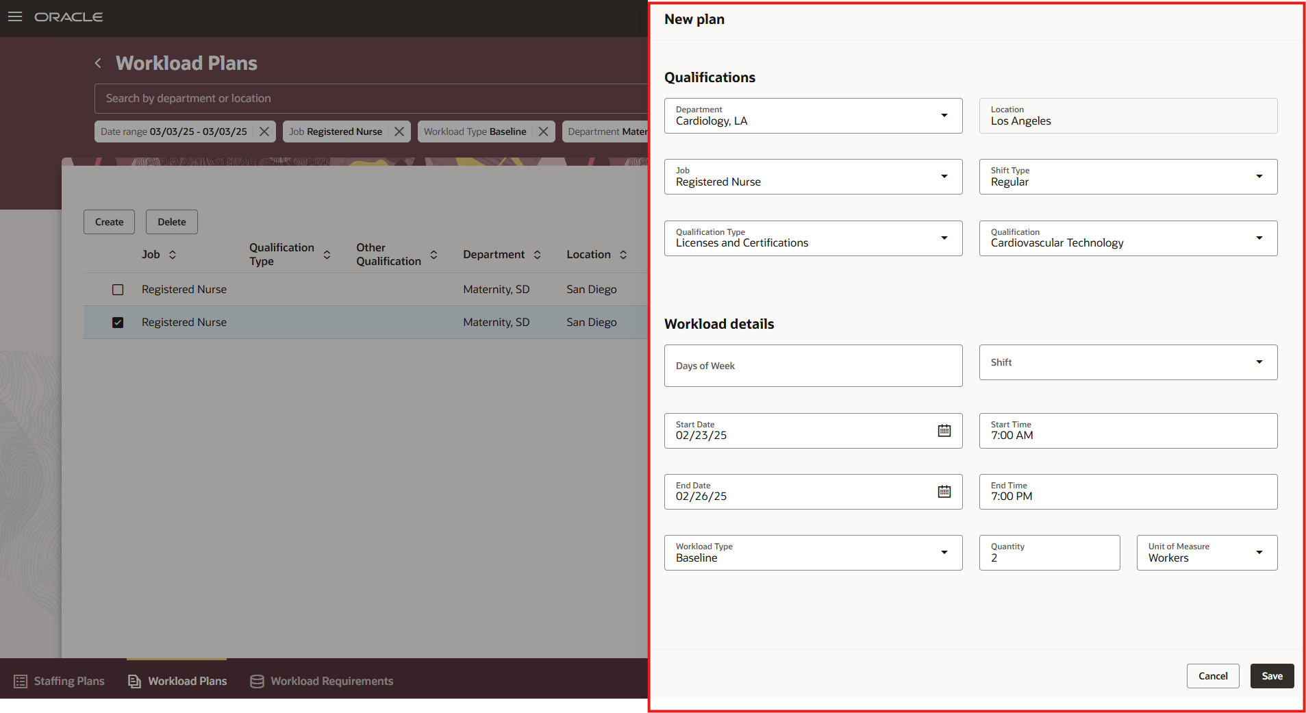

New Plan Drawer Opened from the Workloads Plan Page
