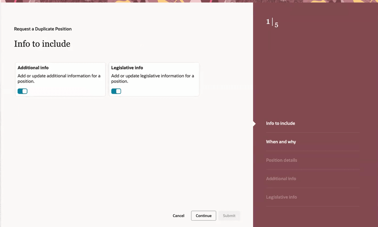

Info to include Step
Info to include step of the guided process

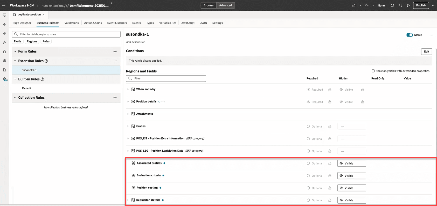

Include additional steps using VB Studio business rules

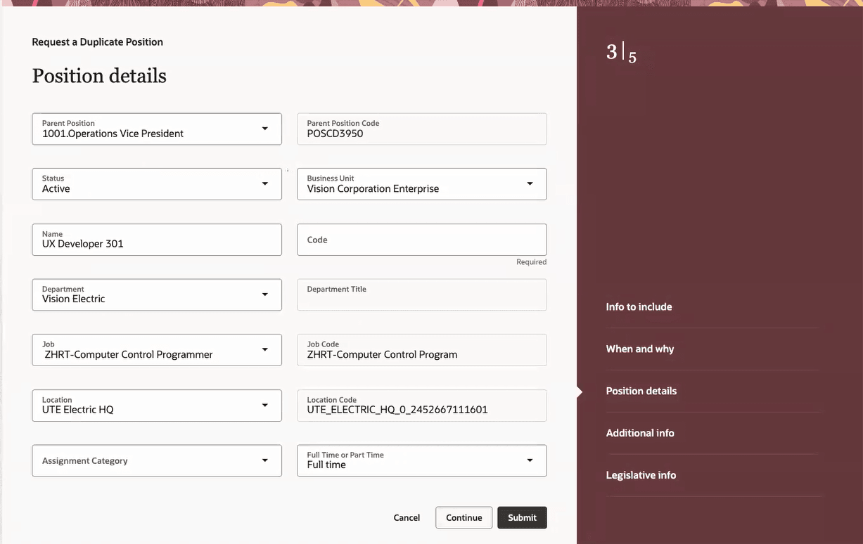

Position details step

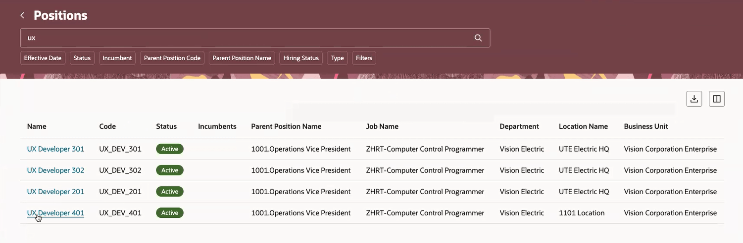

New position listed on Positions search page
