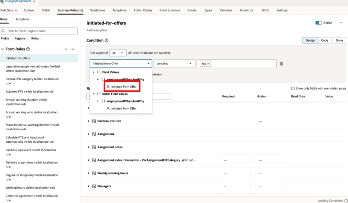

You can now set up business rules based on whether an employment action is initiated from a job offer. This helps you apply different validations, checks, and field controls depending depending on how the process started, reducing rework and improving efficiency. The new "Initiated from Offer" flag will indicate if an action - such as Promote, Transfer, or Add Assignment - began from a job offer.
This feature applies to the following processes:
  • Add Assignment
  • Change Assignment
  • Create Work Relationship
  • Local and Global Transfer
  • Promote
  • Transfer
This allows validations and field controls depending on whether the action is initiated from a job offer conversion. To help customers the "Initiated from Offer" field is available so business rules can be set up in advance and avoid rework.
Business rule support for Inditated from Offer enokoyment actuobs
Business rule support for Initiated from Offer employment actions
This enables more precise control and ensures that employment actions follow the correct path based on their origin.
