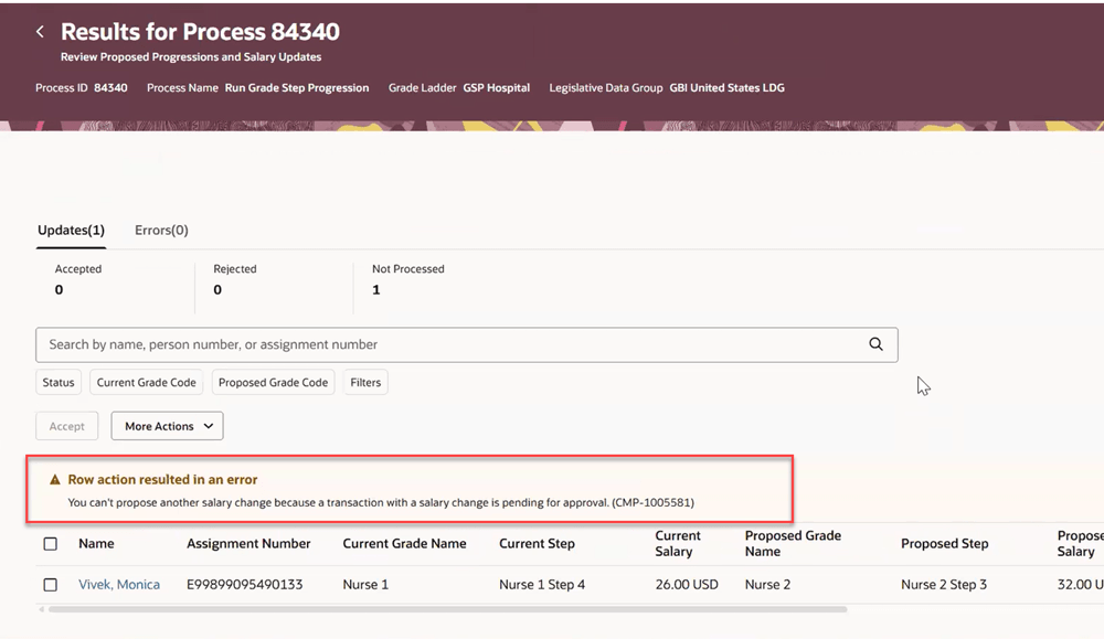

  • If Confirmation Type is Manual: You confirm on the Accept on the Review Proposed Progressions and Salary Updates page. If there’s a pending salary transaction, the action won't go through. The status remains as Not Processed, assignment and salary updates aren't applied, and you see this message: You can't propose another salary change because a transaction with a salary change is pending for approval.
    Error message when there's a pending salary transaction and Confirmation Types is Manual
    Results for Process Page Showing an Error Message Because There's a Pending Salary Transaction and Confirmation Type Is Manual
