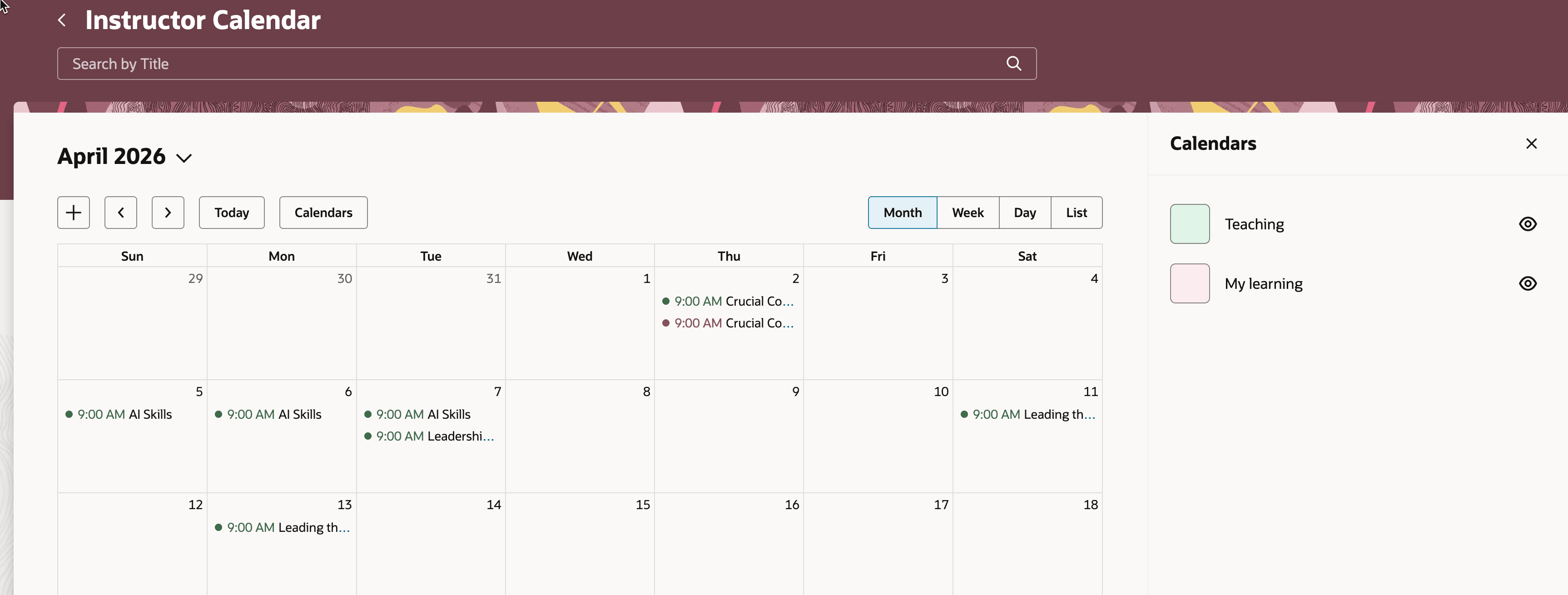

Overlay your teaching schedule with enrolled courses in the My Learning calendar to spot conflicts and plan more effectively.
Instructor Calendar with Both Calendars Enabled

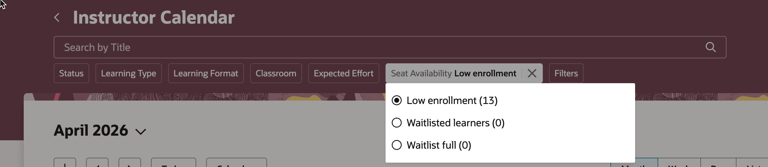

Use the new Seat Availability filter in the teaching calendar and offerings to find low-enrollment, waitlisted, or full sessions.
Instructor Calendar Showing the Seat Availability Filter
