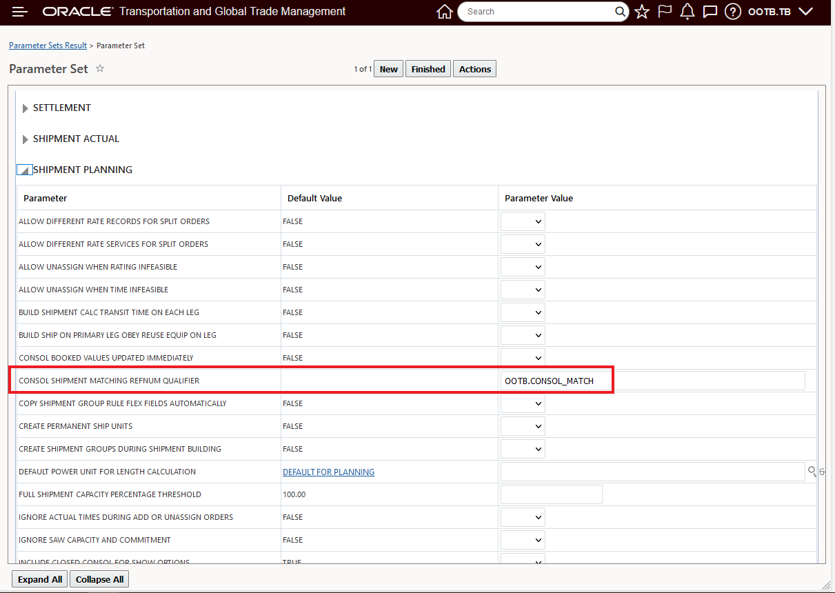

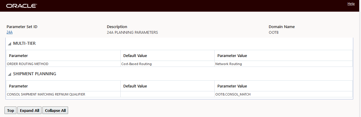

The first step for using this feature involves selecting (or creating) the Shipment and Order Release Reference Number Qualifier to use.  The chosen Reference Number Qualifier will be the value entered in the Planning Parameter CONSOL SHIPMENT MATCHING REFNUM QUALIFIER and will be the Reference Number Qualifier assigned to the Order Releases and Consol Shipments.  Note, since Reference Number Qualifiers are actually defined and managed by object (in this case Order Release and Shipment ) the Reference Number Qualifiers selected must be configured in the same Domain.  In this example, the Order Release and Shipment Reference Number Qualifier "CONSOL_MATCH" was created in the "OOTB" Domain.  Note that the value specified for the Planning Parameter CONSOL SHIPMENT MATCHING REFNUM QUALIFIER is the GID for Reference Number Qualifier, in this case OOTB.CONSOL_MATCH.
CONSOL SHIPMENT MATCHING REFNUM QUALIFIER - Parameter Setup
While you are setting up the Parameters  - you will also need to make sure/change the Order Routing Method to Network Routing v Cost Based routing.
In summary, the Parameter setup changes required are shown below.
Parameter Overrides Required

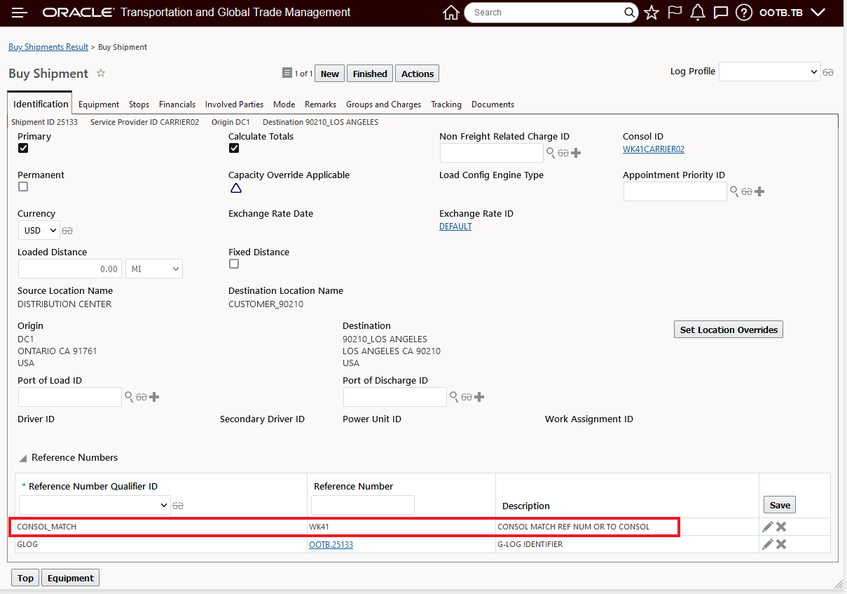

Below is Consol Shipment 25133 - for Service Provider Carrier02 with the matching Reference Number Qualifier and Value CONSOL_MATCH WK41.
Carrier02 Consol Shipment 25133 With Qualifier and Value

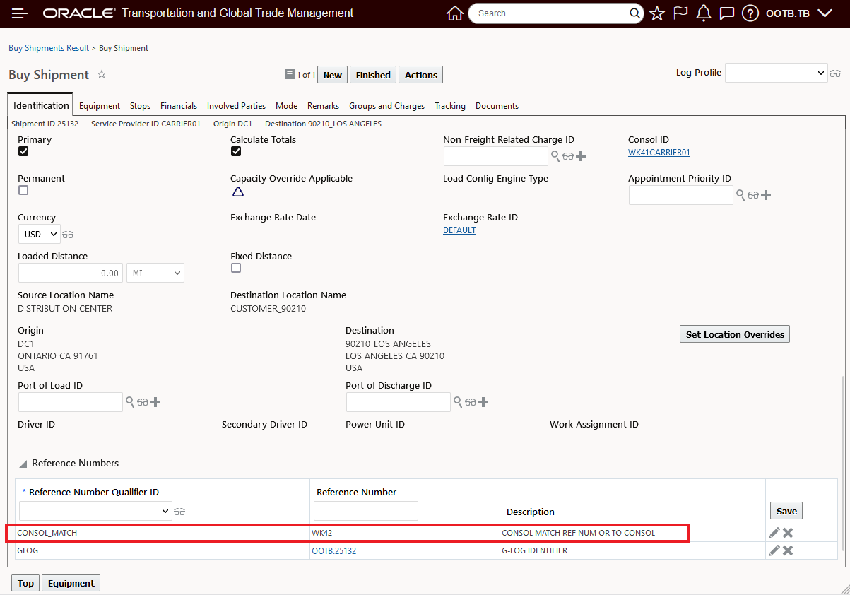

Below is Consol Shipment 25132 - for Service Provider Carrier01 with the matching Reference Number Qualifier, but a different Value CONSOL_MATCH WK42.
Carrier01 Consol Shipment With Different Reference Number Qualifier Value

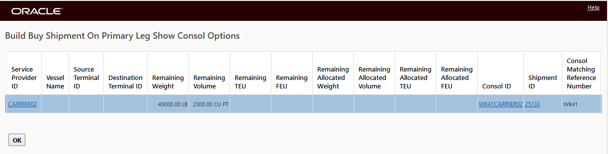

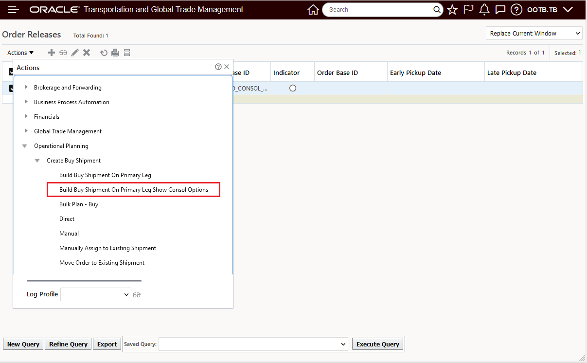

With this setup, running the action Build Buy Shipment On Primary Leg Show Consol Options will only bring back the Carrier02 Consol Shipment Option - as shown below. The Order Release - below - has also been configured with the same Reference Number Qualifier and Value as the Consol Shipment for Carrier02.
In this case - only one option is provided - the Consol Shipment (25133) option with the matching Reference Number Qualifier and Value CONSOL_MATCH WK41.
Consol Shipment Option with the Matching Reference Number Qualifier and Value CONSOL_MATCH WK41

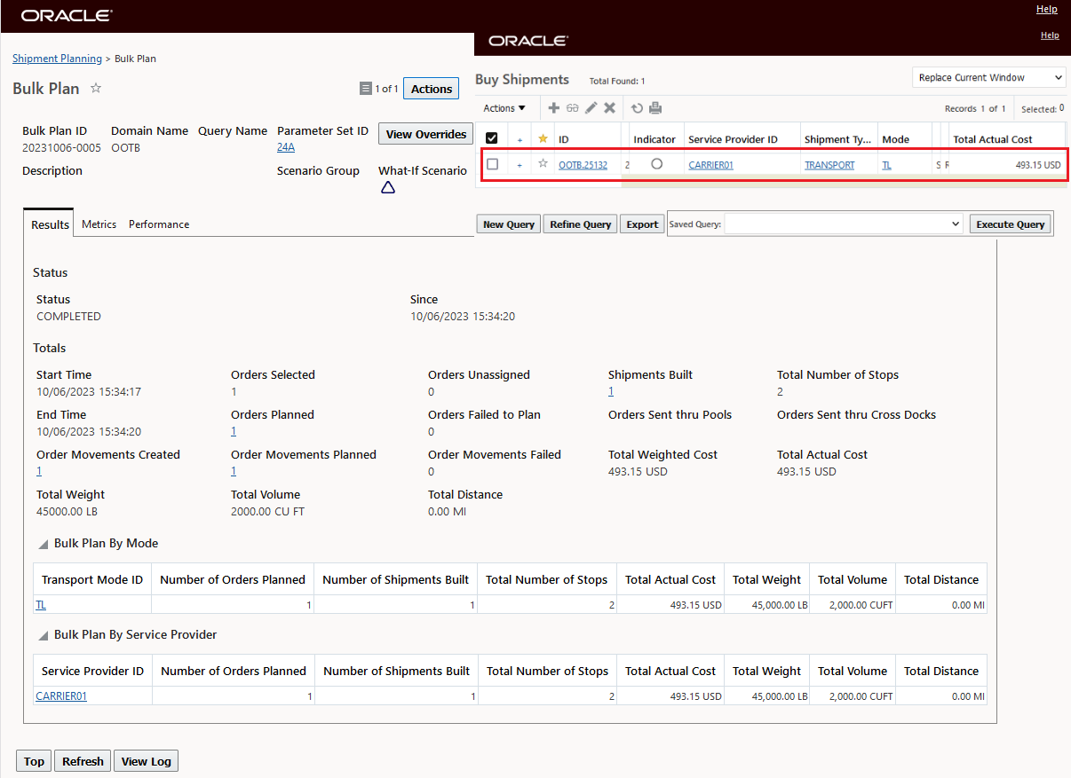

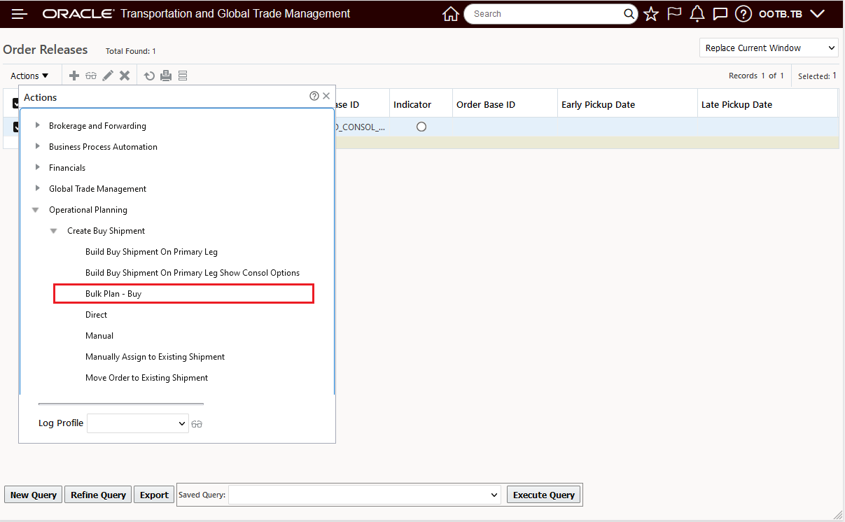

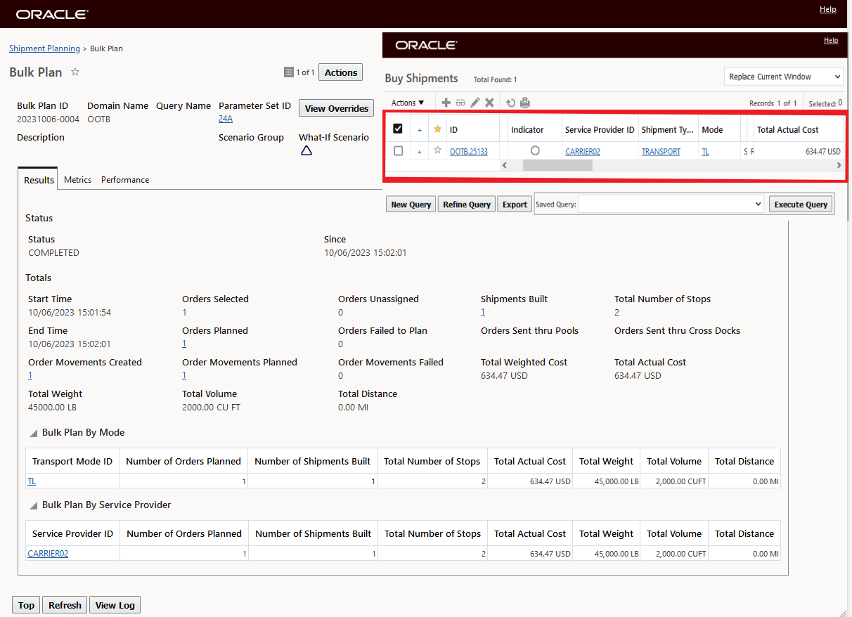

The same setup, with Bulk Planning results in having Order Release assigned to the matching Consol Shipment 25133 - as shown below.
Bulk Plan
Bulk Plan
Below is the Bulk Plan result, the Order Release is assigned to the matching (and more expensive) Consol Shipment for Service Provider Carrier02.
Bulk Plan Result
Bulk Plan Result

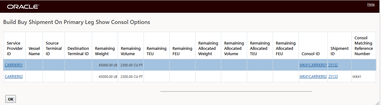

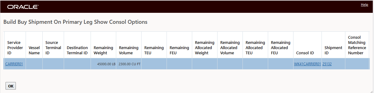

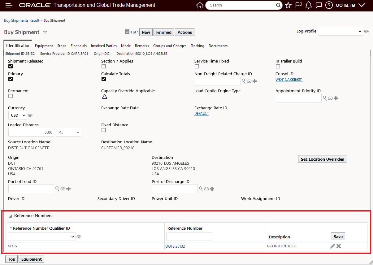

In the scenario below, the Reference Number Qualifier and Value for Consol Shipment 25132 - for Service Provider Carrier01 is removed.  In this setup, both Consol Shipment 25133 with the matching Reference Number Qualifier and Value and Consol Shipment 25132, with no CONSOLSHIPMENT MATCHING REFNUM QUALIFIER specified will be candidate Consols for the Order Release.
Consol Shipment 25132 - Service Provider Carrier01 - No  CONSOLSHIPMENT MATCHING REFNUM QUALIFIER

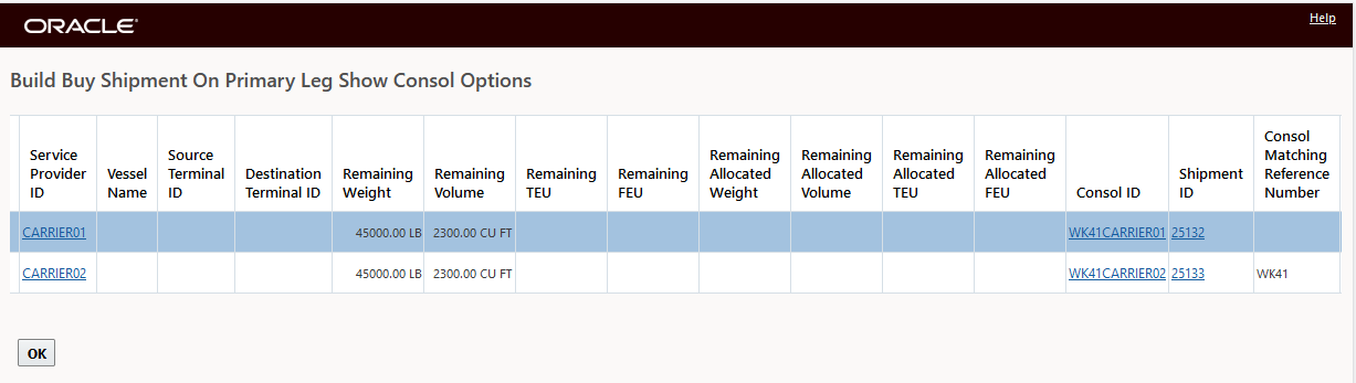

In this setup, both Shipment Consols will be considered - as shown below after running the action Build Buy Shipment On Primary Leg Show Consol Options.
Build Buy Shipment On Primary Leg Show Consol Options - One Shipment Consol With Qualifier Value One Without
The result, as expected, when running Bulk Plan - with both options available results in the selection of the less expensive Consol Shipment option - Consol Shipment 25132 - Service Provider Carrier01 as shown below.

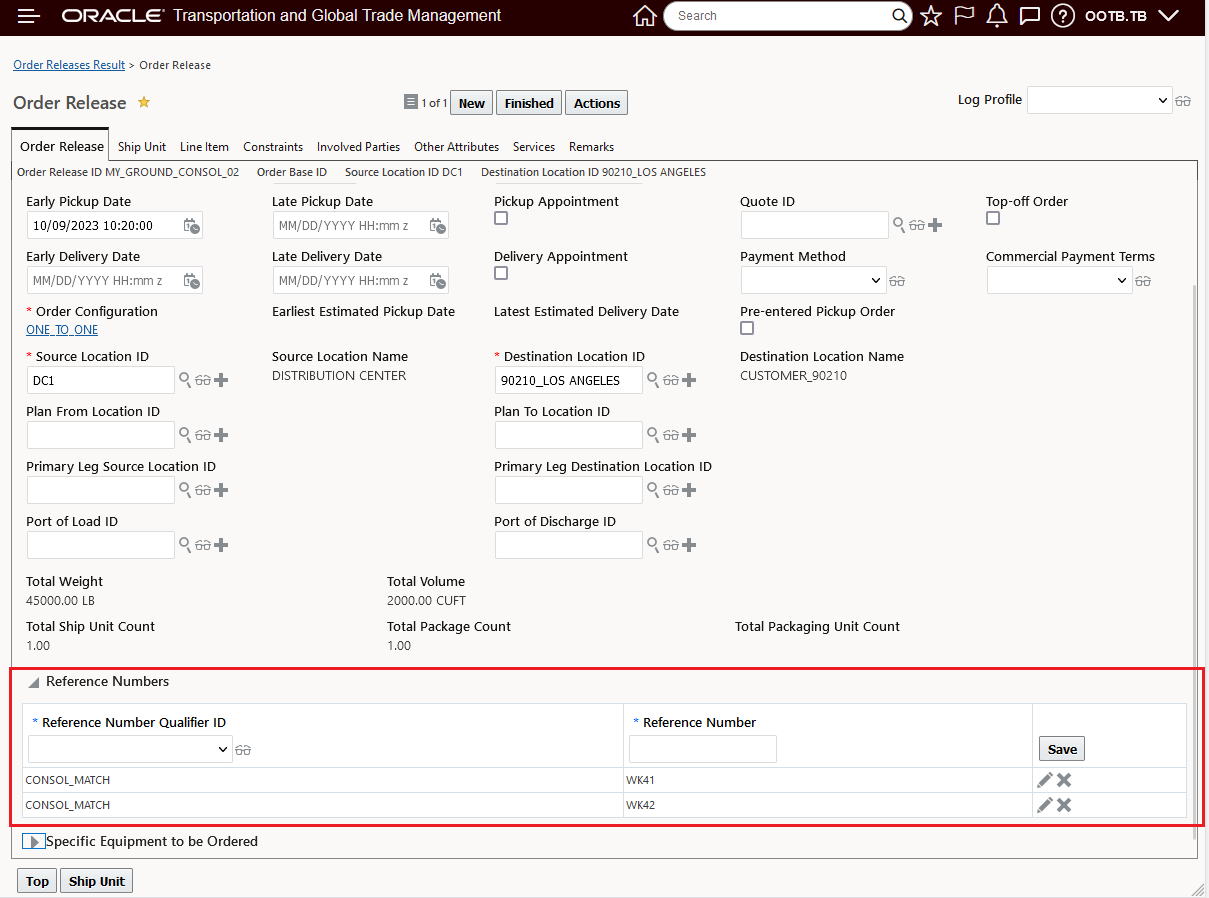

You Order Release can specify multiple options for matching to a Consol Shipment.  In the example below, the Order Release has two options for matching to a Consol Shipment - CONSOL_MATCH WK41 or CONSOL_MATCH WK42.  The Consol Shipment 25132 has been modified to have the Reference Number and Value- CONSOL_MATCH WK42.
Order Release Multiple Match Options
With this setup, running the action Build Buy Shipment On Primary Leg Show Consol Options brings back both options since both Shipment Consol options - for WK41 or WK42 - are a match.
