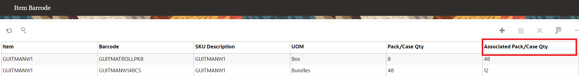

NEW COLUMN "ASSOCIATE PACK/CASE QTY" AVAILABLE IN THE ITEM BARCODE ENTITY
To capture the associated inventory pack_qty on scanning the case_qty and vice versa, we have now introduced a new “associated_pack_case_qty” column to the item barcode entity. This helps you in defining and allocating appropriate package hierarchy for a both Pack/Case barcode.
  • The new Associated Pack/Case Qty column is available on the Item Barcode UI and can be edited in the create, edit, and copy pane. You must explicitly add the column to display on the data grid.
Associated Pack/Case Qty Column
  • A new associated_pack_case_qty column is available in the Item Barcode Interface Entity. You can pass this value in the Stage UI for the item barcode interface entity. This new field supports all the formats for the item barcode interface.
NOTE: The system populates the Associated Pack/Case Qty as '0' if the scanned item barcode is in Units or other than item Case/Pack UOM, or when UOM is Cases and associated_pack_case_qty is > Qty Per UOM, or when UOM is Cases and Qty per UOM is not an integral multiple of associated_pack_case_qty, or when UOM is Packs and associated_pack_case_qty is not an integral multiple of Qty Per UOM.
