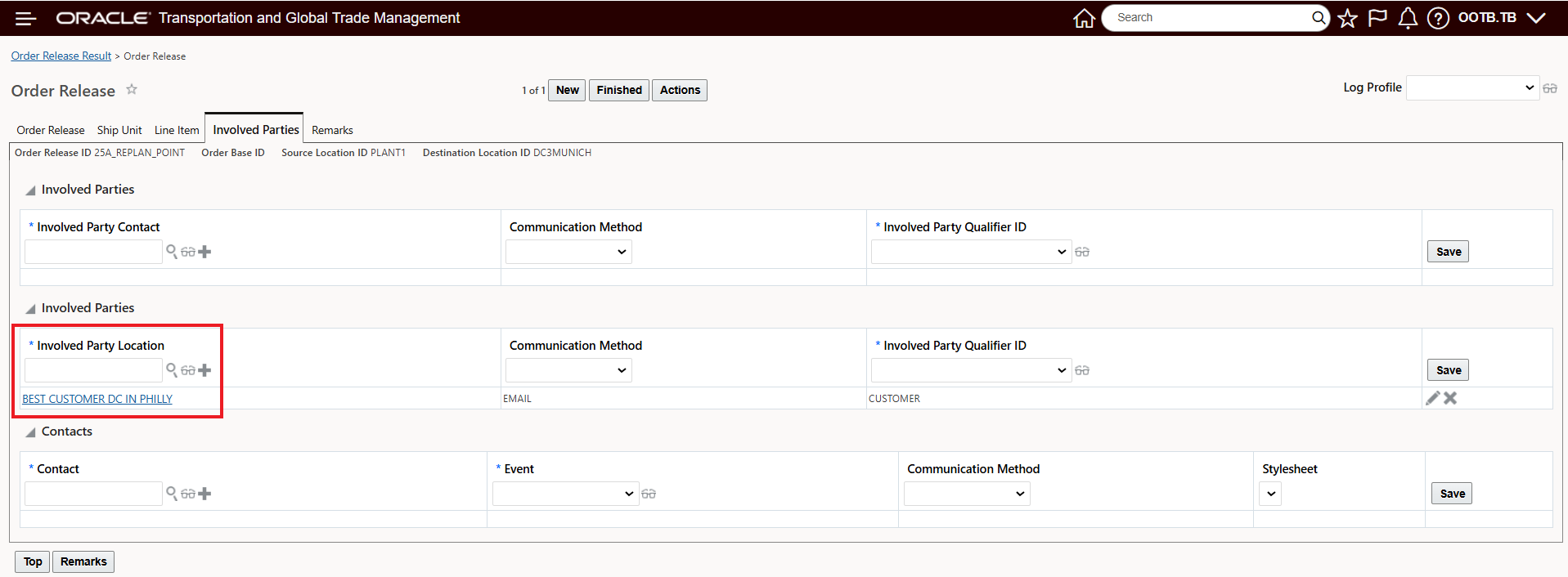

In the example below, the Order Release Manager Layout has been configured to show the Location Name instead of the Location ID.  The Location Name - in this example provides more information about the Location being selected than the Location ID.
Location Name Replaces Location ID

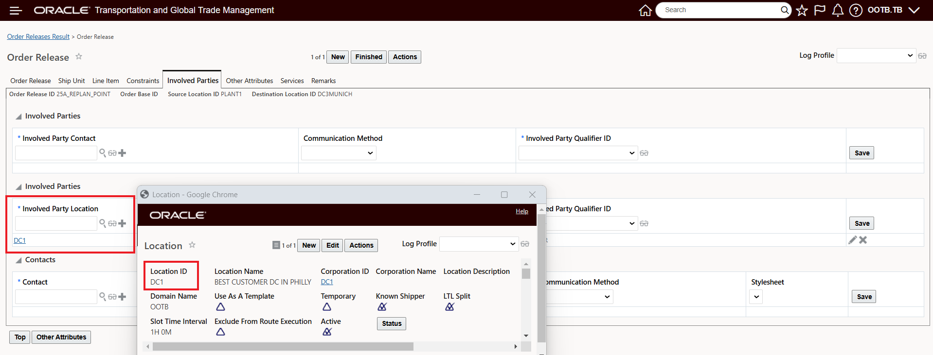

By default, without the Manager Layout changes, the Involved Party Location list and saved value is done only considering the Location ID - as shown below.Location ID Default
Location ID Default

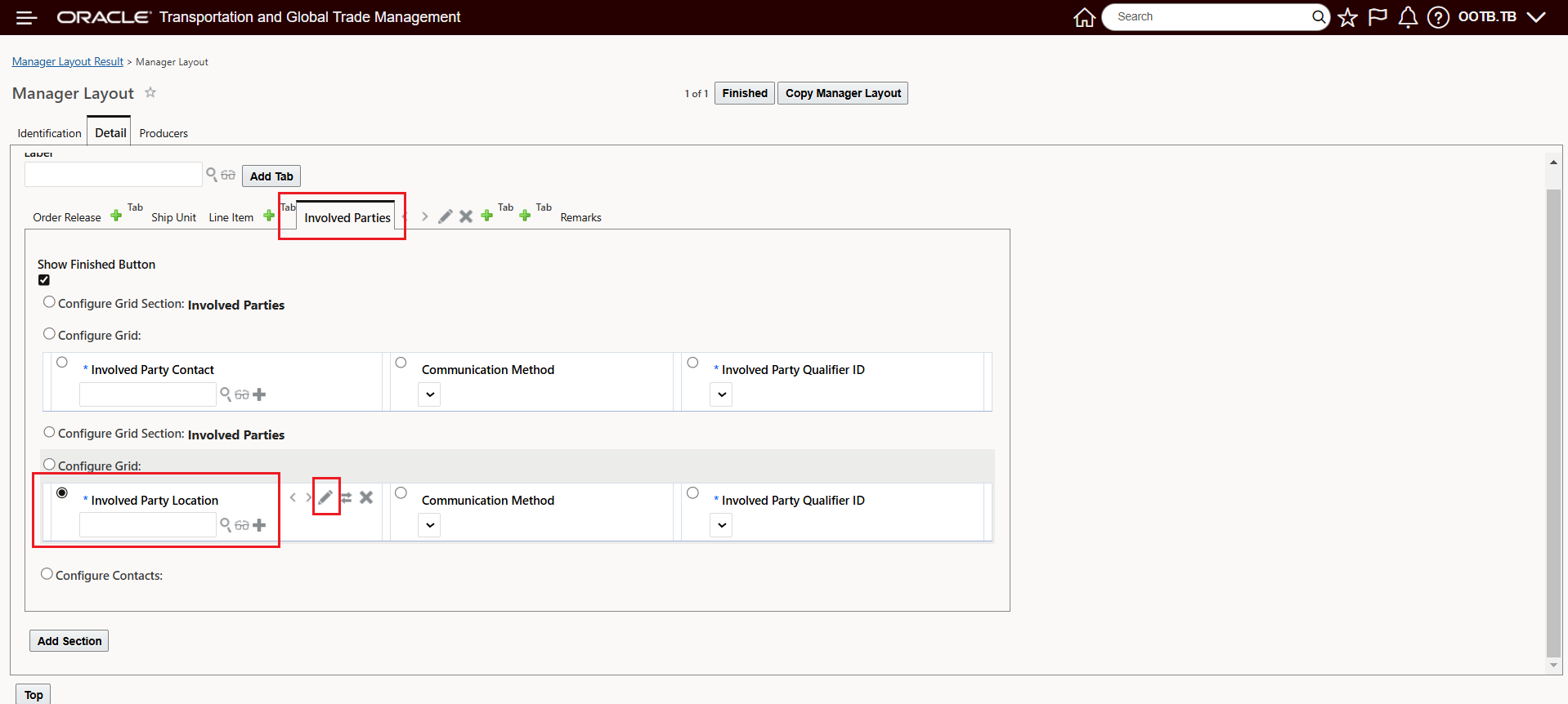

To take advantage of this new feature -you will need to modify your Manager Layout and replace the GID with the Location Name.
Open the Manager Layout you wish to modify. Navigate to the Involved Parties Tab, select the Involved Party Location and then edit as shown below.
Modify The Manager Layout Involved Parties Tab

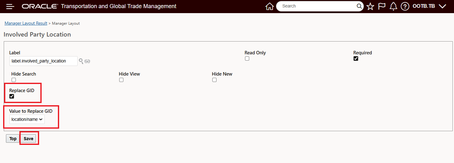

In the edit screen for select the Replace GID option and the Value to Replace GID to location/name (the only option) and select Save - as shown below.
Replace the Location GID with Location Name
With this this Manager Layout Configuration change - the Involved Party Location GID will be replaced with the Location Name.
