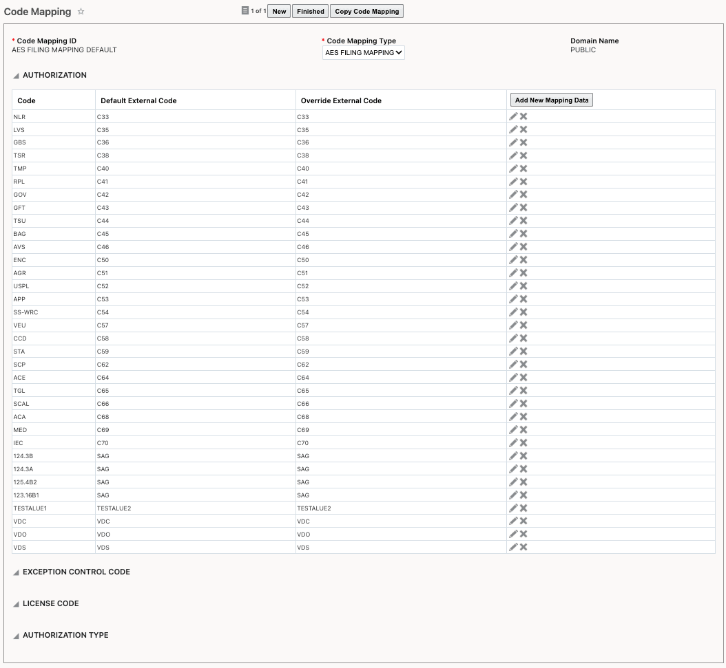

A new Code Mapping UI is available from Master Data > Power Data > Configurations > Code Mappings which is used to map AES license and license exemption type codes with the appropriate external code. The Code Mapping UI has four sections:
- Authorization - provides the mapping when using the Authorization field in the Declaration Line > Control Screening Results section.
- Exception Control Code - provides the mapping when using the Exception Control Code field in the Declaration Line > Control Screening Results section.
- License Code - provides the mapping when using license management and a license is assigned in the Declaration Line > Assigned Licenses section.
- Authorization Type - provides the mapping when using the Authorization Type field in the Declaration Line > Control Screening Results section.
GTM ships with a default code mapping for AES Filing called "AES FILING MAPPING DEFAULT" based on Appendix F. This default code mapping includes mappings for all four sections listed above. In this example, you can see the default code mappings for the Authorization.
Code Mapping UI

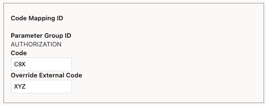

If regulations change and you need to add, remove, or override an existing value, you can copy the "AES FILING MAPPING DEFAULT" code mapping using the Copy Code Mapping action. The copy is an exact replica of the default record which you can then update by adding, modifying, or removing a code.
Copy Mapping - Add New Code
