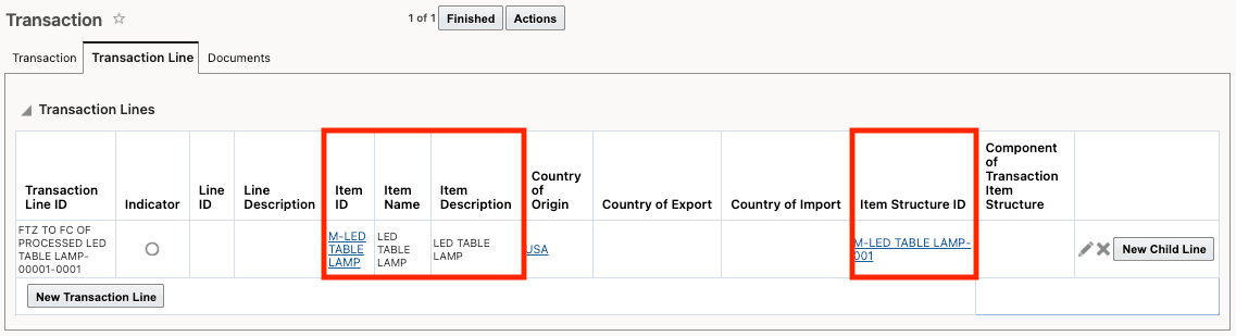

A trade transaction models the finished good, such as a table lamp, with Item ID: M-LED TABLE LAMP and Item Structure ID: M-LED TABLE LAMP-001 — as it is released into free circulation.
Trade Transaction Line - Finished Good
You can then create an exit declaration for the trade transaction. Because each declaration line references its originating trade transaction line via the Reference Lines grid on the declaration line, GTM can utilize the trade item structure from the trade transaction line during reconciliation. When you execute the "Perform Entry/Exit Recording" action to reconcile the exit declaration and lines with inventories, the following occurs:

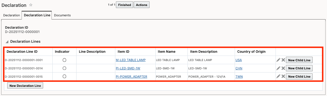

For example, your exit declaration will have three lines:
  • A finished good line for Item ID: M-LED TABLE LAMP
  • A split line for a privileged foreign component with Item ID: PI-LED-SMD-1W
  • A split line for a privileged foreign component with Item ID: PI-POWER_ADAPTER
Declaration Line - Finished Good and Privileged Foreign Lines
After the declaration lines are split, you can perform duty and tax calculations for the finished good.
