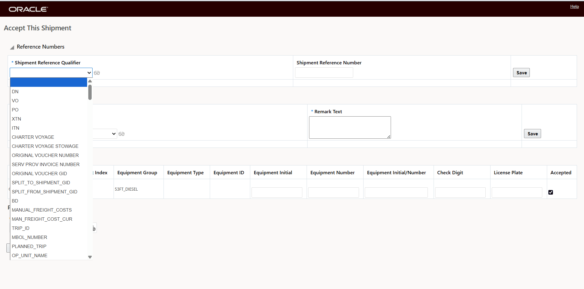

In the example below, the Service Provider is Accepting a Shipment that was created in the OOTB domain.  The Shipment Reference Number Qualifiers and the Remark Qualifiers shown are limited to the Shipment Reference Number Qualifiers and Remark Qualifiers configured in the OOTB and PUBLIC domains.
Shipment Reference Number Qualifiers Available OOTB Domain and PUBLIC

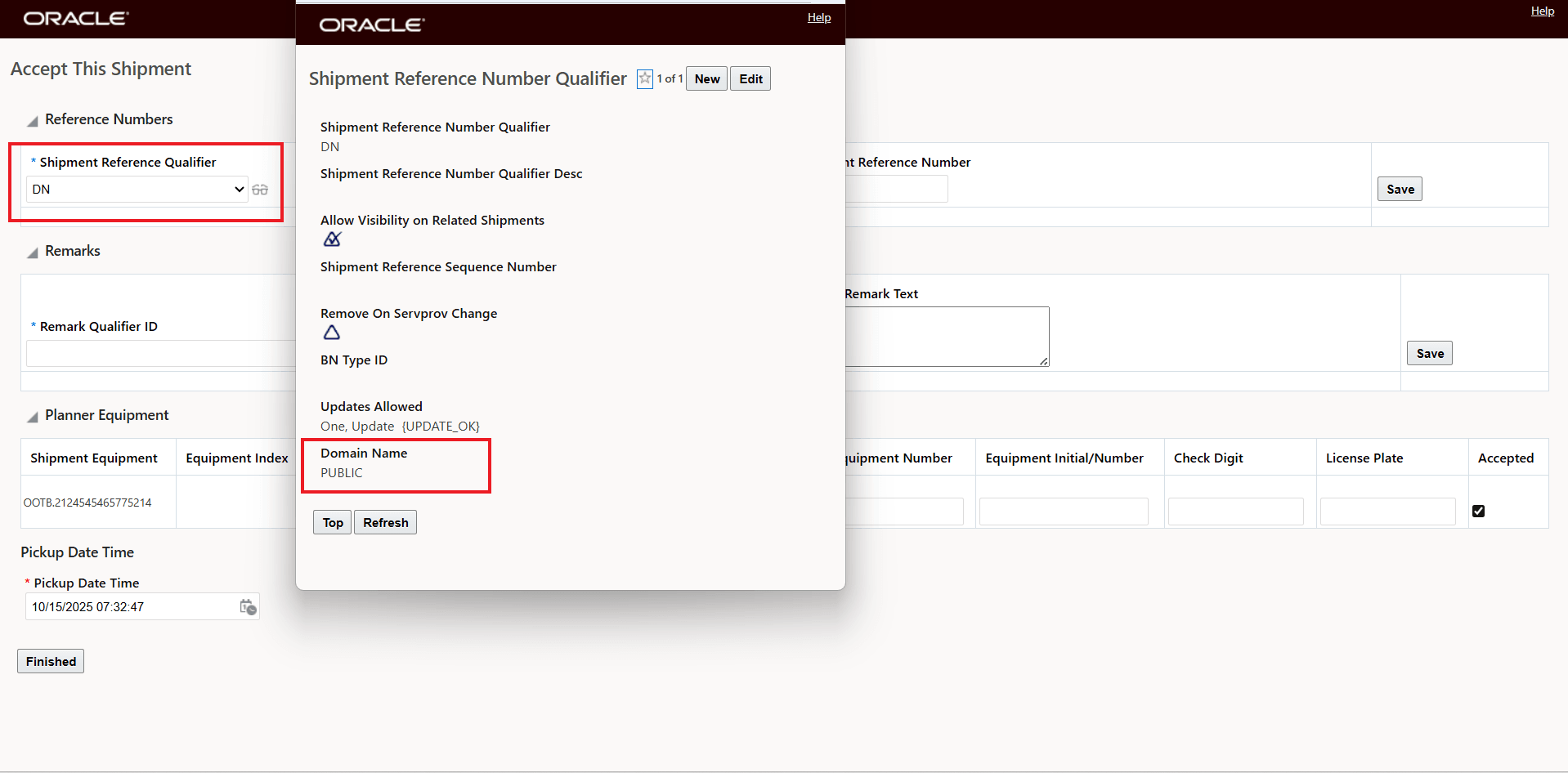

For example, the DN Qualifier - shown below, is a PUBLIC Shipment Reference Number Qualifier.

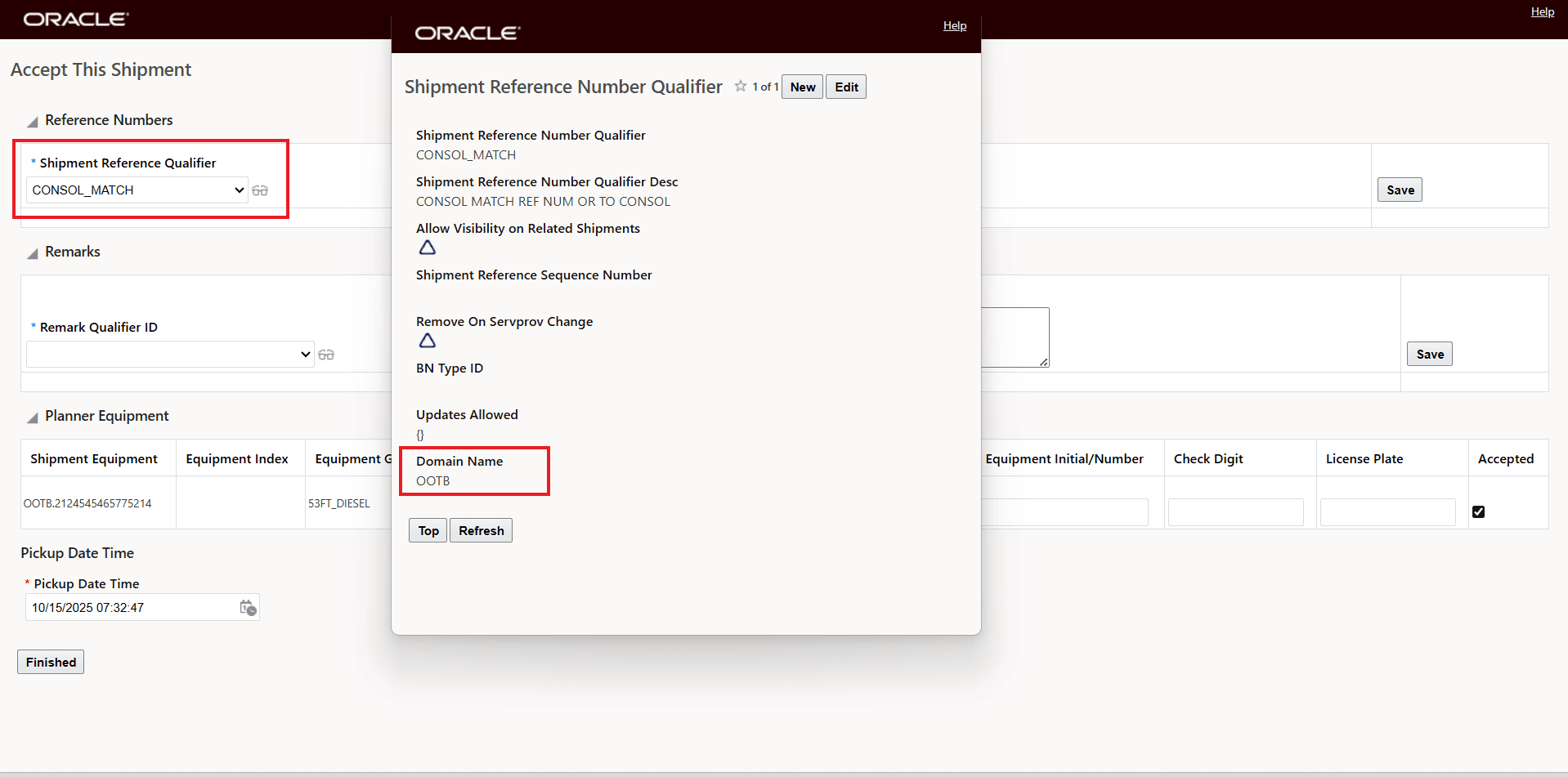

Below is an example of the other possible set of Shipment Reference Qualifiers - the set configured in the Shipment's domain - OOTB.
Domain of Object - OOTB - Shipment Reference Number Qualifier

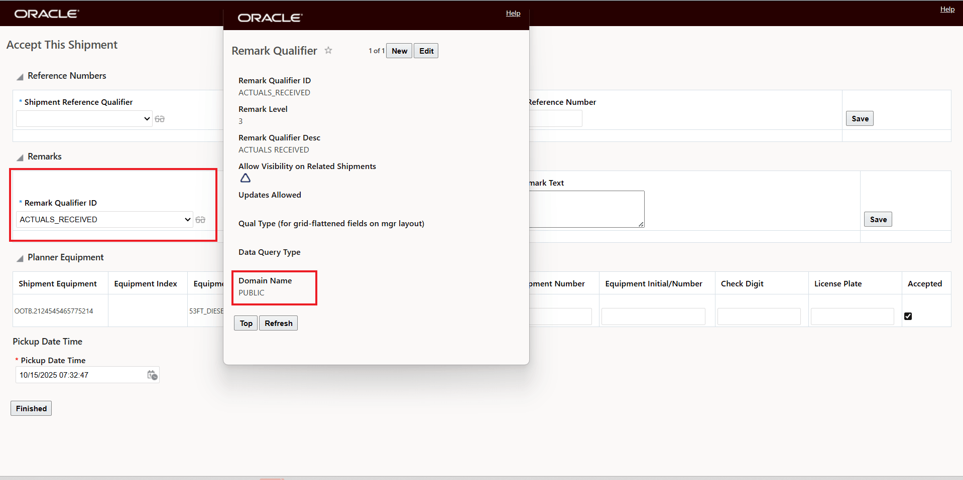

The same holds true for the Shipment Remark Qualifiers.  For example, the ACTUALS_RECEIVED Qualifier shown below is a PUBLIC Shipment Remark Qualifier.

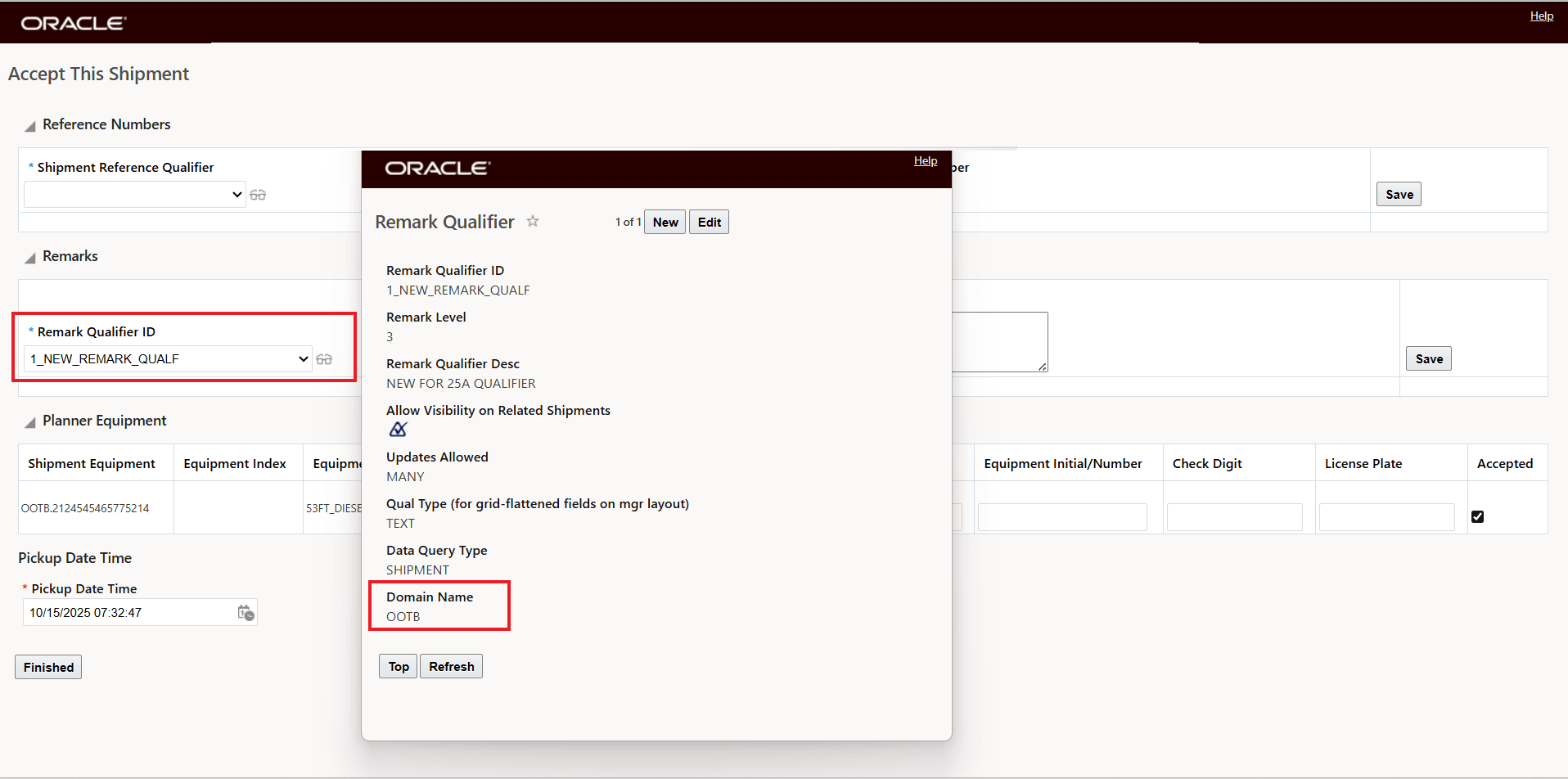

Domain of Object - OOTB - Shipment Remark Qualifier
