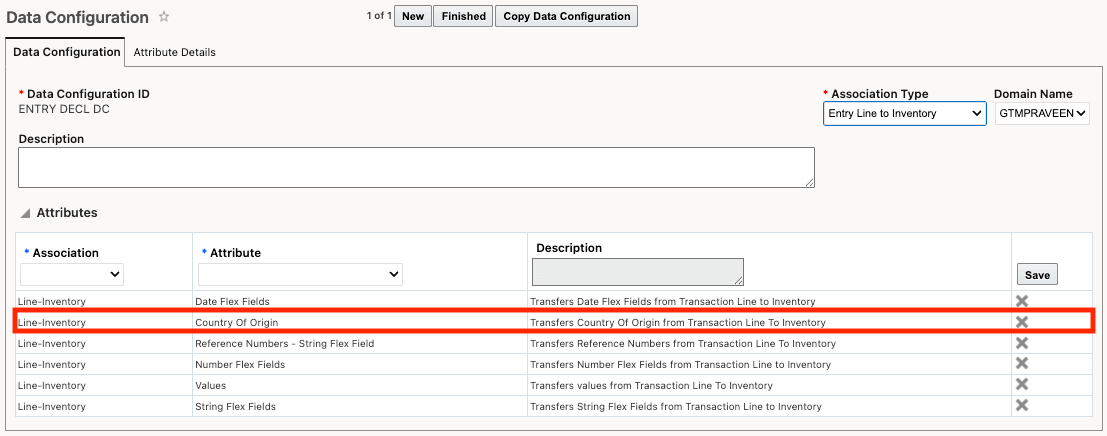

Data Configuration
You can use a data configuration to specify which data to copy from the entry line to the inventory. Select the type "Entry Line to Inventory". For the "Line-Inventory" association, the Country of Origin is now available for selection.
Data Configuration with Assocation Type of Entry Line to Inventory
Data Configuration with Association Type of Entry Line to Inventory

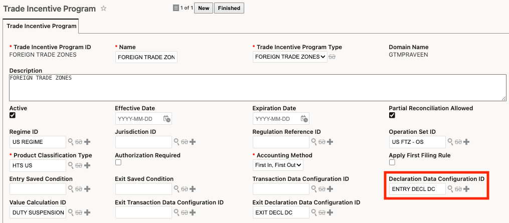

Trade Incentive Program
Once you have set up your data configuration, assign it to your trade incentive program in the Declaration Data Configuration ID field. After it is defined on the trade incentive program, GTM will use the specified data configuration to determine the rules for copying data.

  1. Create a data configuration with a type of "Entry Line to Inventory" with the details of the data you want to copy from the entry declaration/declaration line to the inventory.
  2. Assign the data configuration to the trade incentive program in the "Declaration Data Configuration ID" field.
