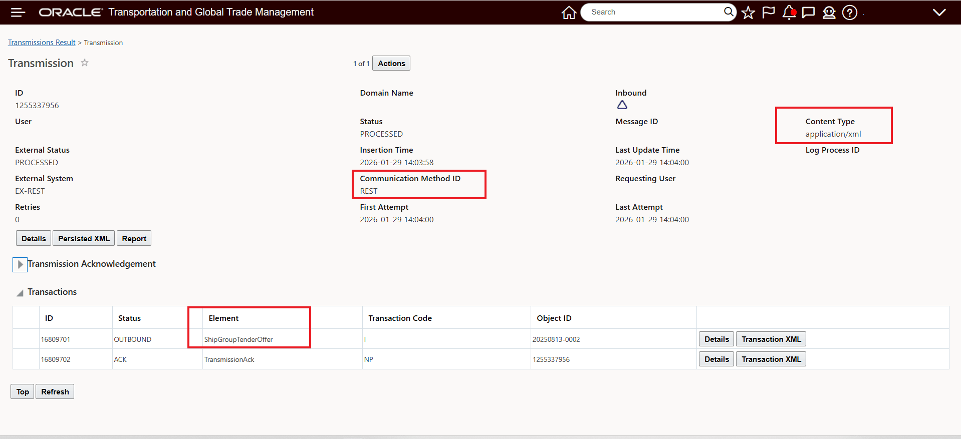

The Transmission below provides an example of a processed Shipment Group Tender where the Communication Method was set to REST, and the Content Type was set to application/xml.  For the Shipment Group XML, this setup was not supported previously.
Shipment Group Tender Transmission Example

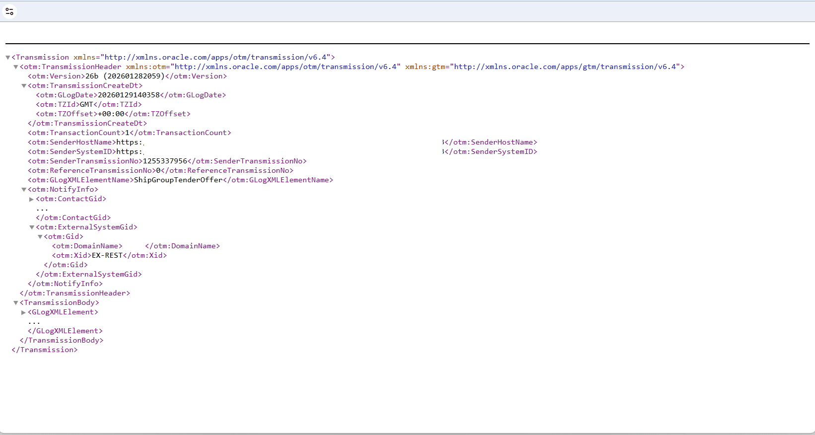

Below is the Persisted XML from the above Transmission.
Transmission Persisted XML
