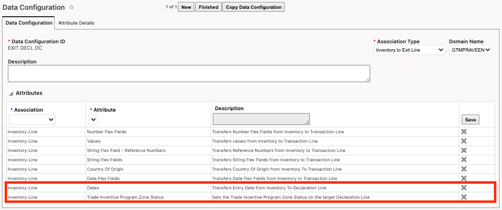

Data Configuration
The data configuration defines which information is copied between objects. For the association type Inventory to Exit Line, the following new attributes are available:
  • Dates: Enables you to copy dates, including the entry date, from the inventory to the exit line.
  • Trade Incentive Program Zone Status: Enables you to copy the zone status from the inventory to the exit line.
Data Configuration with Association Type of Inventory to Exit Line

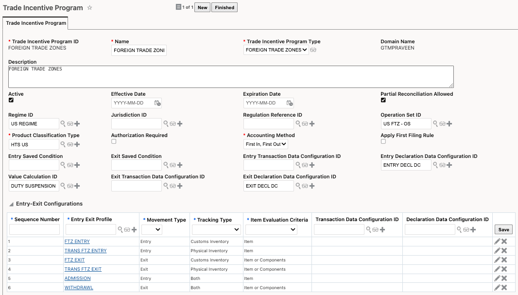

Once you’ve defined the data configuration, assign it to your trade incentive program. You can assign the data configuration either at the header level or within the Entry-Exit Configurations section.
Trade Incentive Program with Exit Data Configuration
