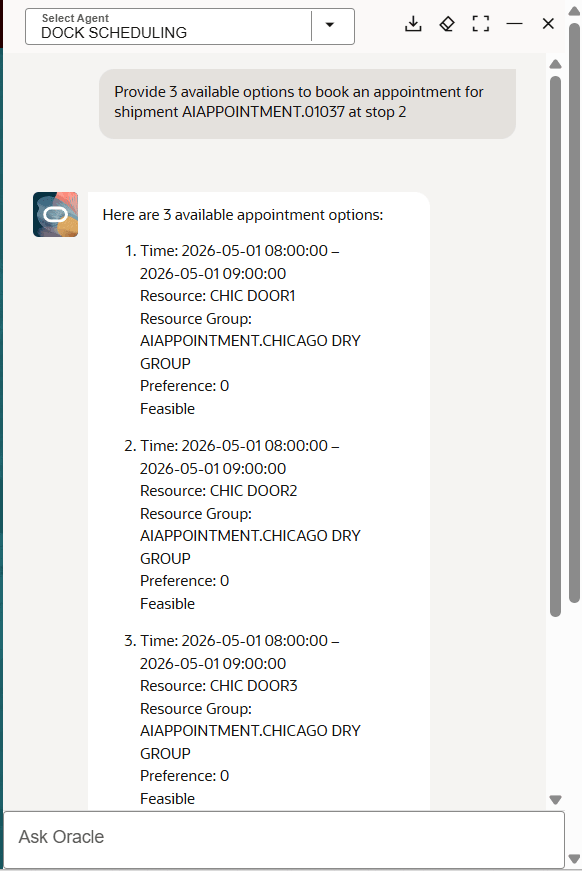

Get Appointment Options
  • Get up to 10 available appointments for shipment DEMO100 at location BOULDER DC
    • If multiple stops at this location, agent will ask which stop to use, use stop 1 or 2
  • Get the first available appointments for shipment ID DEMO100 at BOULDER DC
    • If multiple stops at this location, agent should ask which stop to use, use stop 1 or 2
  • What are my appointment options for DEMO100 at BOULDER DC?
  • Show me 5 available appointments for shipment DEMO100 at the first stop
  • Get 4 available appointments for shipment DEMO100 at the second stop
  • Show me my appointments options for DEMO200
    • This agent should ask which stop. Reply with first stop.

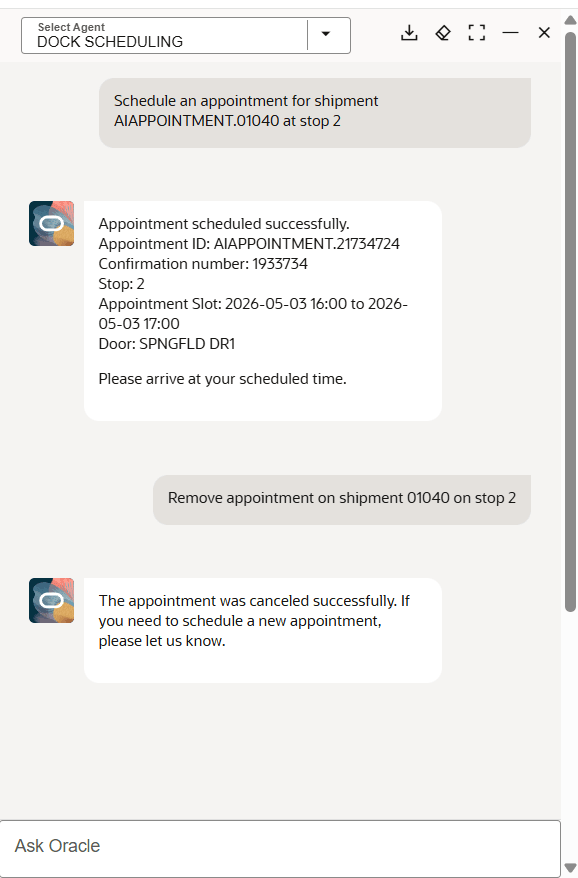

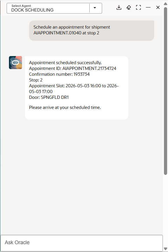

Schedule An Appointment
  • Schedule a dock appointment for shipment DEMO100 at BOULDER DC
  • If multiple stops at this location, agent will ask which stop to use, should use stop 1 or stop 2.
  • Schedule a dock appointment for shipment DEMO200
    • The agent should ask which stop. Reply with first stop.
Schedule Appointment

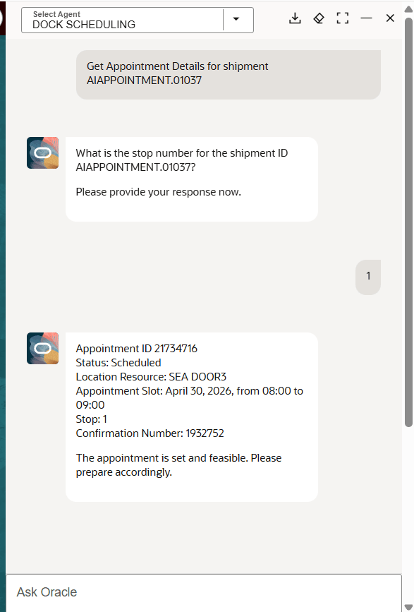

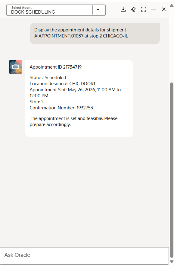

Get Appointment Details
  • What are the details for the shipment DEMO200?
  • Show me the appointment for DEMO100 at stop 1

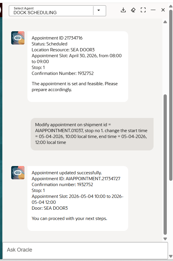

Reschedule An Appointment
  • Reschedule the dock appointment for shipment DEMO100 at BOULDER DC for April 14th, 2026 at 12:30am to 1:45pm
    • Agent will ask which stop to use, use stop 1 or 2
In this example the current appointment details are provided - below.
Reschedule Appointment Current Details
Reschedule Appointment - Current Details
Then the appointment is rescheduled - below.
Reschedule Appointment - New Date And Time Range
Cancel An Appointment
  • Cancel the appointment for shipment DEMO100 at BOULDER DC
  • Cancel the appointment for shipment DEMO100 at the first stop
Cancel Appointment
Cancel Appointment

  • Appointment modifications require specific start and end times.
  • When rescheduling, the system cancels the existing appointment and creates a new one, which may result in a different appointment identifier.
