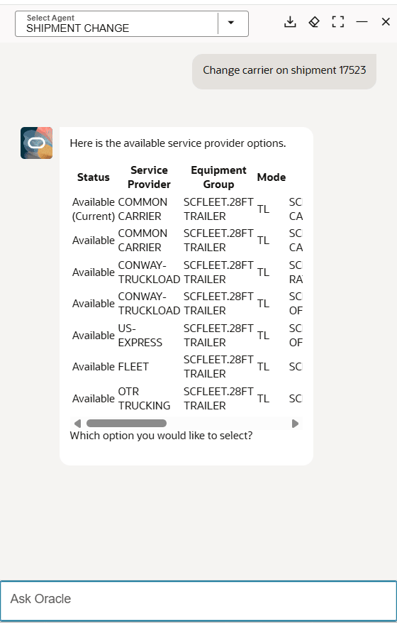

In the example below, the Shipment Change Agent is used to perform the Change Service Provider action. The request to Change Carrier for Shipment 17523 (you can provide the shipment GID or shipment XID) with the list of service provider options provided by the agent are shown below.
Shipment Change - Change Service Provider Input

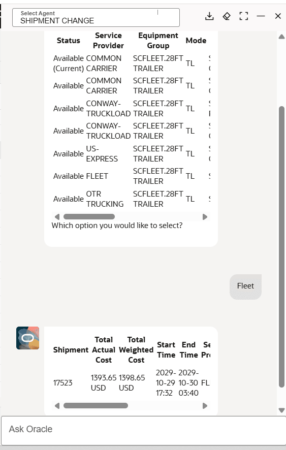

Then to complete the Change Service Provider action, a selection is provided - in this case FEET.
Shipment Change - Change Service Provider Selection

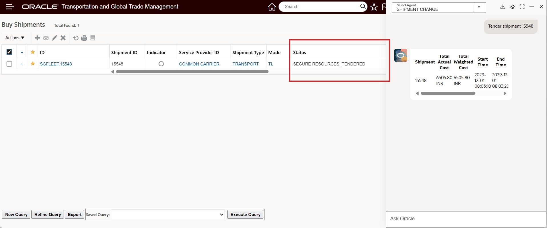

Then with the simple request to "Tender shipment 15548" the shipment is tendered to the assigned service provider - as shown below.  You can also use the agent to Approve for Execution and Secure Resources.

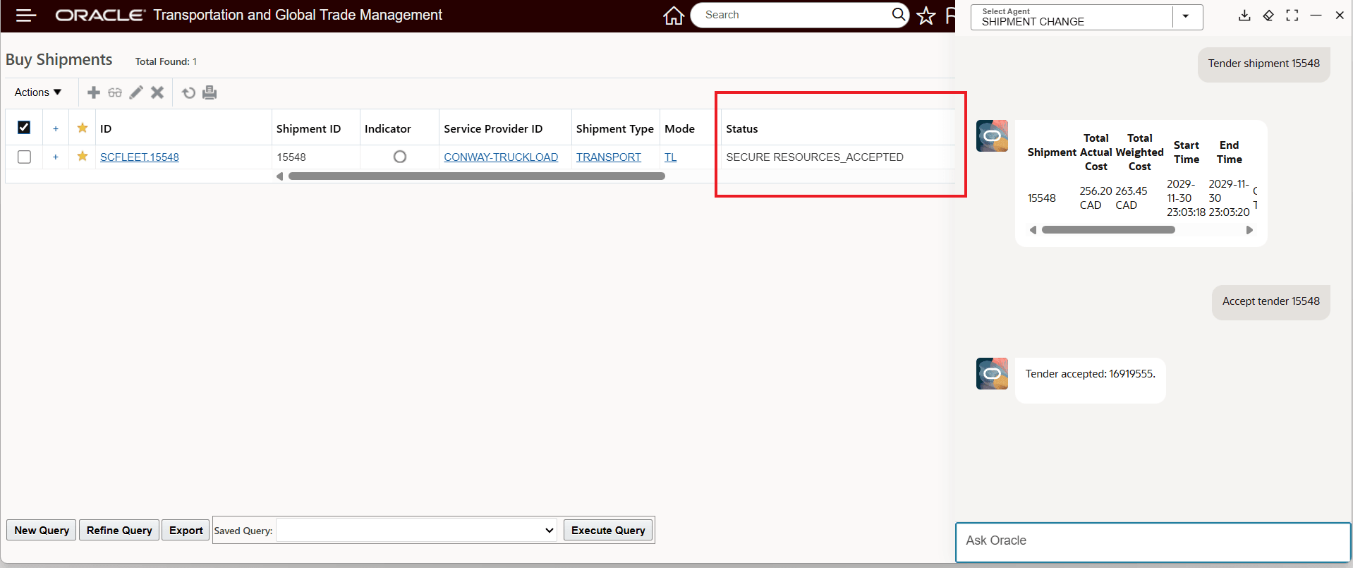

Accept Tender
In the example below, the shipment is tendered and accepted.
Shipment Change - Tender Shipment and Accept Tender

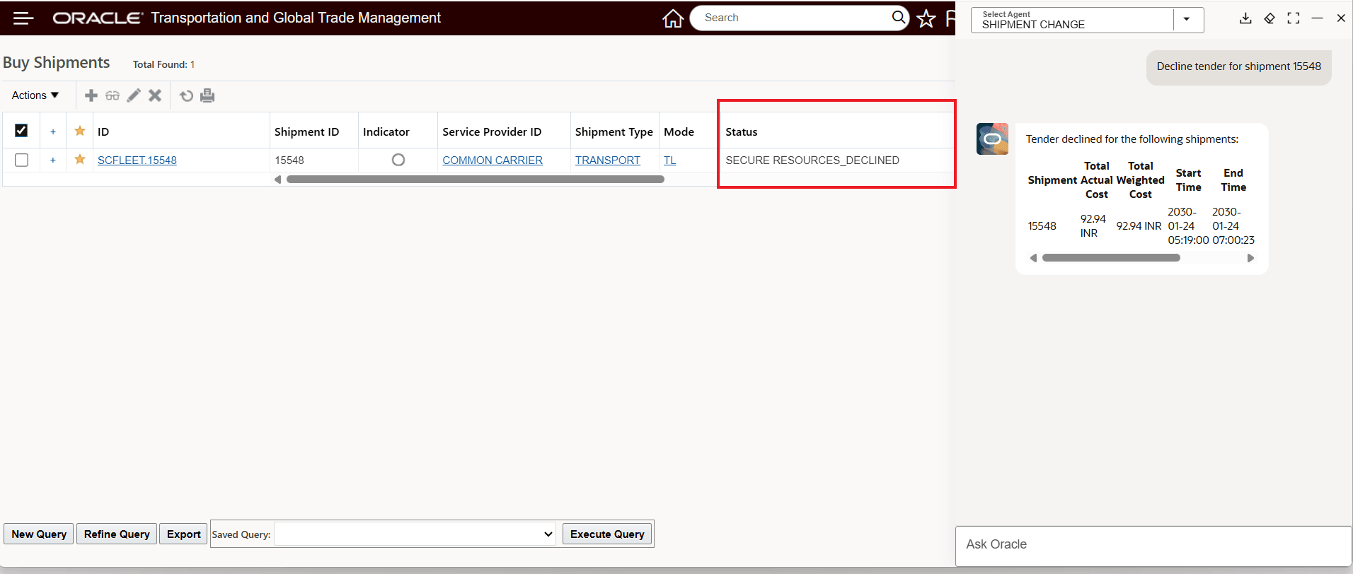

In the example below, the request is a straightforward decline tender for shipment 15548 - in this case the shipment is not retendered, and no decline reason code is provided.
Shipment Change - Decline Tender

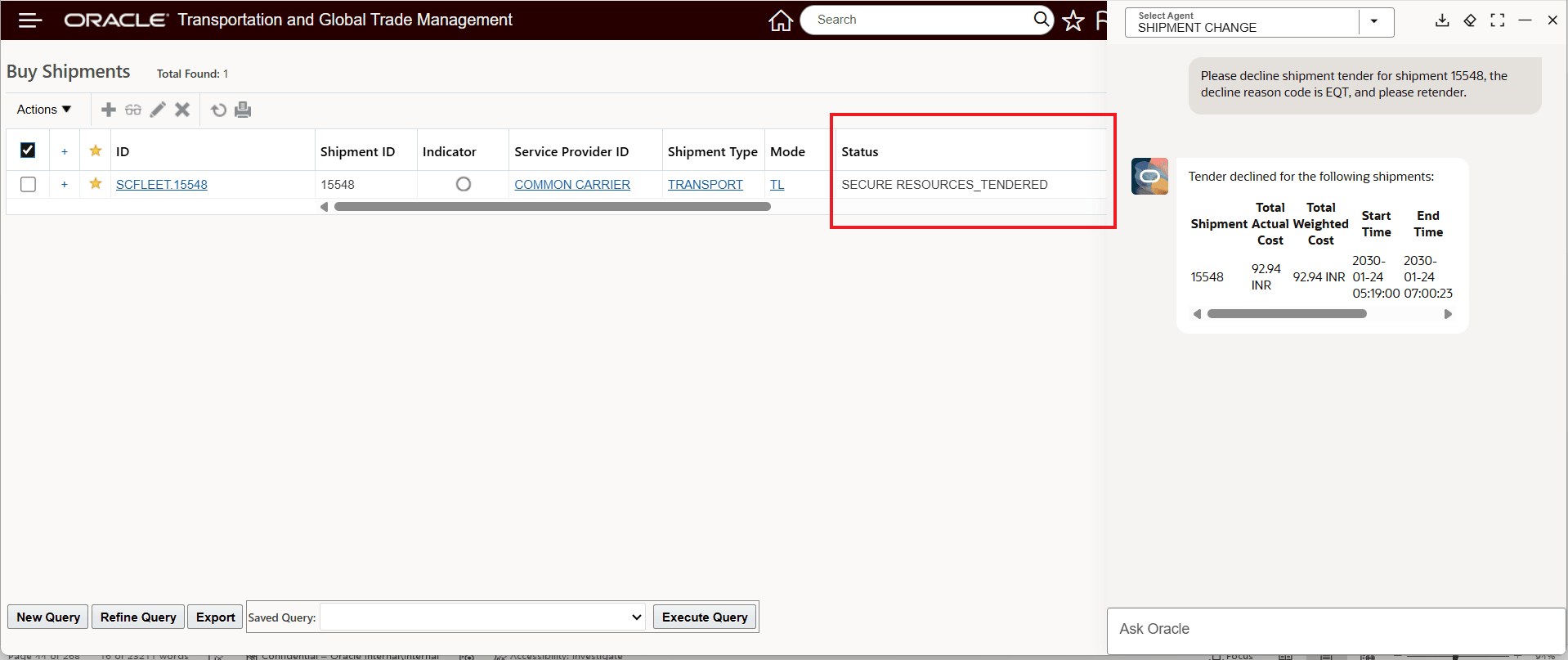

In the example below, the decline tender is provided to the agent along with the decline reason code and the request to retender the shipment after the decline.  In this case the decline is for service provider Common Carrier.
Shipment Change - Decline Tender With Reason Code And Retender
Once the agent runs, the shipment is declined for the original service provider and retendered to US-Express - as shown below.
Shipment Change - Decline Tender With Reason Code And Retender Result

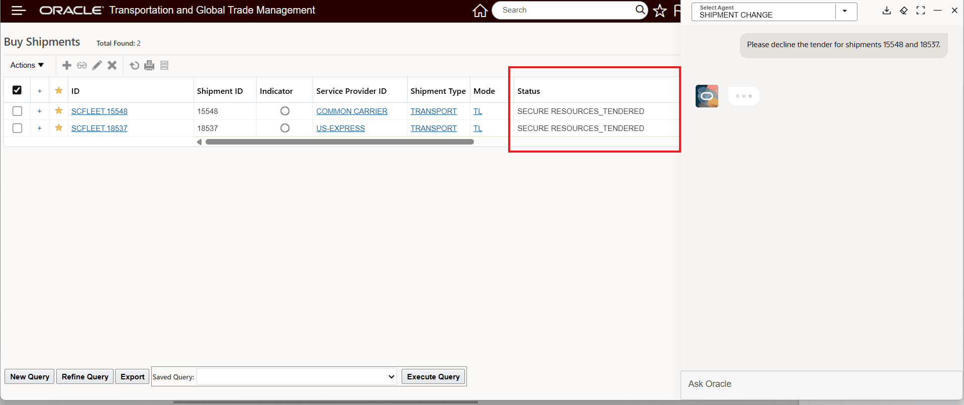

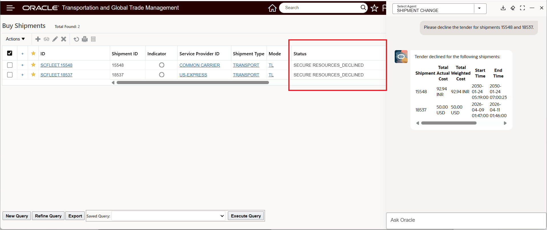

In the example below, the agent will handle the decline request for multiple shipments - 15548 and 18537.
Shipment Change - Decline Request For Multiple Shipments
When the agent has completed the decline request - a confirmation is provided for all the shipments successfully declined, as shown below.
Shipment Change - Decline Tender For Multiple Shipments Result
