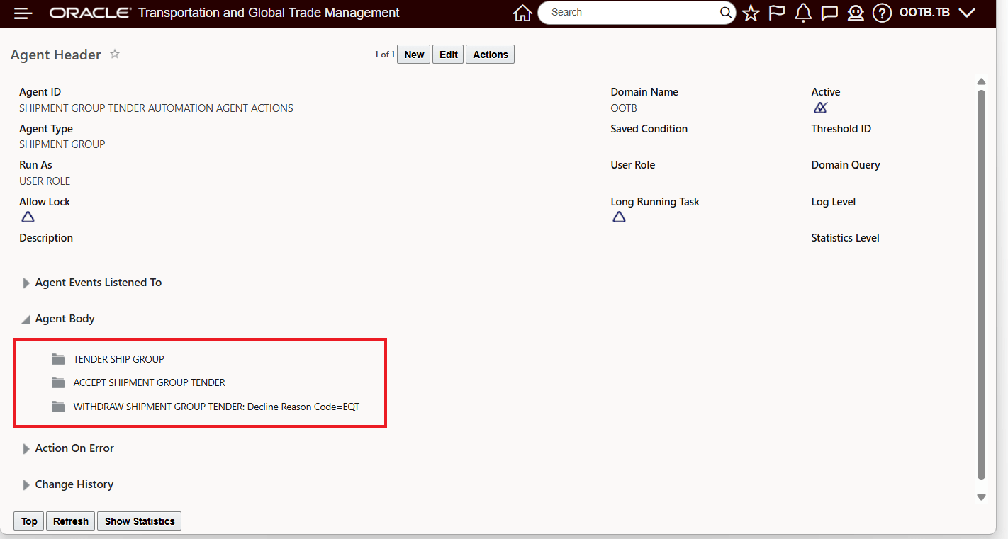

To take advantage of the Shipment Group tender related Agent Actions, you will need to add or update an existing Shipment Group Agent Type automation agent  to use the new Shipment Group tender agent actions:
  • TENDER SHIP GROUP
  • ACCEPT SHIPMENT GROUP TENDER
  • WITHDRAW SHIPMENT GROUP TENDER
    • Optionally configure Decline Reason Code handling for your withdrawal scenarios as needed by your business process.
Shipment Group Tender Agent Actions
