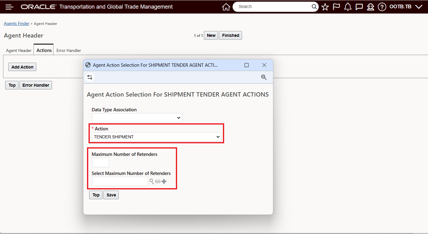

  • TENDER SHIPMENT
    • Parameters:
      • Maximum Number of Retenders - Number of retenders allowed, this field value takes precedence over the saved query for maximum number of retenders.
      • Select Maximum Number of Retenders - This saved query must return an integer value. If the maximum number of retenders value is blank, OTM considers the value in the saved query.
      •  If both the parameter values are blank, OTM considers the MAX_NUM_RETENDERS workflow parameter.
Agent Action Tender Shipment
Agent Action - Tender Shipment

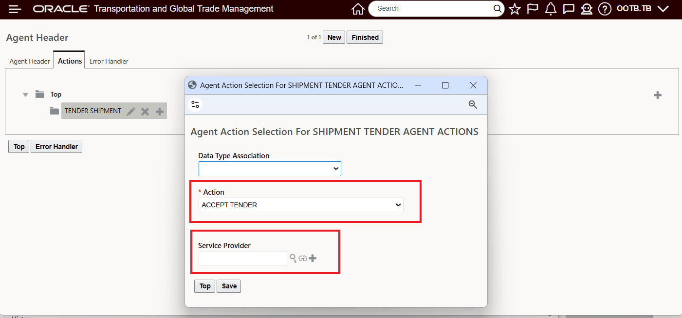

  • ACCEPT TENDER
    • Parameter:
      • Service Provider: The Service Provider on whose behalf the agent action is accepting the tender.
Agent Action - Accept Tender

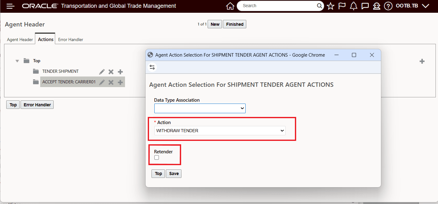

  • WITHDRAW TENDER
    • Parameter:
      • Retender: Select the checkbox to re-tender the shipment to the next compatible service provider.
Agent Action - Withdraw Tender
