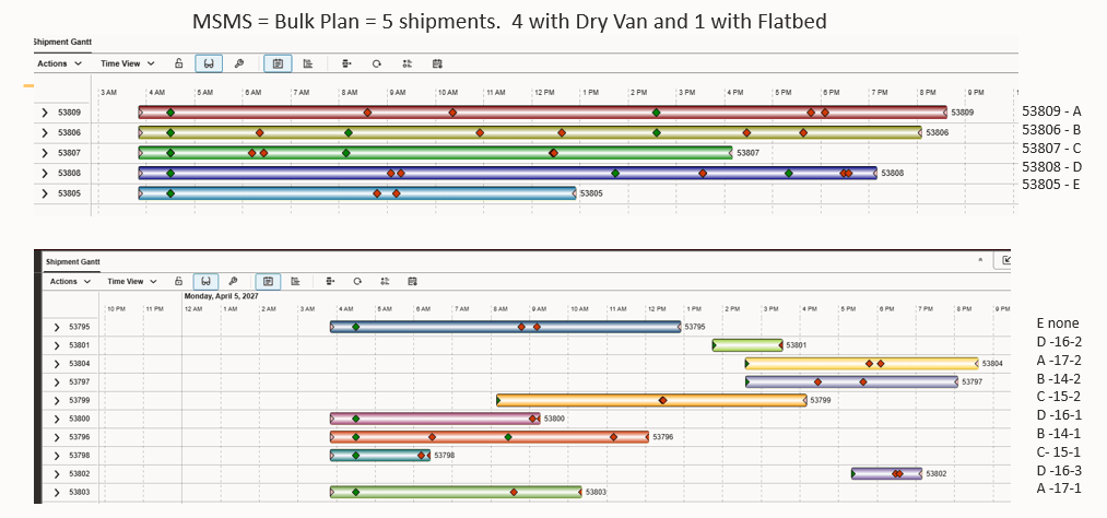

The upper Gantt Chart shows the MSMS shipments as they represent the work that each asset is planned to do for the duration of a day. The lower Gantt Chart shows the shipments that have been split apart of broken up. It is not organized by Tour and Segment yet as that is planned work. The gaps between the segments represent the time between the segments. A future enhancement will add NFR stops for the continuity. The labels on the right are not part of the UI but are there to show the Tour and Sequence.

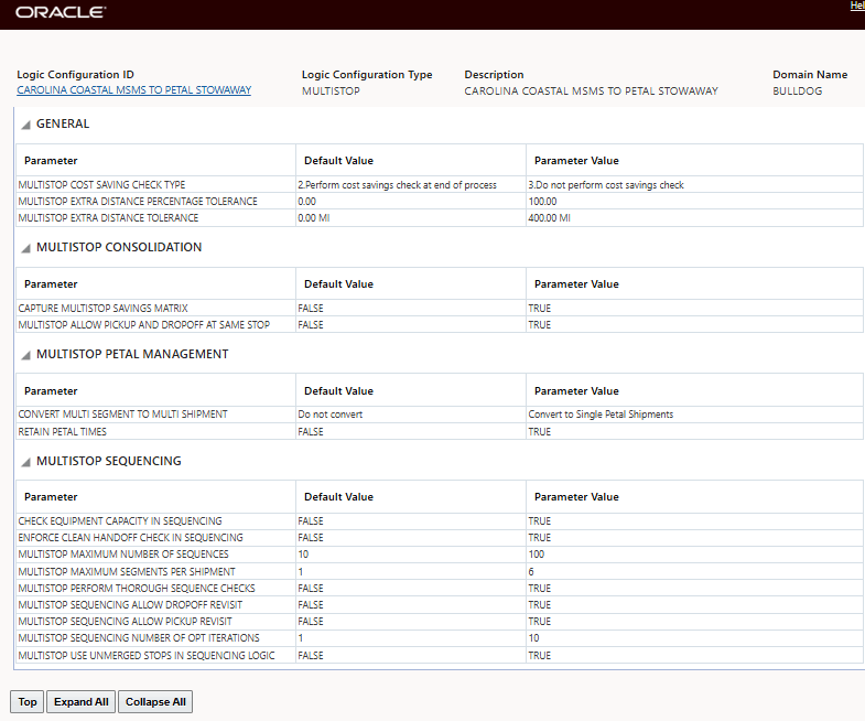

The Multi-stop Configuration must be configured to use the enhancement. It is recommended that the ENFORCE CLEAN HANDOFF CHECK IN SEQUENCING is also TRUE.
