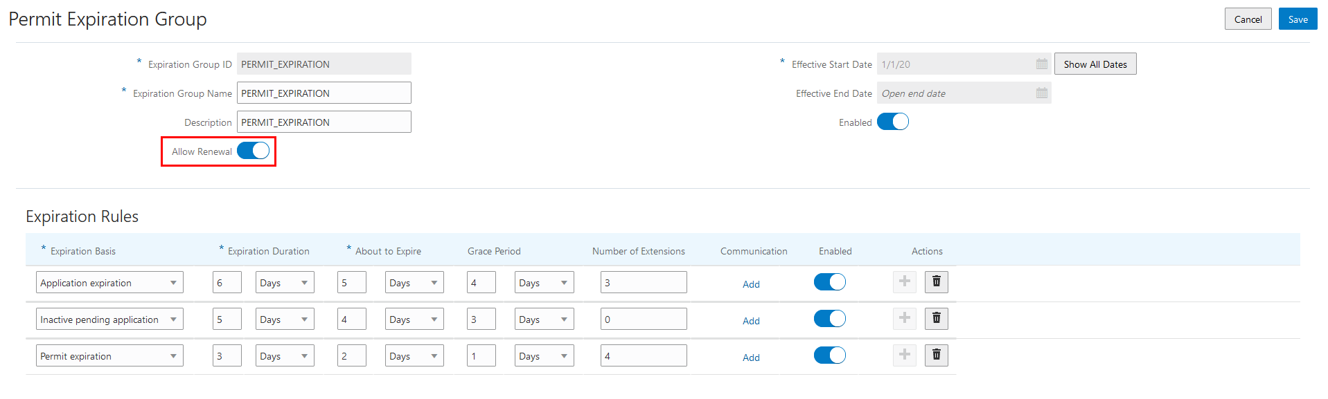

Permit Expiration Group Page

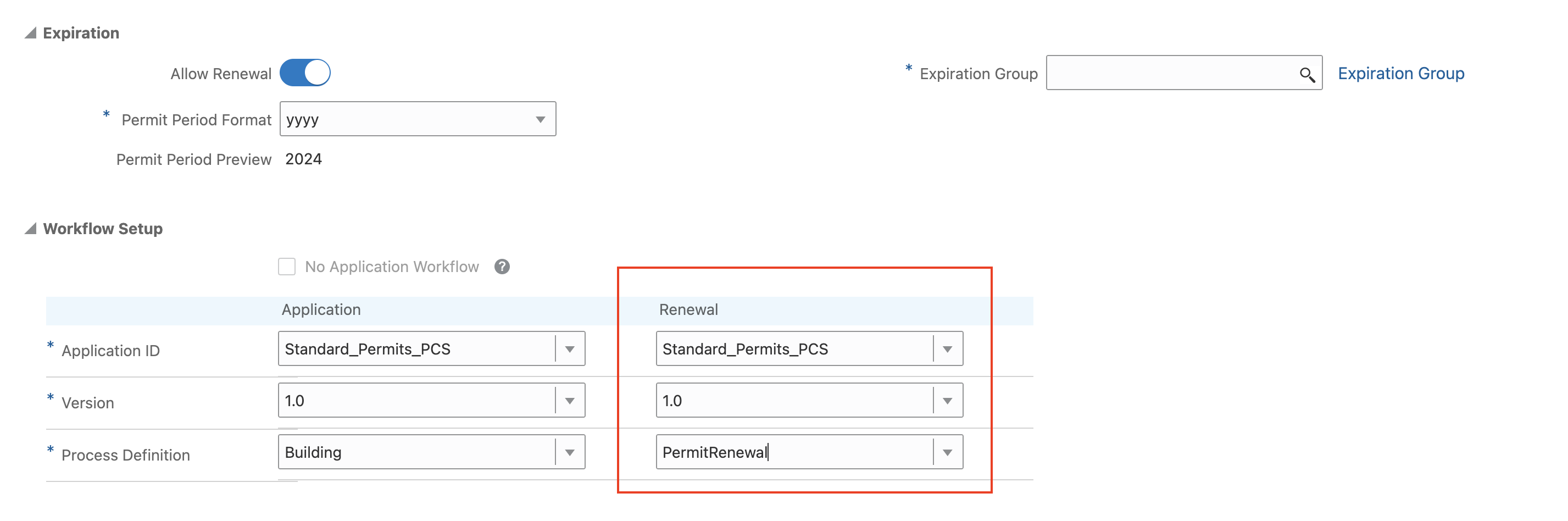

Permit Type Setup Page

Steps to Enable and Configure
To enable this feature, complete the following steps:
- Navigate to Permit Setup > Permit Expiration Group.
- Click the add button to add a renewal expiration group.
- In the renewal expiration group, enable the Allow Renewal switch.
- Navigate to Permit Setup > Permit Type.
- Click on the permit type you want to enable.
- Open the permit type, and under the Expiration section, enable the Allow Renewal switch.
- Enter the Permit Period format.
- For the Expiration Group, select the Expiration Group you enabled previously.
- For Workflow Setup, configure your renewal workflow as desired.

For renewable permits, workflow should be configured to allow inspections to occur before permit issuance (for example: Submitted, Accepted, Inspections, Permit issuance and Completed). This is different than the regular building permits where Inspection is configured after permit issuance in the workflow.
- This is applicable to both Application and Renewal workflows configured in the Permit Type setup page for renewable permits.
